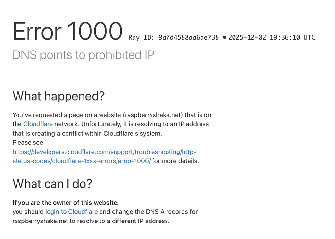

Hi folks. Apparently coincident with your pushing out the ‘great’ new RS control center, your wiz-bang s/w has utterly hosed our ability to access our device, node 71B here in Colombia.
Wrecked us completely.
For years now we’ve accessed it’s simple interface – until this s/w push you made on ur own – by accessing the LAN IP address, which, as the RS.local/ for whatever reason never resolved to our device in or LAN, we’d nailed the address to it’s MAC, and it simply always worked.
Now, we hang in space. Dead in the water.
Attempts to view data on Stationnet give obnoxious cloud flare screens like:
Simple (read EASY) suggestions to return our RS to a state that we can actually view/inspect data again
Thanks.
  • h
hi yeatesh,
no, your system’s not hosed, sorry your impression is otherwise. that URL you are requesting is not alive, and hasn’t been for many years. rather, if you want to be seeing your data, you should use use this address:
Station View: Raspberry Shake Network & EQ Activity Map
and, you can also see on this page that, after this update, 2740 shakes continue to stream their data just fine; this is, in fact, an all-time high!
as for the missing front-end display, there is a known issue involving a race condition with DNS services that will be addressed in a patch release to be issued within a week’s time; this is the likely source of your problem, also likely fixable with a simple command you can run on the Shake itself, if you’re so inclined:
  1. log in to the shake using ssh
  2. once logged in, issue the following command:
    > sudo systemctl restart rsh-fe-config
  3. the method you previously used to access the front-end, specifying the LAN IP, continues to work fine, nothing there was changed
warm regards,
