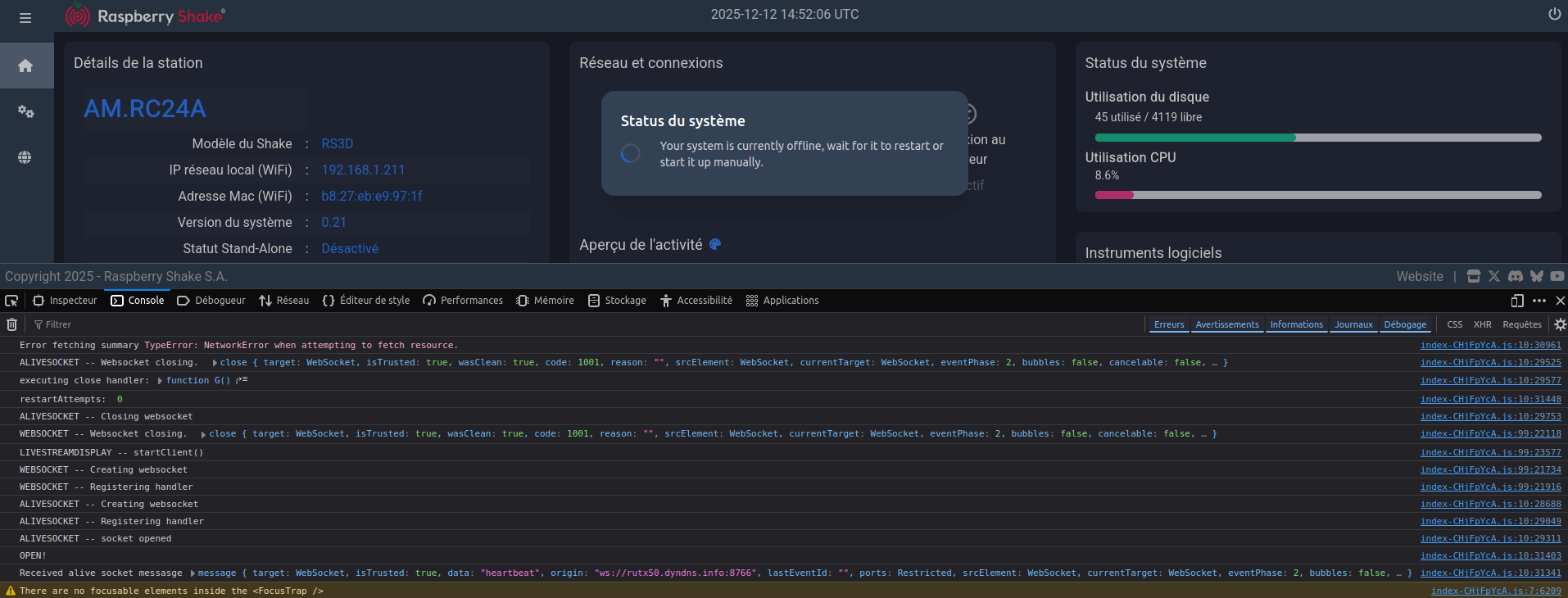

Well, with the inspector I saw an error about ports 8765 & 8766 request, ans so I add a port forward to alloy every request on port 8765 and 8766 straight to the shake. Then the error seen in inspector disappear, but the message still.
Here a screen of the console :
I’m not skill enough to interpret this, maybe you can.
If I’m stay on the page, this console messages repeat each 10 sec approx.
Note : adding the last port forward result in the fail of focusing the error message “Your system is currently offline, …”, as you can see in the last log. Don’t know if it’s important, but just in case.
