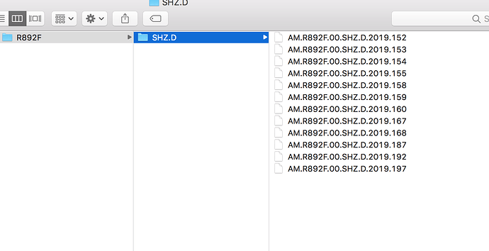

I m sorry but how do I access that?
How did you send this screenshot? Please send one of entire director :slight_smile:
branden
aha. here you go:
and her come all the files if needed:
