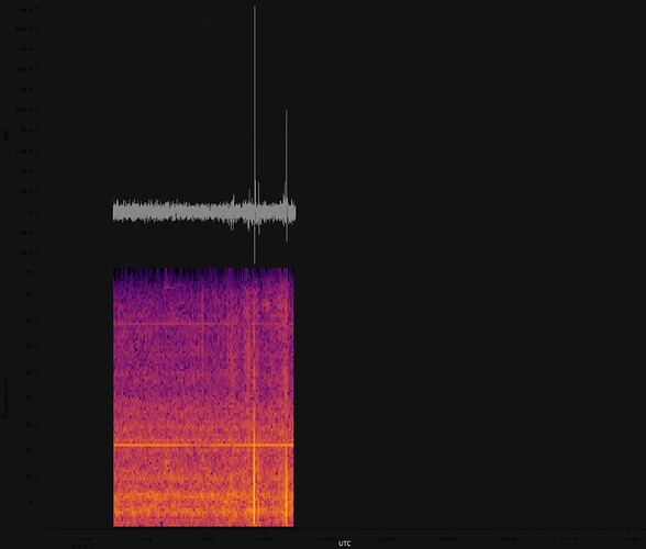

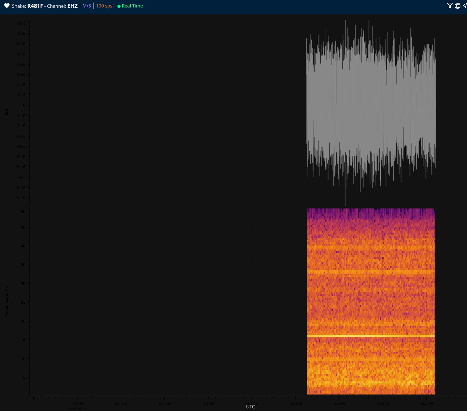

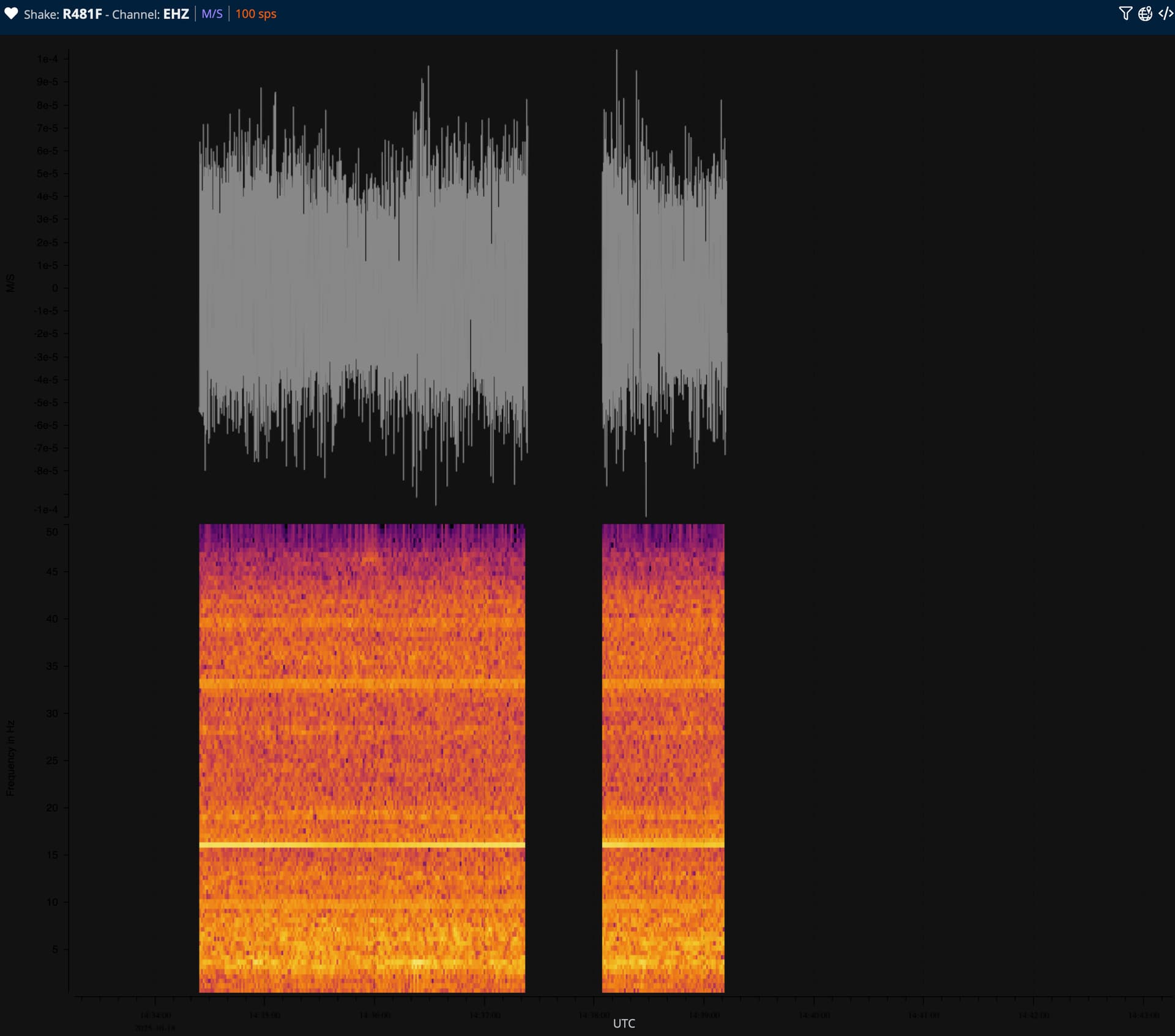

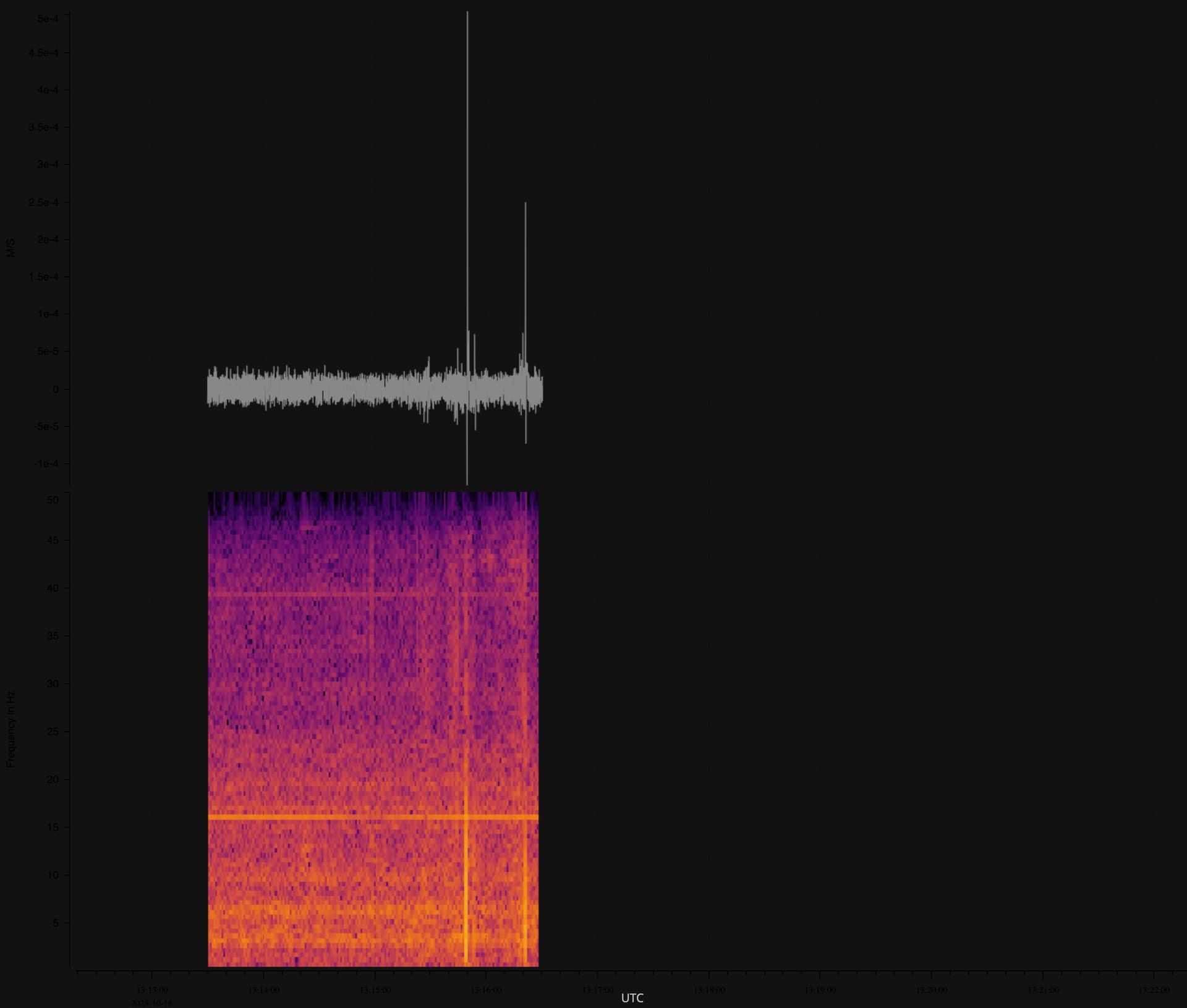

I have 2 raspberry shake devices, each on separate networks on different floors of a building. When viewing the station on data view, there are huge gaps in the data - cutting in and out every few minutes. Very frustrating. There are no gaps in helios local view. On both of my devices - again each in different locations - the cut outs happen around the same time.

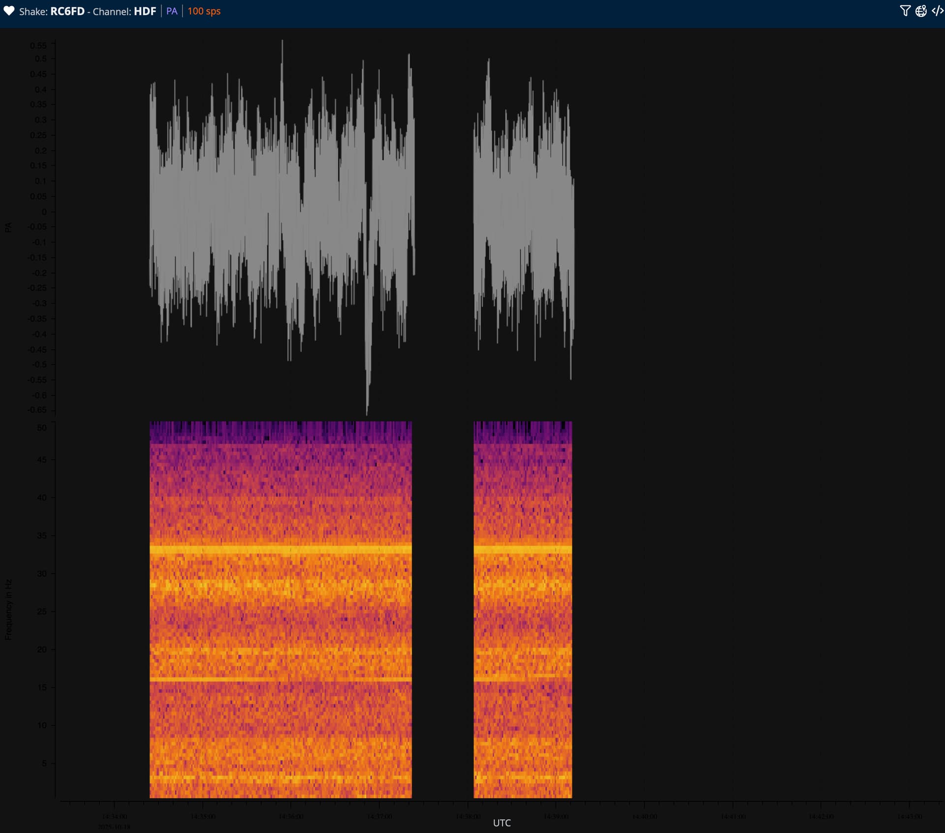

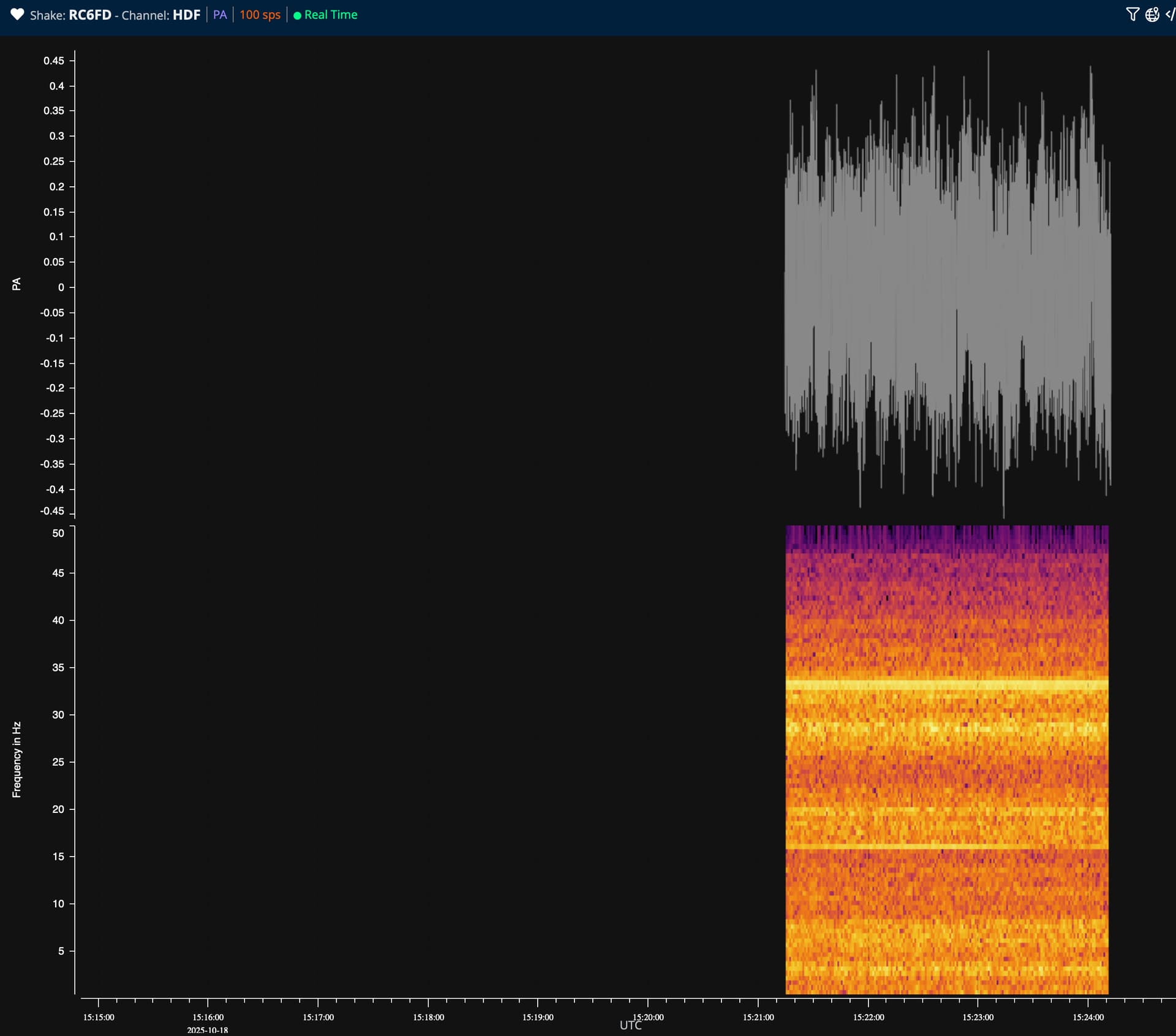

If you see the attached screenshots - these are two different stations with the cut outs happening at precisely the same time(s), which is what makes me think this may be server-side. See attached images.

Both cut out again at exactly the same time.
