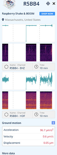

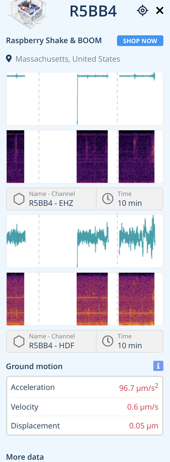

I also have intermittent data streams on shake net from a brand new shake-boom
Hello, following on the thread from Ajgnet (Intermittent data streams on shake net dataview) I have the same issue!
What is the problem you are experiencing?
I just installed a 1DShake-Boom. There are huge gaps in the data, coming and going every few minutes. There doesn’t seem to be any rhyme or reason behind it. I have a hard-wired network connection on a home network managed by me. The Raspberry shake-boom is set up with a static network connection.

Thank you so much for the detailed description, the logs, and the screenshot from StationView.
Again, as far as I can see on my side, everything appears fine from the logs themselves. There doesn’t seem to be, as you say, a correlation between what we can see in the files and the gaps on the website.
As I did for Ajgnet, I passed all information to our server team so that they can use it to review the situation.
I’ll update you as soon as I have news from them. Thank you for your patience while we address this.
Hello again Rosie,
The issue, a server-side one, has now been fixed, and all the streams from your Shake should not show gaps any more.
