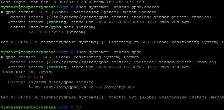

as for GPS, something is amiss, though i’m not quite sure what. can you send along the file /etc/default/gpsd, i’d like to see its contents. as well, please send the output from the following commands:
> sudo systemctl status gpsd.socket

Hi Richard,
I have change to stand-alone mode, and this is the same issue.
I send you the log of the two commands.
