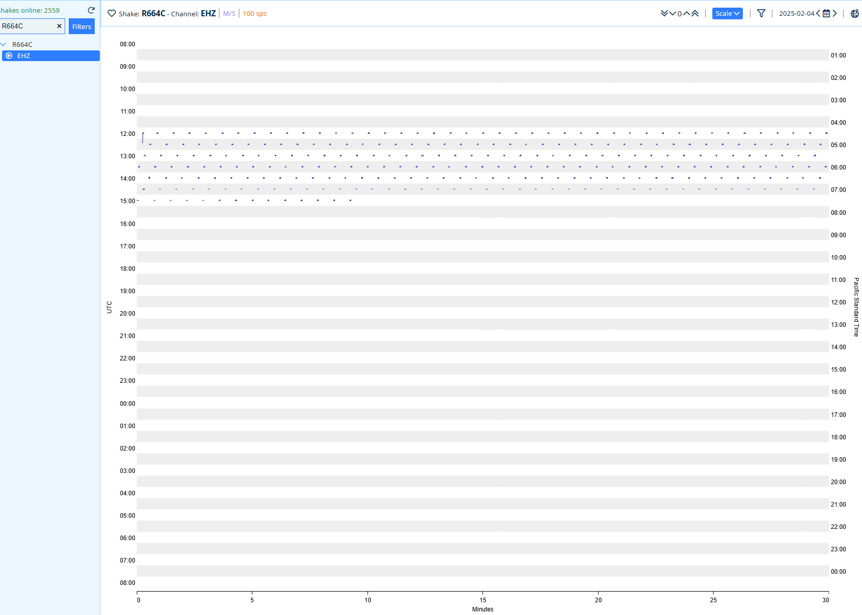

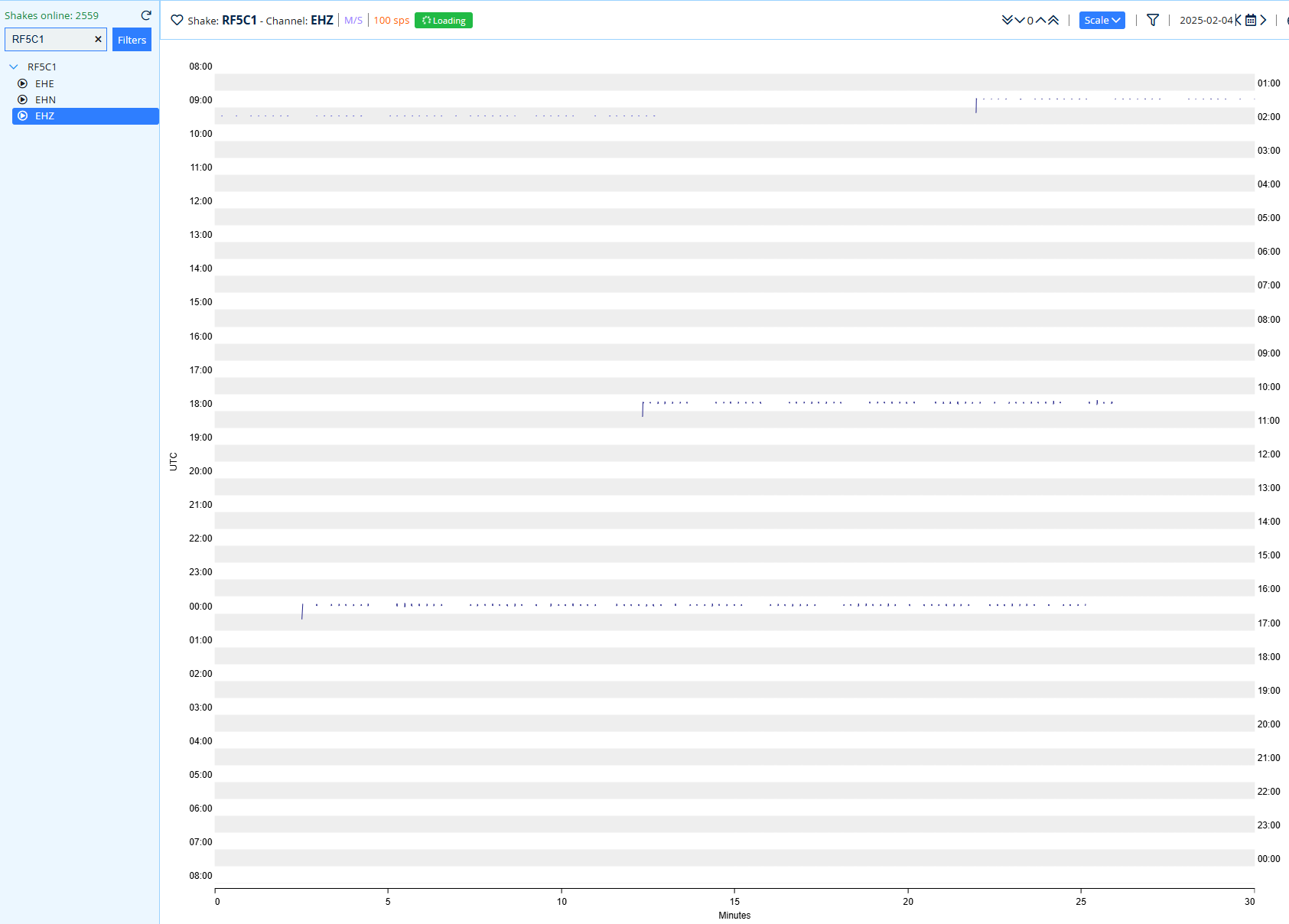

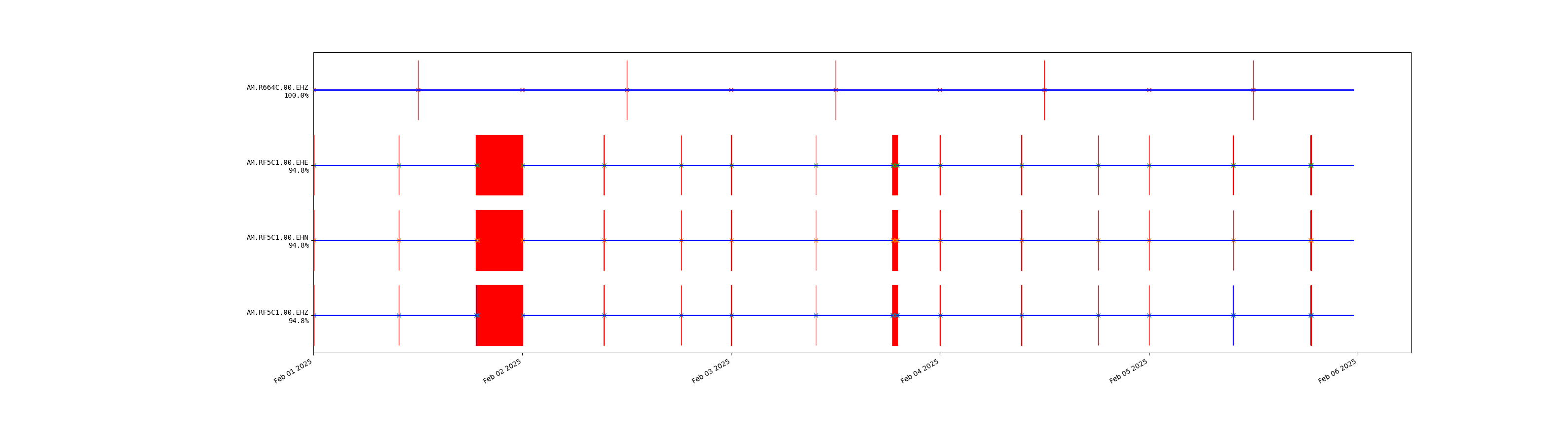

Here are a couple of example screen shots from the RS Dataview page. You can see the much missing, and small bits of fragmented data.
RF5C1
R664C
These screenshots are taken right now.

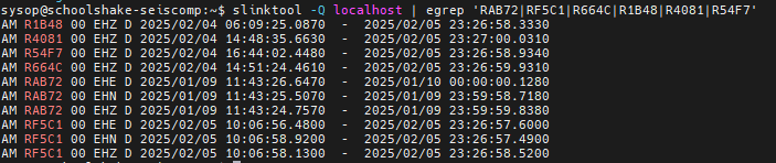

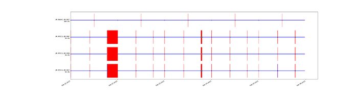

However, via our seedlink streams, I can see that we are receiving the data these stations:
You can see the data in our mseed archive during the month of February so far. While there are some gaps, the data is 99% complete for R664C and 95% complete for RF5C1.

Yes, data is definitely there as the Seedlinks show, so something must be interfering with your ability to communicate to our servers. The pattern that emerges from DataView is very regular…
