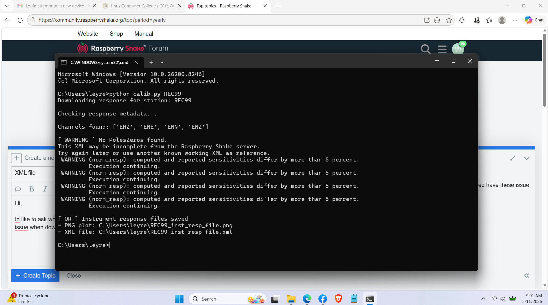

Id like to ask why a lot of the newer version of Raspberry shake that we purchased have these issue when downloading xml file. Not all but ive seen a lot. The device is connected to the internet for at least 3 days but it did not fix the issue. Any ideas why?

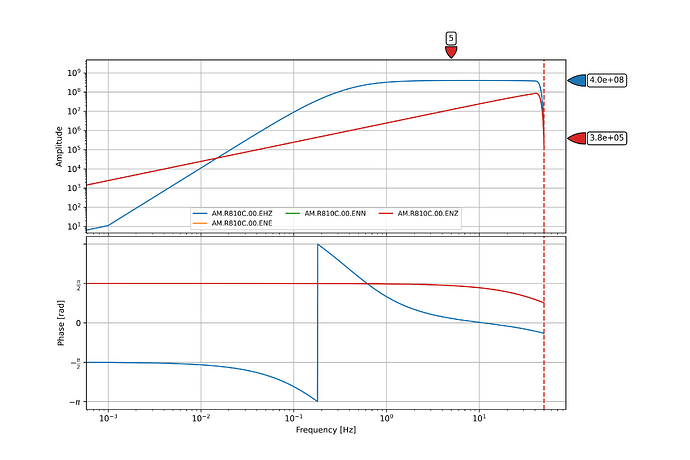

and these are the normal response that i was expecting
R810C_inst_resp_file.xml (54.0 KB)

Hi again,

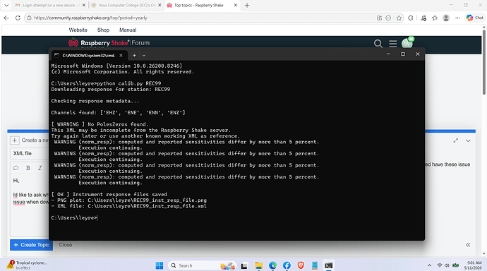

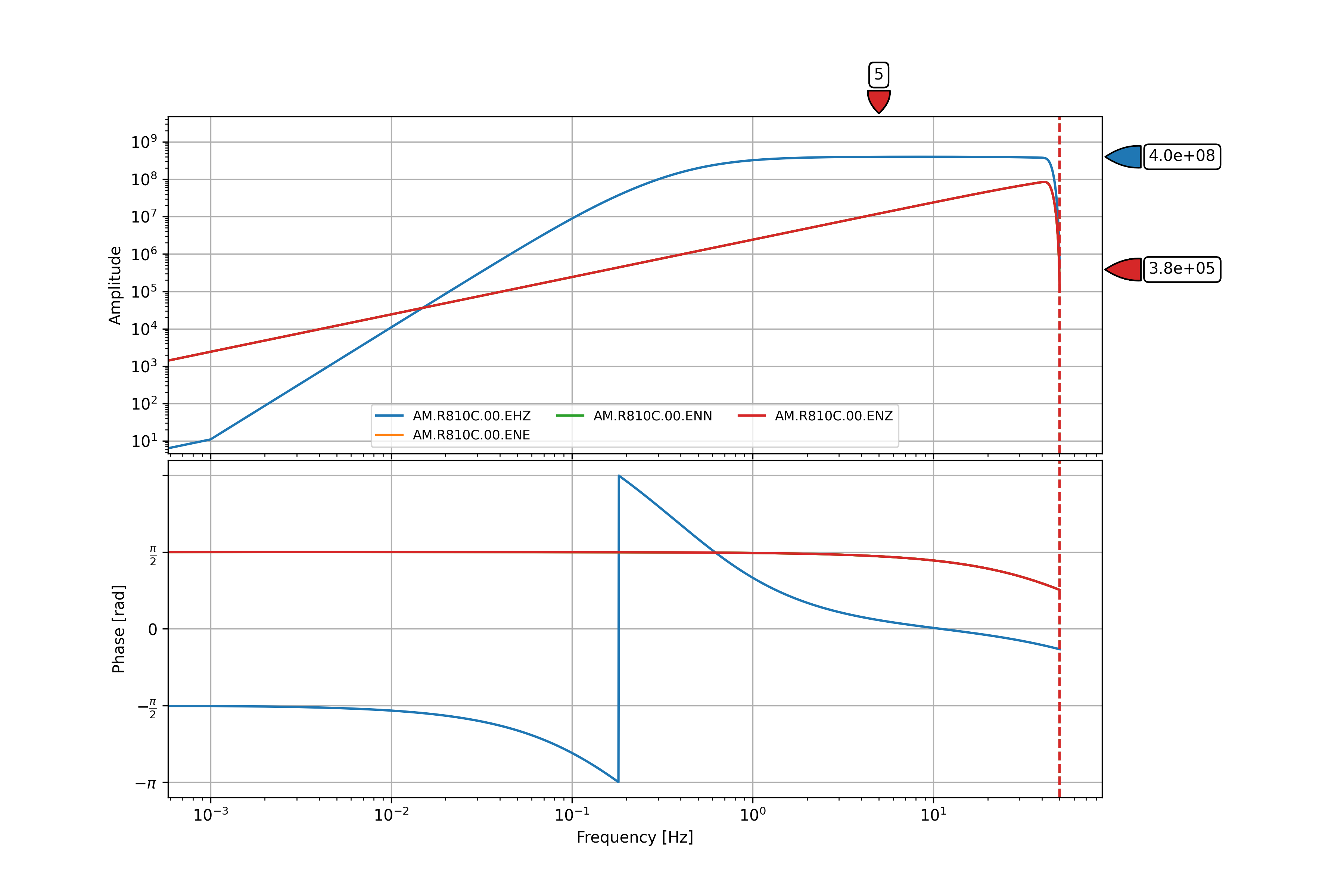

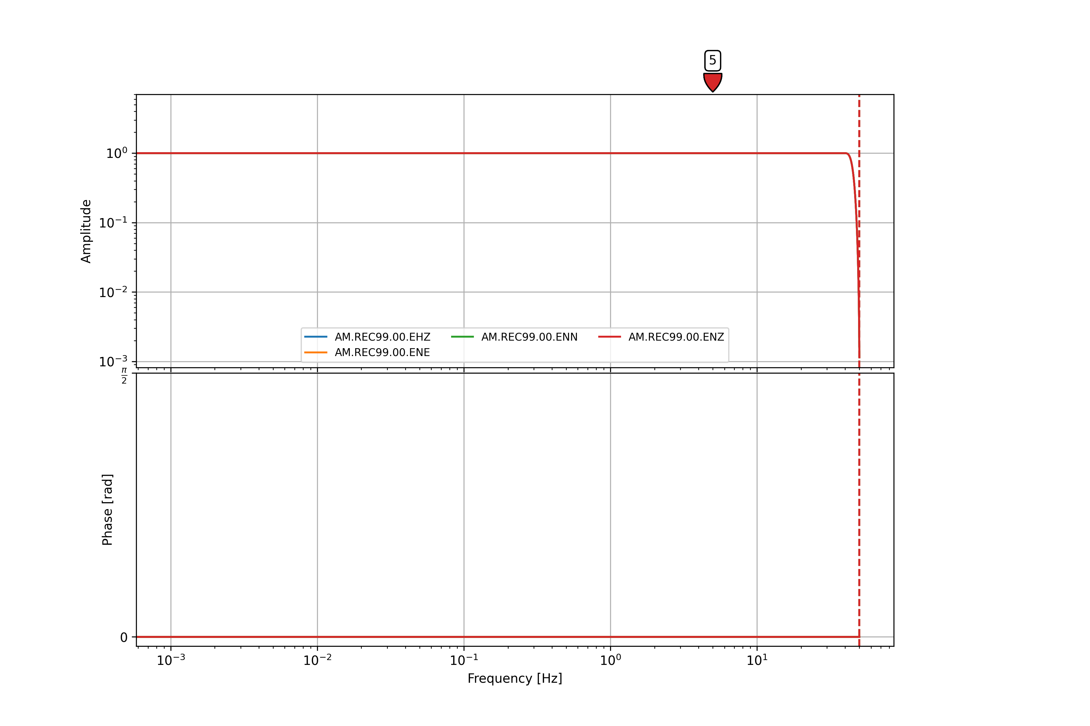

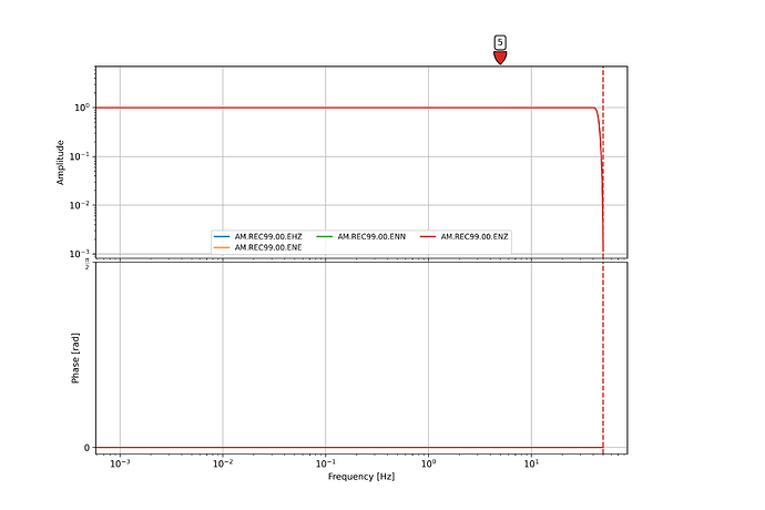

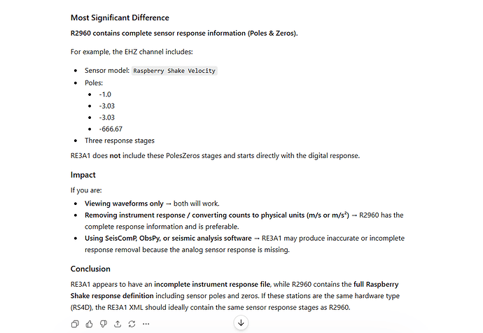

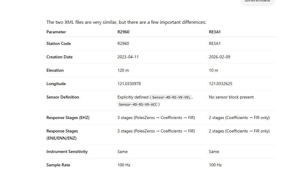

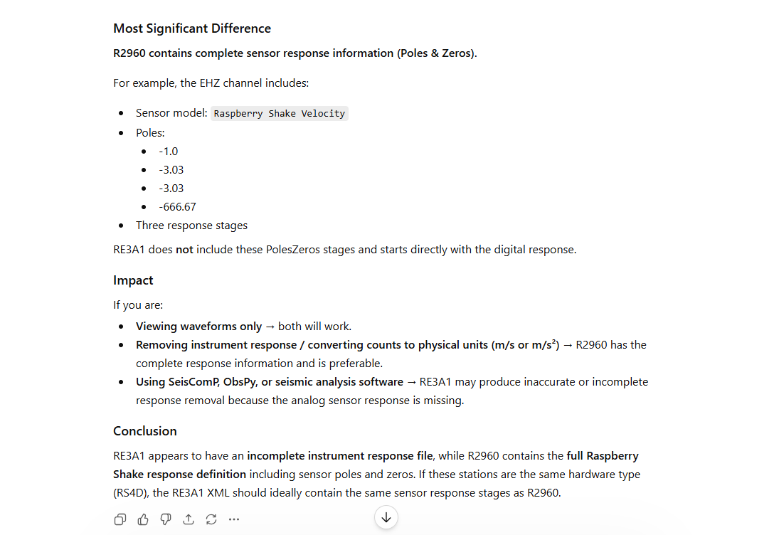

Thank you for your response. Unfortunately, the files that your team provided are the same with the xml files that i can extract from raspberry server. So what I did is compared the known usable xml file to the misbehaving ones. Please check these images, It might give you some ideas on where to look. Im hoping that we can resolve the issue as soon as possible.
Thank you very much for your cross-verification waw0102!
I have informed our server teams (thanks also for the images) about this issue, and I’ll let you know when I have news from them.
