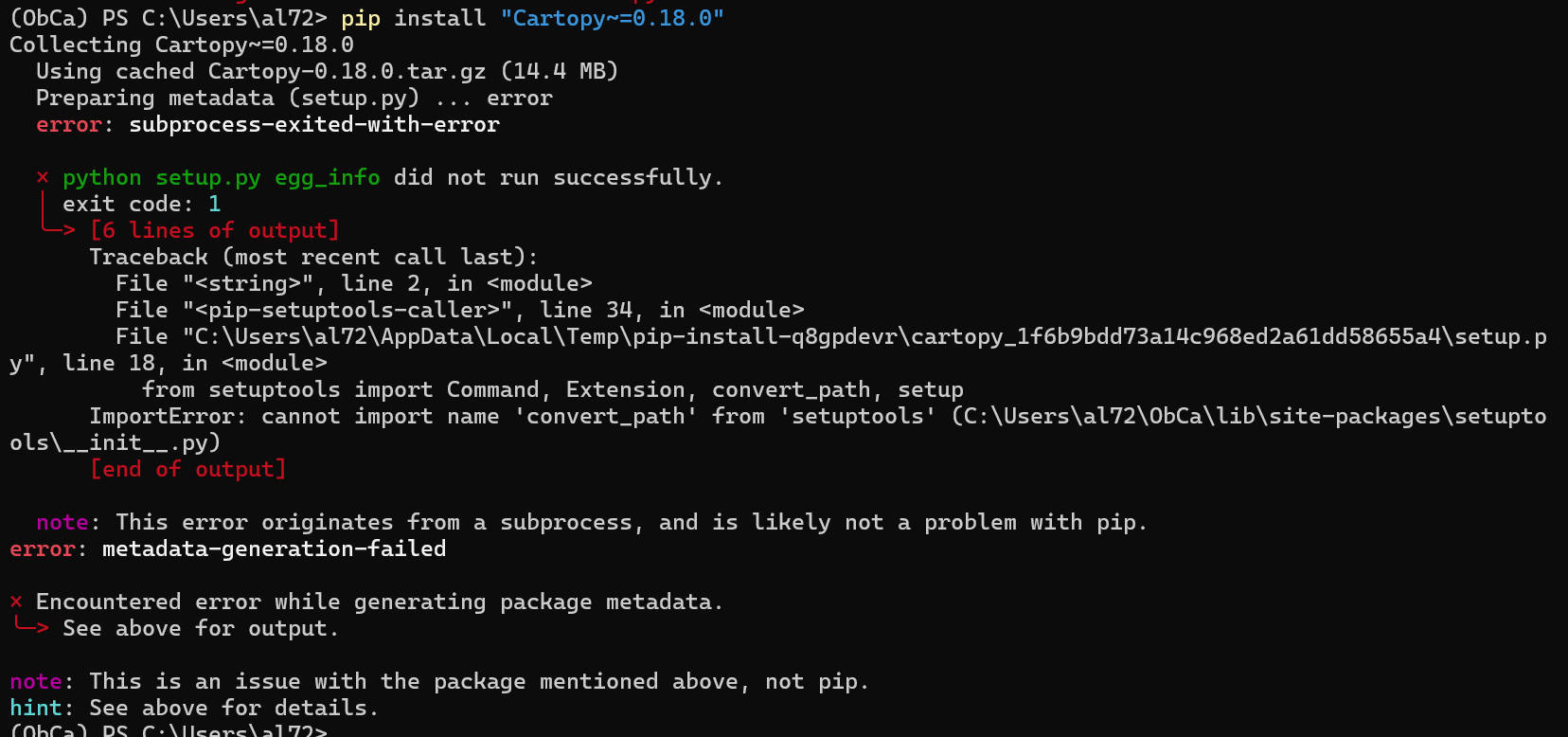

I’m still having an issue with Cartopy now.
I have created a new virtual environment with Python 3.9.12 and successfully installed Obspy 1.4.1, but Cartopy installation is crashing because there is no “convert_path” in
init.py
in the virtual environment folder.
I have tried various versions of Cartopy, with basically the same result.
Stormchaser could you please have a look in your
init.py
file and see what is required for convert_path? Maybe I can add an appropriate path.
Thanks,
Al.
Sorry I can’t get it to display the underscores in the filename. The correct filename is in the screenshot.
Al.

Hello Al,
In fact, I could not find a convert_path element in setuptools/__init__.py (you can add underscores if you enclose the text in “``” -without the external quotation marks).
Maybe you can try dlfowler’s solution in a temporary new environment and see if it works with all your other Python modules.
Thanks. I am still persisting… I may have to try a different installation sequence.
Al.
Thanks @dlfowler you provided the key.
For some reason I could not install a specified version of Cartopy with pip, so I did the install without specifying the version and then made the changes you suggested. I ended up with:
