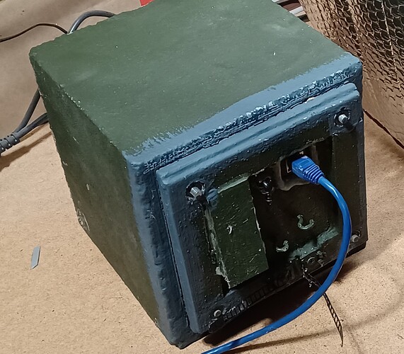

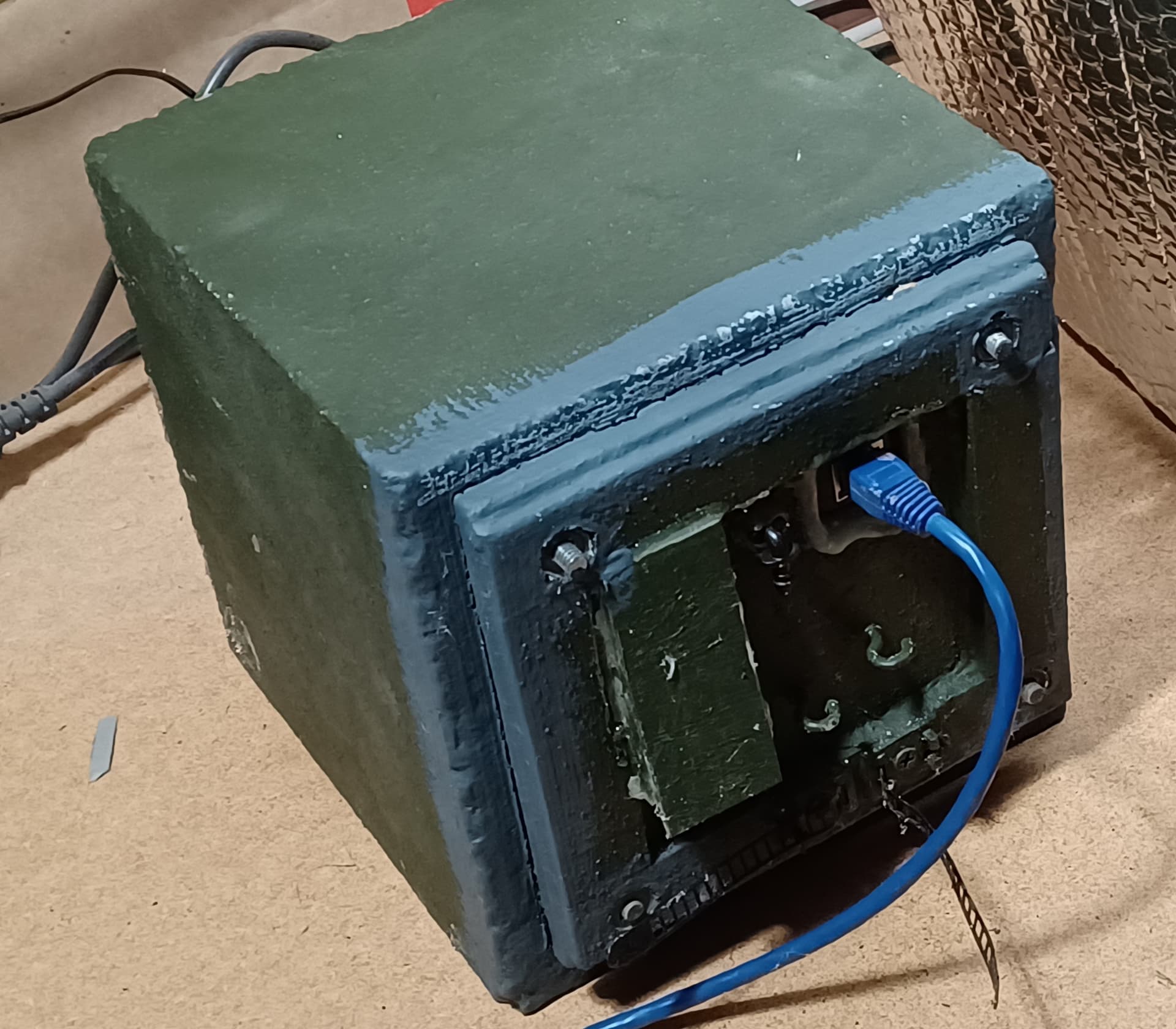

My R-Shake (actually, a “Boom”) went off line about a month ago. I could not access it remotely so I had to retrieve it and remove the microSD card and have a look. In the /var/log/kern.log file I find megabytes of lines like the below. Is it fair to say I need a new micro-SD memory card? Any way to prevent this from happening again?
