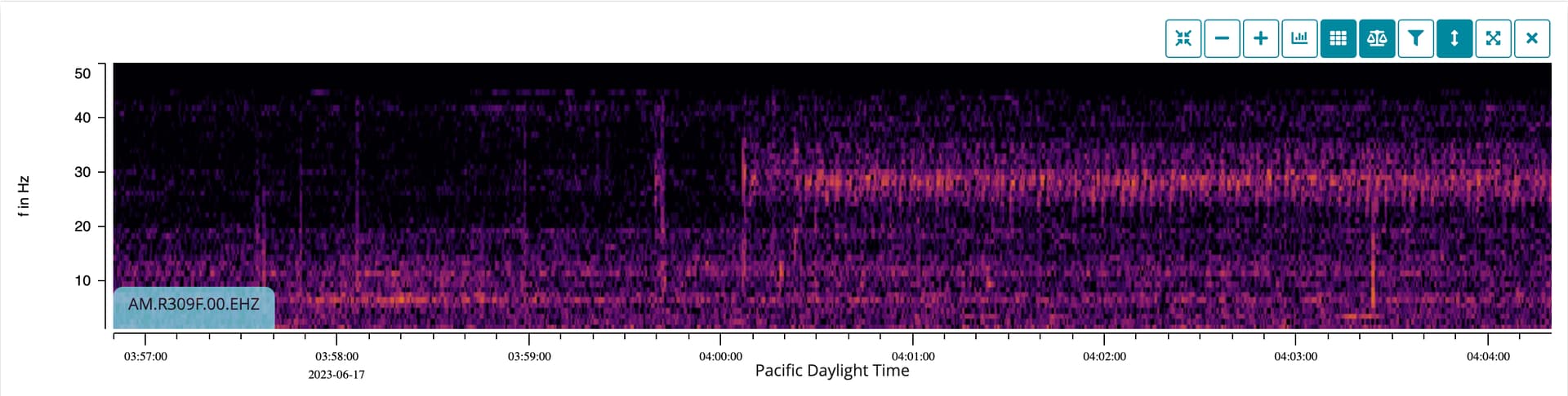

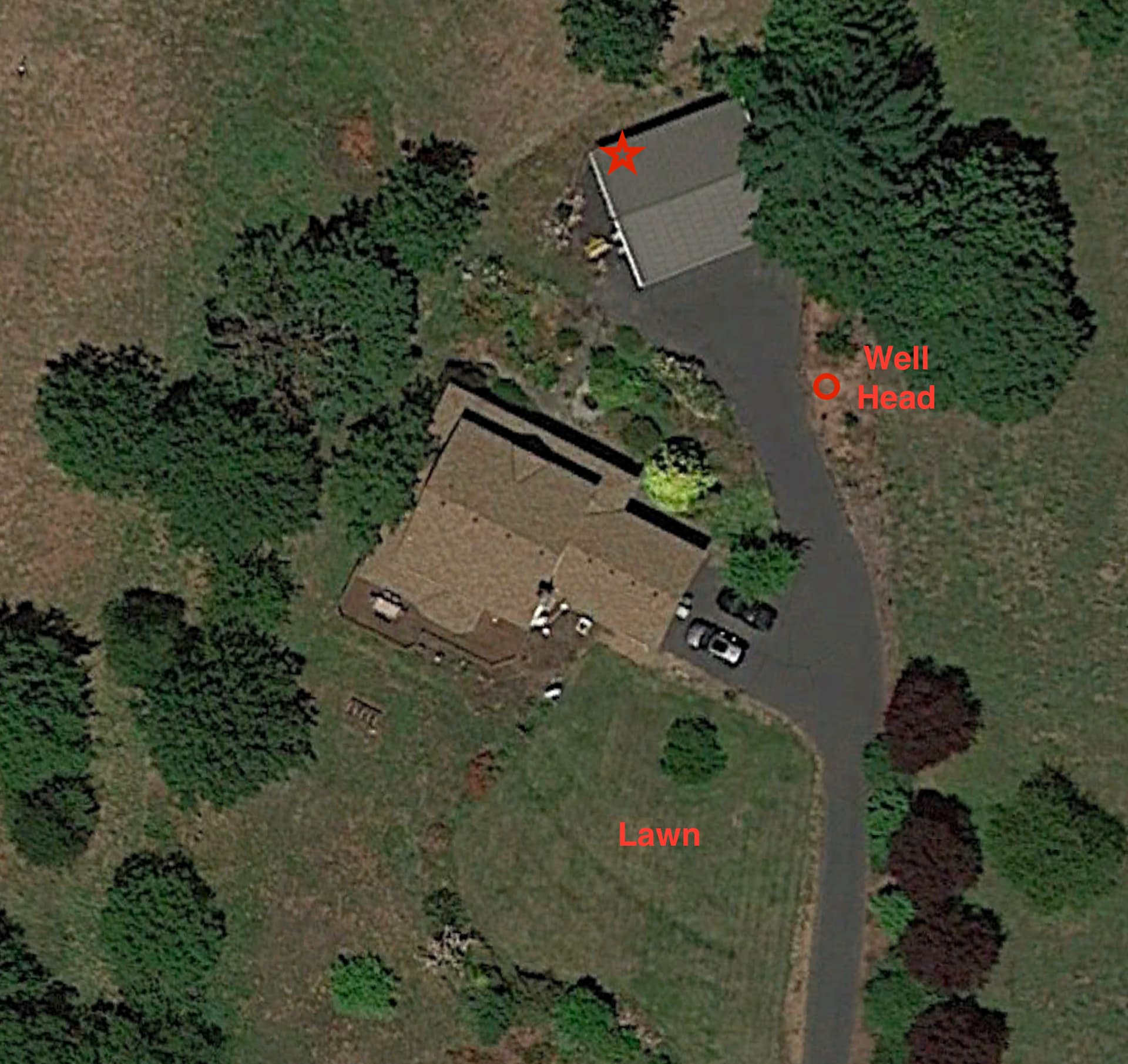

The star is the ‘shake. The lawn is 165’ away, and the well head is about 60’, but the pump itself is then about 300’ down. I initially thought it was probably the sprinklers that it was picking up … but 30Hz … it almost certainly has to be the pump.

Very curious Philip, but also very interesting! Never seen the noise from a sprinkler’s system pump before.

The well provides all the water. For the house as well as the lawn. I never noticed that before, probably for two reasons:
I never looked for it.
Normally, the pump will be running very intermittently, providing much less water.
The location in the barn was the quietest I could find. Nowhere in the house was quiet enough, especially when the AC/Heat Pump was running. I might be able to do better if I wanted to construct something to house it and run power out to it.
BTW, I also checked the “other end” of that signal - it cut off cleanly 2 hours later, when the watering cycle completed.
