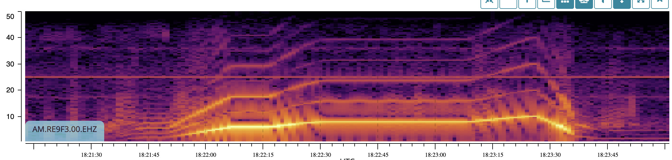

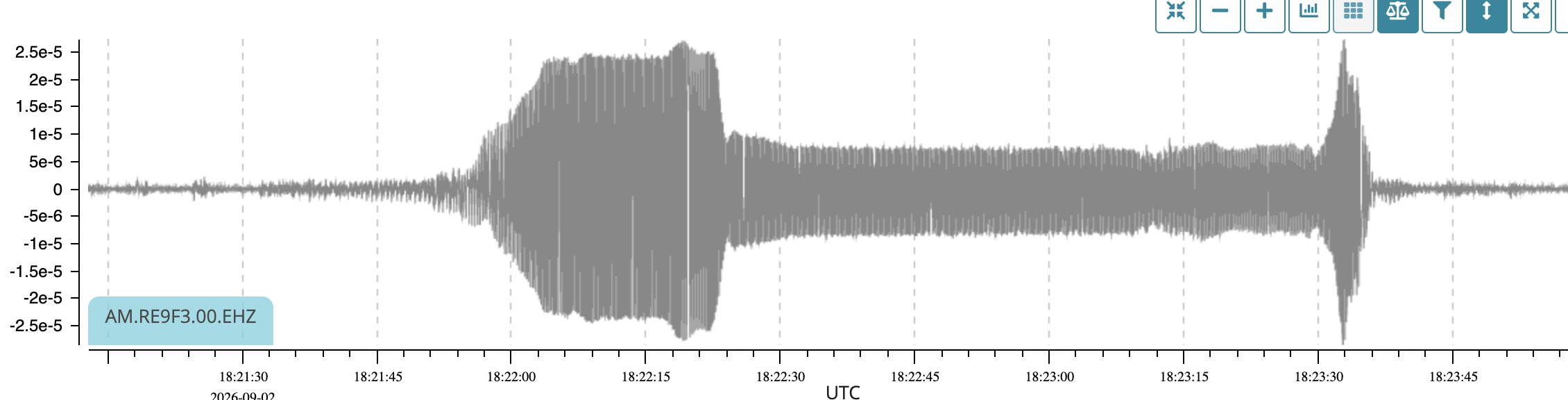

I live in a very rural area of Panama. At 1:30pm this waveform showed up. Very strange harmonics of low frequencies. Looks manmade. Any ideas?
I found out what this was. We just got a new inverter front load washing machine. Duhh.
ah, yes, the washing machine… and now you can know when the washer has finished, just by checking the signal on your shake.
