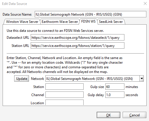

So this means the SWARM application user needs to update via the ā€˜Edit Data Source’ to use/ acquire waveform data from various networks via IRIS web service which were previously coded to use the service.iris.edu web service. Raspberry Shake SWARM client users are able to make this change… but it’s very time consuming… Thought I’d pass it along in case someone else runs into the same problem… Have a great day/year!
Fred
Unfortunately, the new Earthscope Consortium URL https://service.earthscope.org/ in the Dataselect and Station URLs does not work in SWARM even though SWARM accepts the change. When looking at the log, SWARM reverts to the old URL http://service.iris.edu and still throws the 307 error and retrieves no waveforms. Obviously, an endpoint is missing somewhere or SWARM code needs to be updated to handle the redirect that Earthscope Consortium is using. BTW, you must use https:// for SWARM to recognize the Edit Data Source URL Fred’s still broke but trying!
V/R
Fred
