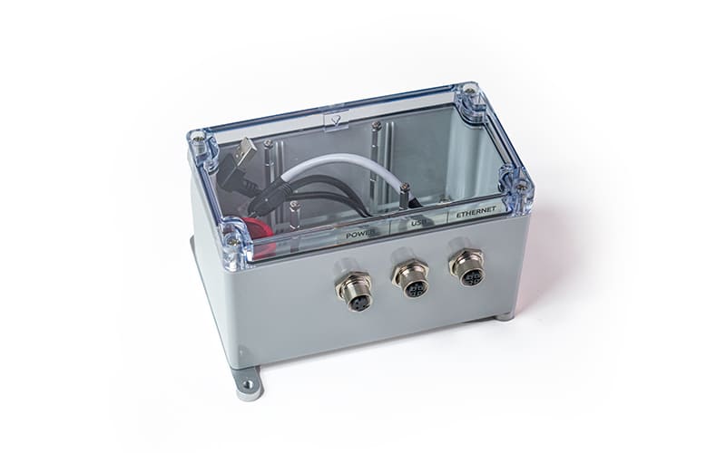

Thanks Ian. May buy from your shop so I can pick up a couple of enclosures. Are weatherproof enclosures still available? I could not find them in the shop. If not, we can enclose the indoor units - but waterproof would be preferable.
Thanks,
Robert

Yes, they are available here:
