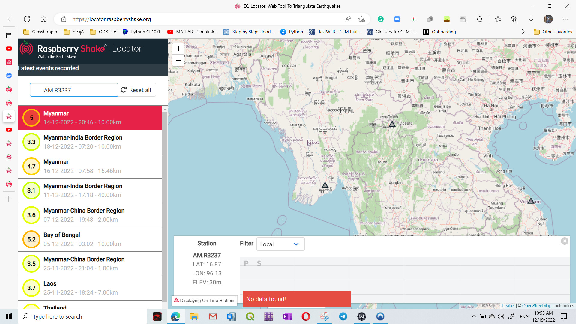

My R3237 station is not showing in Station view.

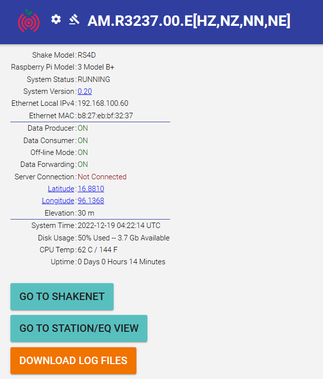

That’s my rs local view Jpeg.
Moreover, in the Earthquake locator tab, there is no data in my station.
Can someone guide me?

hello Way yar,
the log files (and screenshot) indicate that OFF-LINE mode is turned ON. if you would like your data to be forwarded to the server, please re-configure your unit and turn OFF-LINE mode to OFF.
let us know if you have any more questions,

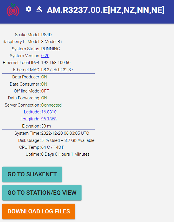

ivor, thanks alot for your explanation. can you show me the how to re-configure your unit and turn OFF-LINE mode to OFF .
I have made “Turn OFF-LINE MODE OFF” as described in attached
When I made as attached above image. i found some changes as per attached image. is it okay for now ?
Thanks for your support ivor.

hello wai yar,
your unit is connected to the server and is now on-line:
https://dataview.raspberryshake.org/#/AM/R3237/00/EHZ
