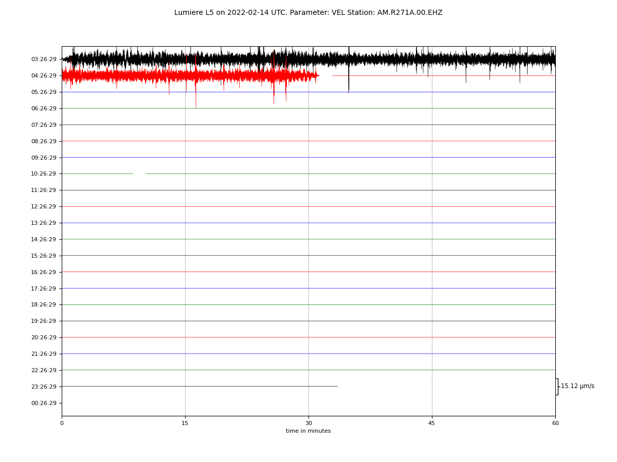

Ok thanks - the odd thing is I’m uploading the data to an external server every 10 minutes and it looks like that data was corrupt - all I got was flatline data. See https://nciassets.inside.net/shakeandsway/R271A/2022/02/14/2022-02-14_R271A_EHZ_VEL_dayplot.png for Feb 14. Oddly, even though the data had come back for the live feed (the link of which you posted) the data remained corrupt for the remainder of Feb 14.

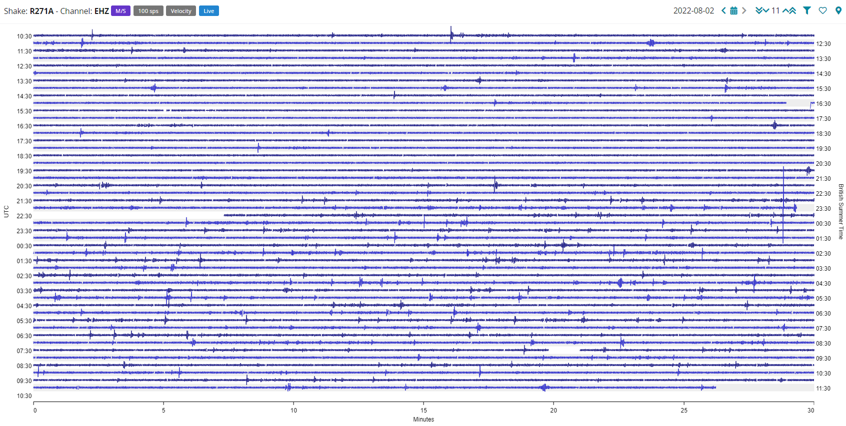

It is indeed curious since I can see normal data (and not flat) for Feb. 14th on our DataView service: RS DataView BETA
Is it possible that the data you uploaded to your external server has been corrupted somehow, thus creating that representation? In any case, except for the interruptions that I saw between the 13th and the start of the 14th, everything looks good on our servers, so if you need, you can re-download the data from these days from there.

Because, as it had happened before, on DataView I am able to see normal (not flat) data being stored on our servers (image attached).

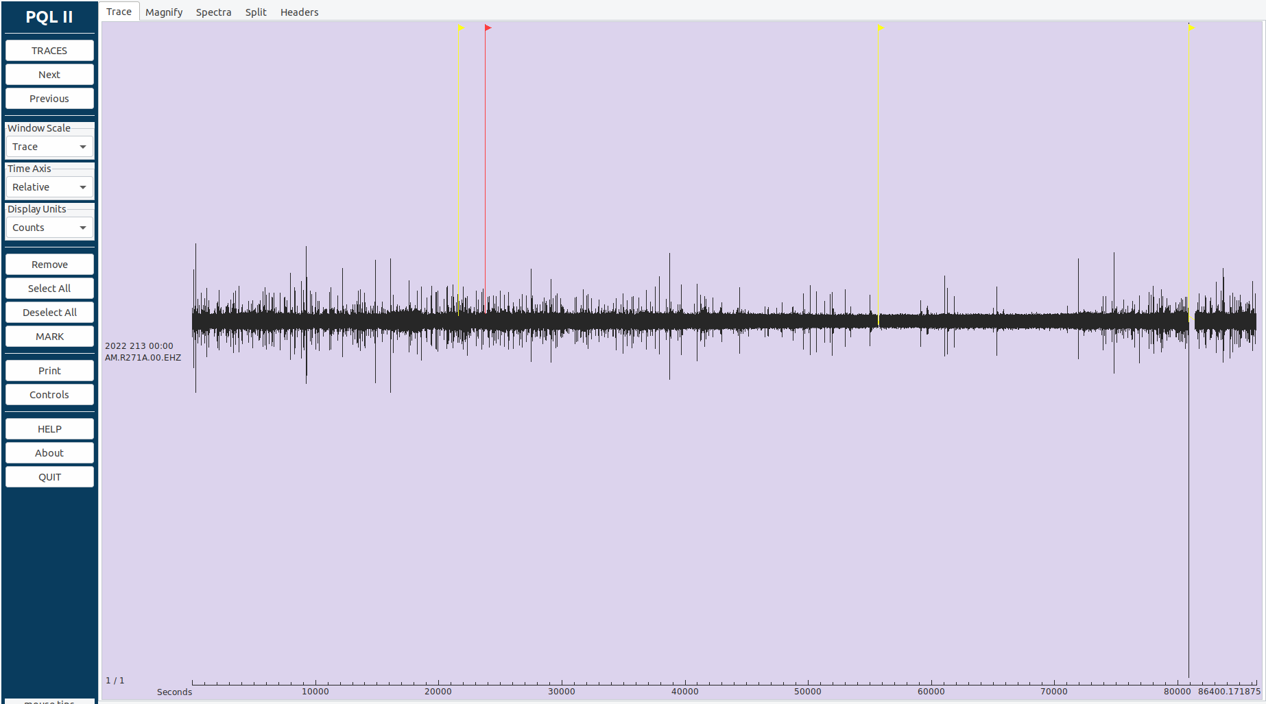

Just opened that same file in PQL. Works fine. So this is definitely a software issue, not a file issue.
Notice the gaps (yellow flags) and overlap (red flag). Your script is not recovering from there being a gap in the data …
