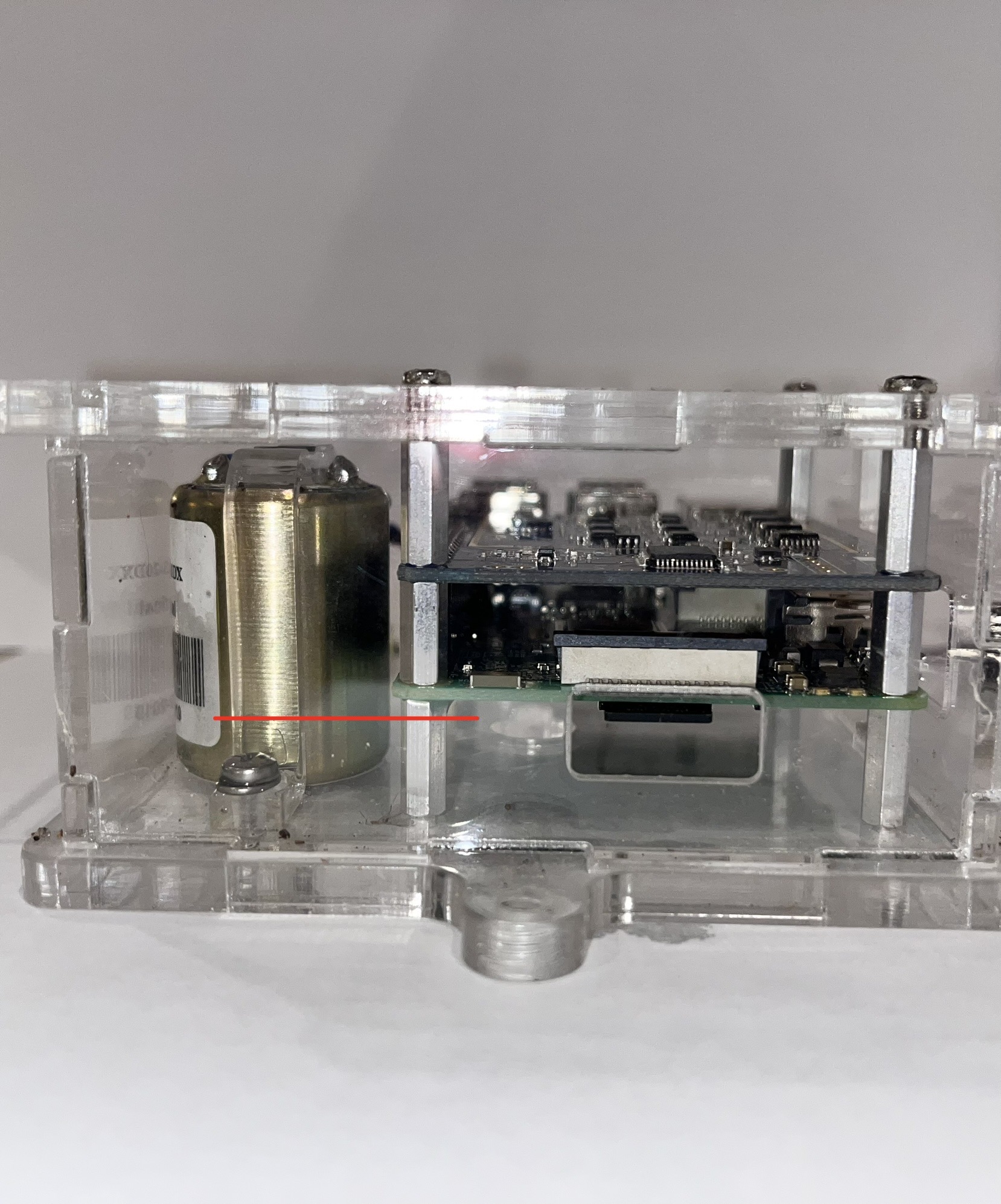

Lo and Behold, I check in on the vault and there’s a about 2 in (50mm) of water in the vault and the water had just started to lick the bottom board of the shake and send out those spikes of data. My POE splitter was completely underwater and surprisingly was still giving power to the shake and sending data back. (I intentionally put the splitter in the lowest point in the vault so that if water did get it it would take out the splitter and I would notice but oh well :)) I was super lucky to be home and be able to pull the shake out immediately and bring it inside. When pulling the shake out not much water dripped out of the enclosure so hopefully I didn’t do much damage.
Anyway’s the main reason I posted was to get advice on things to do before powering the shake back up. I’m obviously letting the shake dry out for now but what I’m more worried about is the geophone on the shake. It appears to have taken the worst of it and I’m worried about long term damage to the geophone given all of the small metal parts inside of it that might rust and/or corrode.
I’ll attach some pictures but the water seems to have only made it less then half way up the geophone. If possible would it just be better to replace the entire geophone? I attached some photos of my shake as well as roughly where the waterline was when I pulled it out of the vault.
