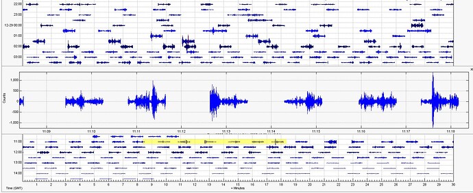

I have a problem with a Raspberry Shake 1D. The device exhibits persistent gaps in the signal.

I can access the Raspberry Pi remotely through a router via VPN, but at the moment I cannot go to the place where it is located.
What can I do to solve this problem? I’ve attached the logs.

The gap problems started a week ago. Before that date, it worked fine.
According to the log files, there’s low voltage, but the device is connected to a solar panel, batteries, and a DC-DC converter. I’m communicating with the Raspberry Pi via VPN through a router that operates on 12 volts.

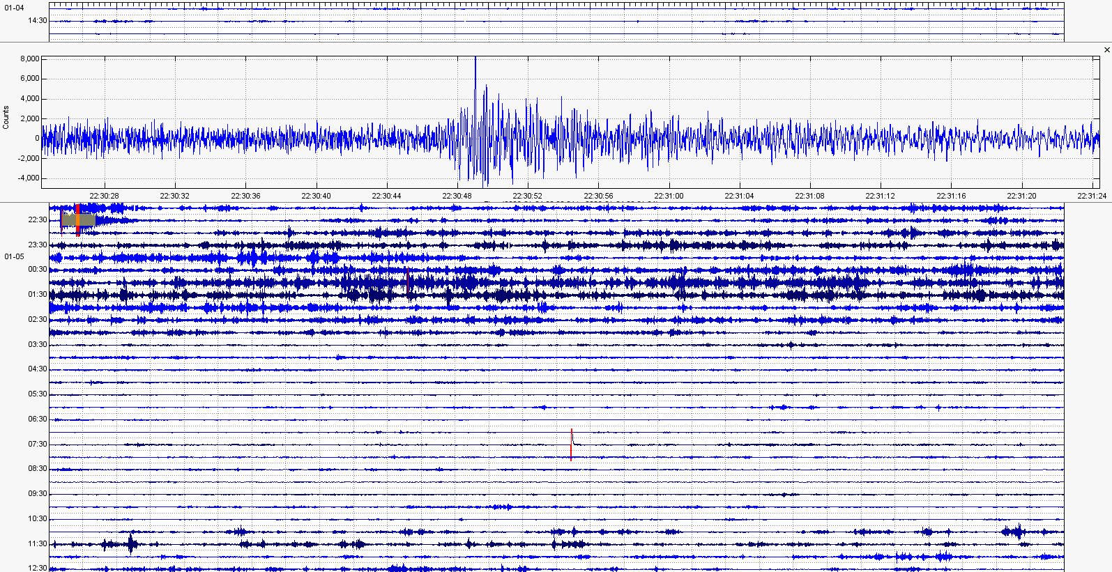

Hi,
Since I couldn’t go to the location, I restarted RShake several times and after that the gaps disappeared over the course of a few days.
