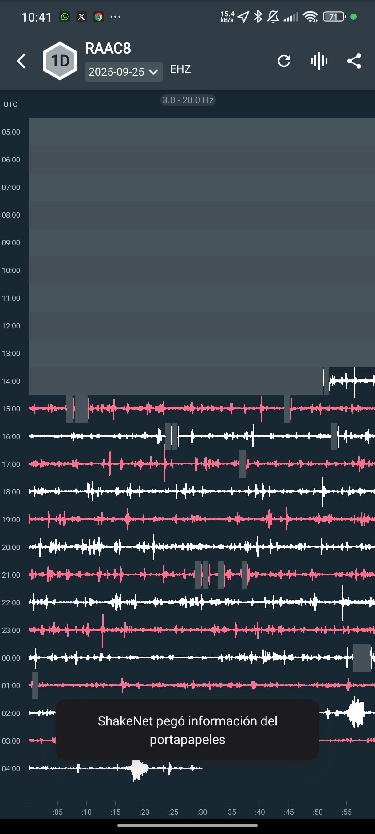

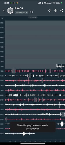

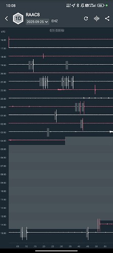

I have recently experienced a strange issue: several low-frequency spikes started to appear frequently, and afterwards the Shake stopped sending data to the Raspberry Shake server for several hours. It came back online by itself, but this problem worries me. In addition, I keep seeing periodic data gaps, as shown in the attached screenshots.

The problem appeared almost right after installing the Shake. Some data gaps were present. A few days ago there was a short power cut, but these problems started a few days after that event.

Thank you very much for your detailed description, the screenshots, and the log files.

Also, if you can, post the most two recent local Shake helicorder images accessed via this button in the bottom bar.
