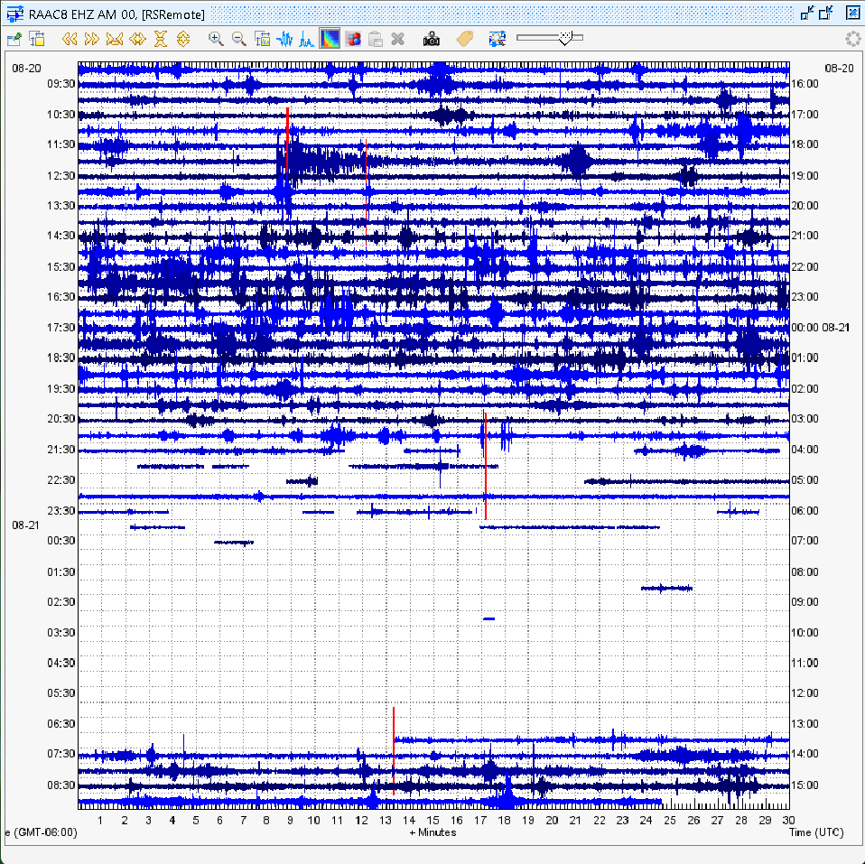

The problem is that I am getting data gaps that can sometimes last for several hours.
I have noticed a few different situations:
  • Sometimes Winston Wave stops working, but SeedLink continues to work.
  • Sometimes Winston Wave, SeedLink, rs.local and the helicorder all become unavailable at about the same time, while ZeroTier still shows the Shake as connected.
  • Generally after that ZeroTier also disconnects and the Shake becomes completely unreachable for hours, this coincides with the large data gaps, and when the shake connects back, its when the data starts to appear again on the helicoders.
The gaps shown in Swarm’s helicorder are the same gaps I see through rs.local/heli.

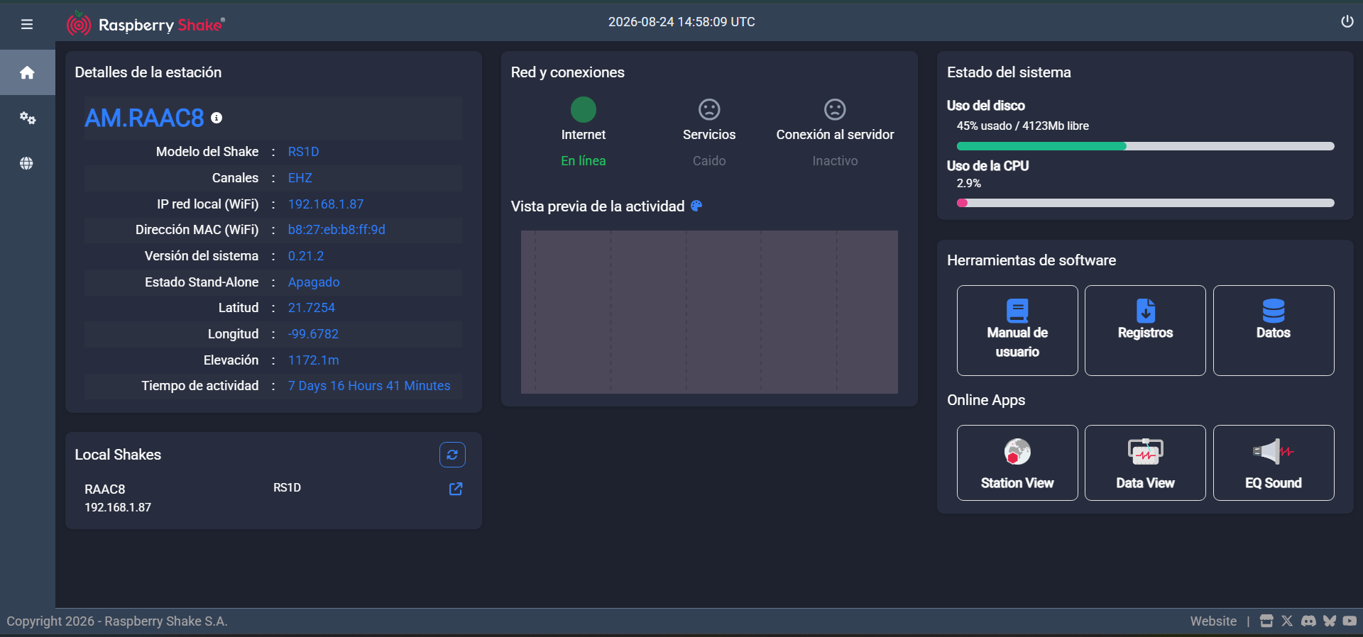

At the moment, the issue is happening again. I can still access the Shake through SSH and the web panel, but the services are showing as down in the panel:
Since you mentioned out-of-memory errors and segmentation faults, could these possibly be related to the Shake repeatedly trying to connect to the Raspberry Shake servers? The ISP at this location appears to block or interfere with the Shake’s connection to the Raspberry Shake servers, although ZeroTier and SSH/web access still work.
