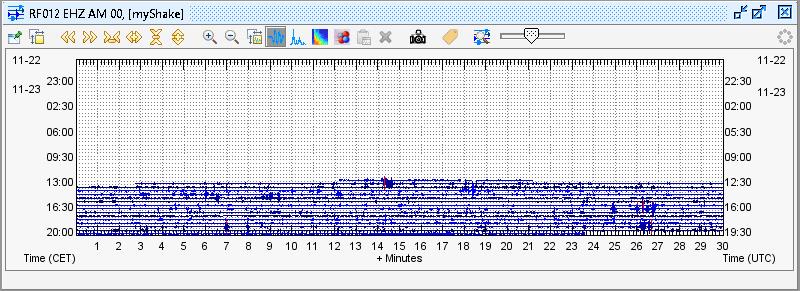

Within my network I see perfectly the graphics given by the Geophone. OK

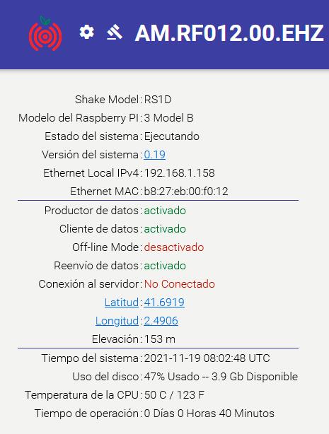

But now mark marks the wrong time. It does not synchronize the time well
And as an advance, never connect to the server.

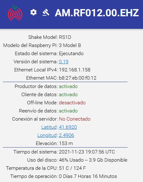

Following the directions of the kind Richard, as I failed to get my raspberry Shake to send data to the Server (see image), I unzipped the S.O. content in “raspishake-release.zip” to a new SD card de 8 GB.
Unpacking the Raspberry drive worked fine and restarted again. Everything is fine but still not connected to the Server.
With the Fing I see the IP of the Raspberry
I see the Web configuration well.
The Swarm program and graphics go well too.
Since the new card was started, I have not touched any router or Shake settings, only the registration data and I have activated Data Forwarding.
I connect with ethernet cable and I have not connected the Wifi.
Please look at the log files attached, to see if you can see where the problem is.
