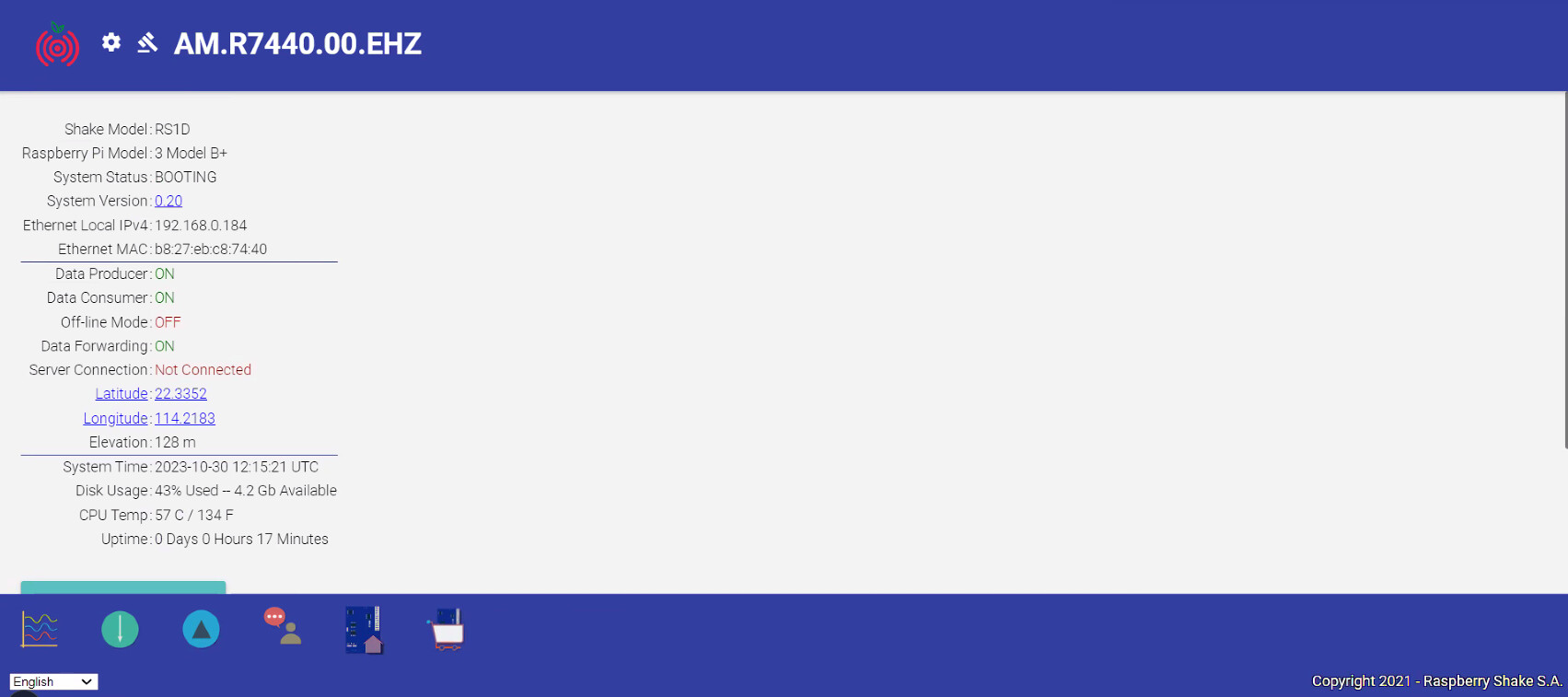

Hi, my shake is unable to connect to the server and the status keep showing BOOTING since around 8:30 UTC on 30th October. I accidentally broke the micro USB power cable today…. But the shake is operational after I use another cable to connect it, while I am not able to see the live data. Not sure if it is related to the issue. My shake is R7440. Thanks in advance.

Thank you for posting both the logs and the screenshot from rs.local/. Great to hear that you were able to replace your microUSB power connector. From the logs, it appears that, during the booting process, the Pi board is not able to see the blue Shake board above it:
