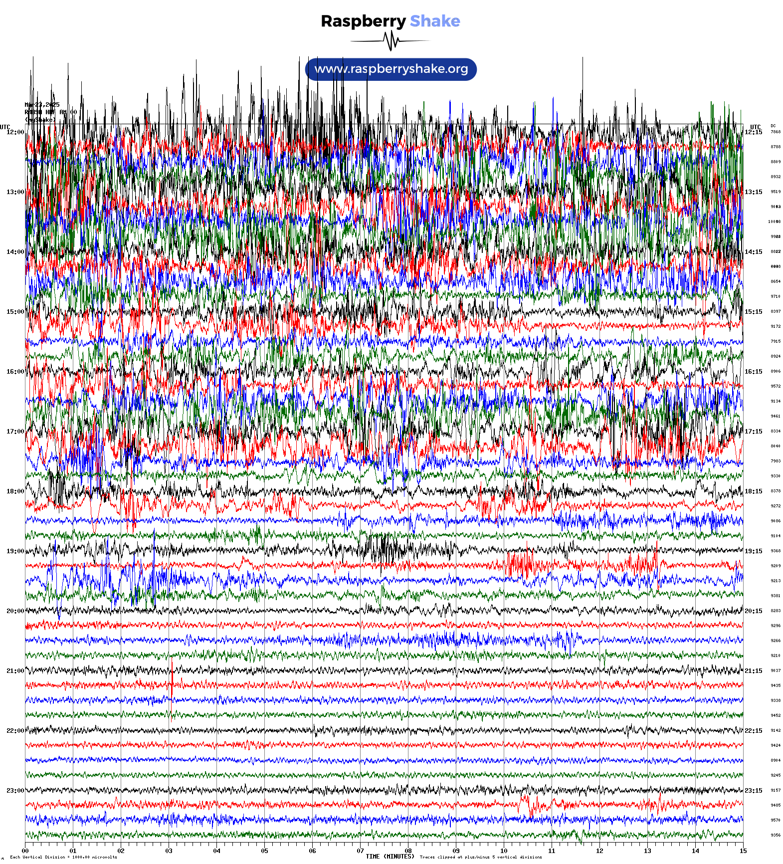

Is there a way to select the sensitivity/scaling of the Helicorder recording?

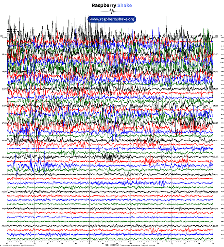

I am using the long period filter. Most of my files are looking this way.
Helicorder Scaling Value is already set to 0.1, what I suppose, is the lowest amplification.
Many thanks
Jochen
Hello Jochen,
You are correct, 0.1 scaling is the lowest value that can be set for the Helicorder Scaling Parameter (which, for all readers, can be found in the Settings - Data tab.
If you want to replot the data with a different, smaller, scale, I can recommend using ObsPy (Python module) or MATLAB.

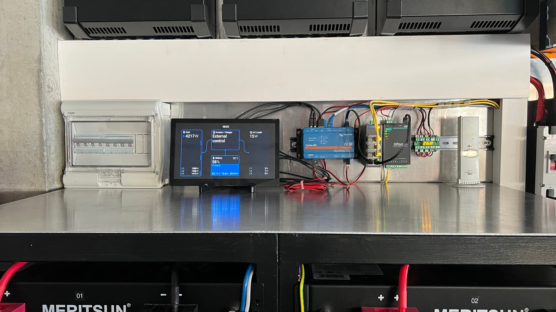

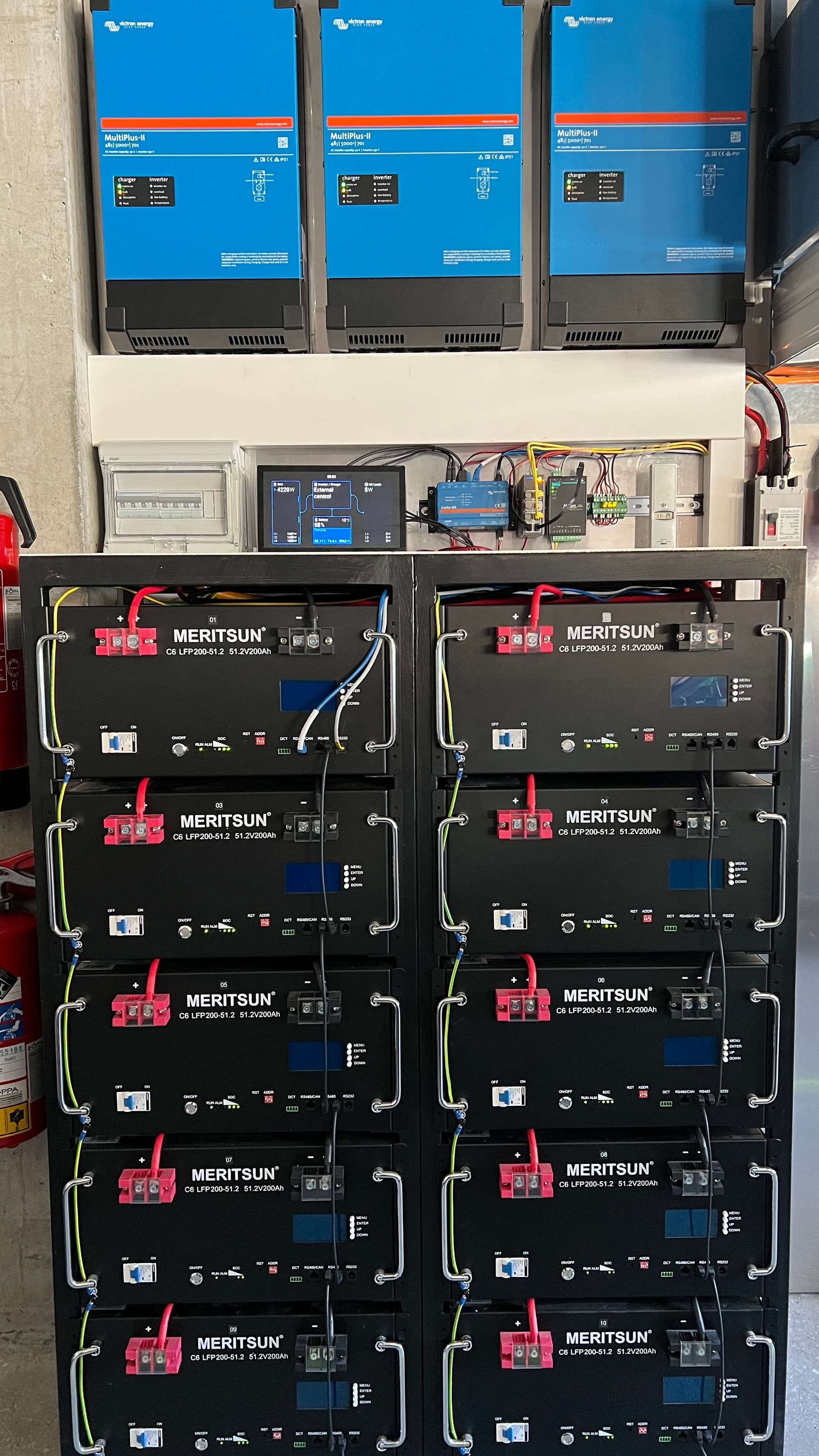

My last big project was a energy storing system for our waste solar power. If you sell your waste solar power you earn 0.06 chf. Than they bill you for the usage of their power lines, that they can sell your power for 0.20 chf. So I built a 100 kw/h battery storage with three victron inverter, big bus bars 40x10mm cupper and 75mm2 cables :slight_smile:
