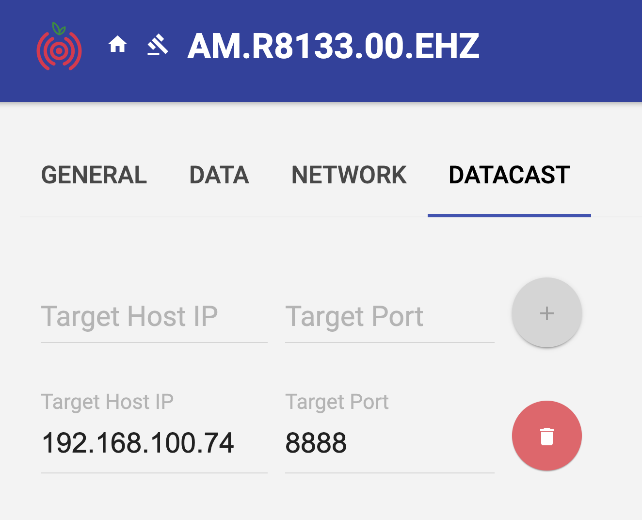

I also added a datacast address because I want to use rsudp.
The datacast IP address is of my Ubunto VM (running on MacBook) after configuring the VM network as “bridged adapter” to get an IP address on the same subnet as the Shake. The port number is 8888.

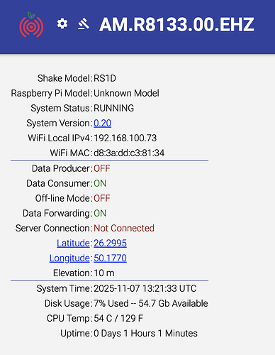

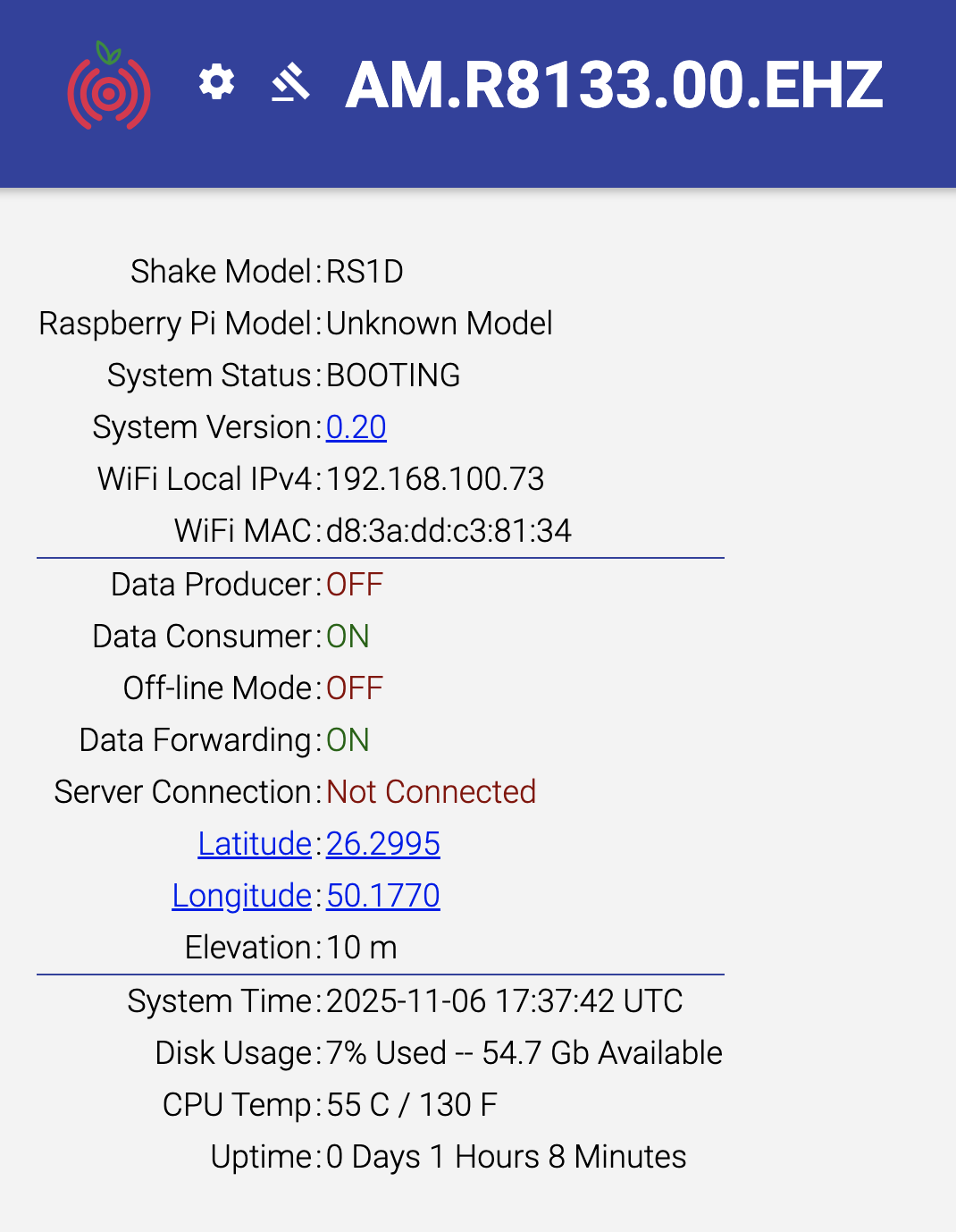

This is the status of my Shake:
I tried sending test data from my Shake to the VM on port 8888 to make sure it is not a network/firewall issue and the VM actually received the data with no issues. I tried rebooting many times but nothing worked.

Hello linah,
Thank you for all the details and the logs from the Shake. From the last screenshot, it can be seen that the Shake is still in a BOOTING status, and that not all data services are ON.

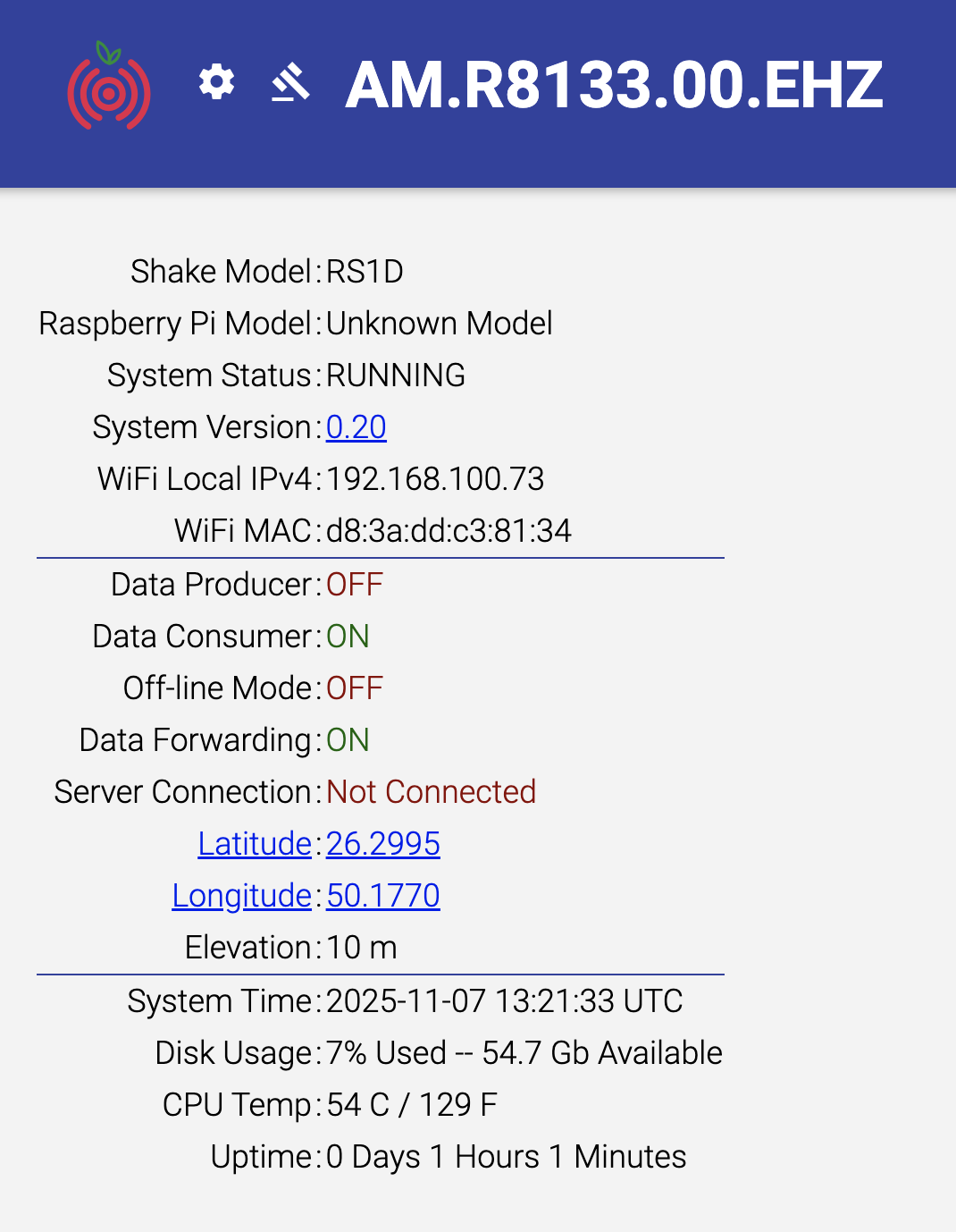

Also, this is the status now:
(I did not notice the BOOTING status before… not sure when exactly did it appear… but now it is RUNNING)

No trouble, and thank you for the new screenshot and the logs.
This was a bit baffling, so I asked support of our software team, and they found the issue. As you can see, the Data Producer is still OFF even if the Shake has completed the booting procedure. This is usually caused by some software corruption on the microSD card and there are two solutions to fix it:

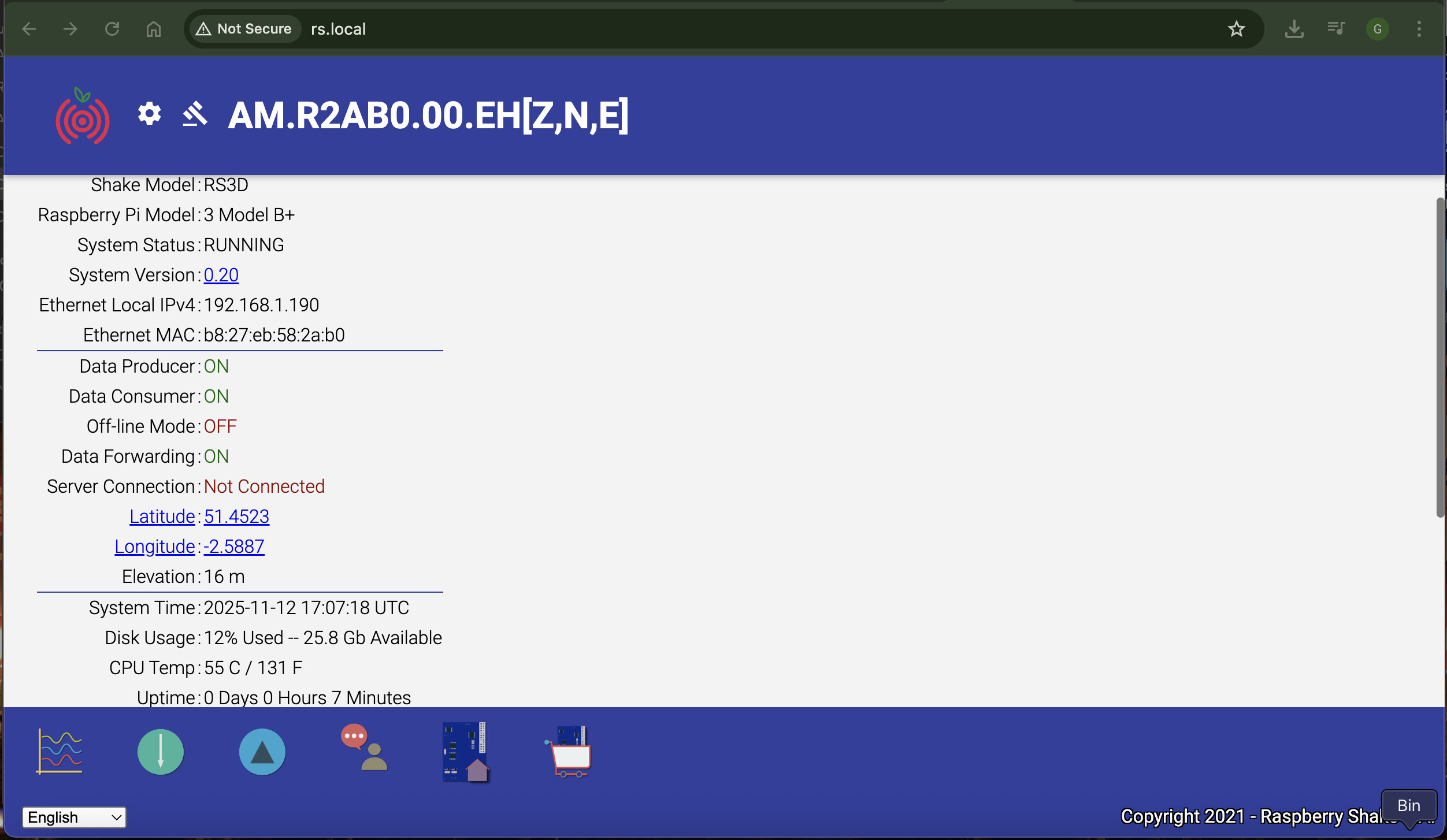

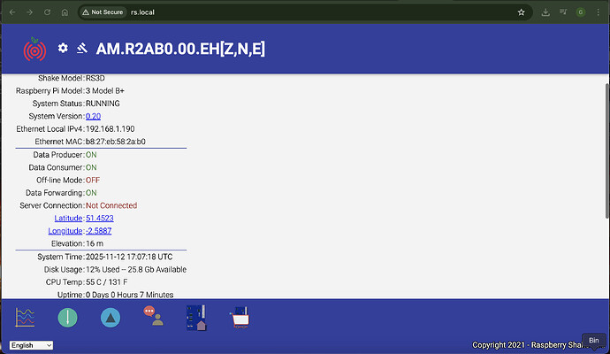

Hello grrodriguezp, and welcome to the community!
Thank you for the screenshot. Could I ask you to scroll down the same page, click on the orange button to download the logs from the Shake, and send the zipped file to me?

Hello,
Thank you for the logs, they were most informative about the situation.
Your Shake correctly boots up, gets an IP address from your router, and finds an internet connection. However, it cannot communicate with our servers:
