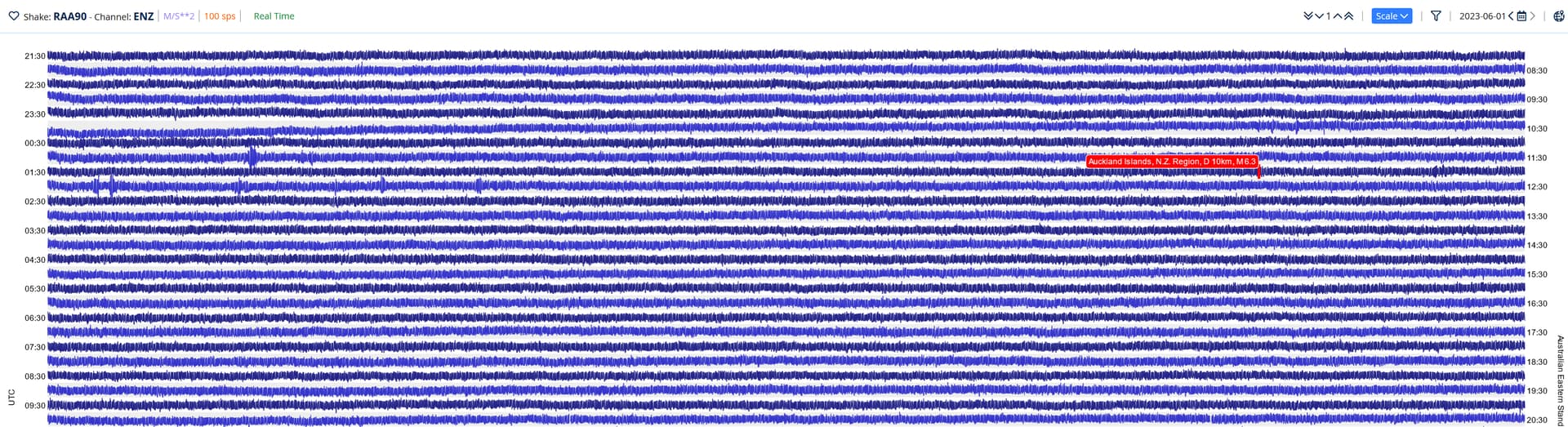

If you don’t live in such areas, I recommend the RS3D to complement the RSBOOM you already have. You will be able to study earthquake waves in a three-dimensional environment (instead of the single vertical one), even from distant events. For example, with my RS3D, I can pick M6 and above from the other side of the world (~15-17000 km away) together with M2-3 local events.
I also have paired it with an RSBOOM, and this combo definitely provides an efficient solution to monitor both atmospheric events (such as strong cyclones and storms) together with near and far earthquakes.
