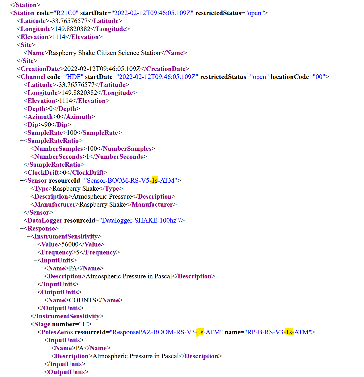

I just recently changed my RS&B over to the 20s filter. I have changed the filter selction in the RS.LOCAL settings as well.
I was curious to see if it might be possible to tell if a Boom or S&B had the 20s filter installed from the inventory command, so had a look in the metadata for my station. I can’t see any information in the metadata that would tell me if the boom had a 20s filter, however, the resourceID data quotes “1s” which I assume would refer to the 1s filter. See the screen shot below:
Should this now be showing “20s” instead of “1s” now that I have the 20s filter installed? … or am i misinterpreting this?
Al.
It looks like the metadata hasn’t updated since the restart at 22/02/12 09:46:05.
Should it have created a new epoch when I restarted with the 20s filter, or is that not a significant enough change to warrant it?
Al.
OK… I checked on another S&B and found it’s resourceID contained 20s, so I think my hypothesis that the 1s is 1 second and 20s is 20 second filters looks good.
I just saved and restarted the RS&B again and still the epoch did not update/change - it still says 1s, and the date of the start of the epoch hasn’t changed.
Al.
mine:
there is a setup screen somewhere in which you can indicate the filter installed.
that should change the instrument response XML file
Ken
Yes, I know. Been there and done it twice just to test.
It doesn’t change the metafile, so I assume it’s either a bug or not considered a significant enough change to warrant a change to the metafile on it’s own.
Al.
