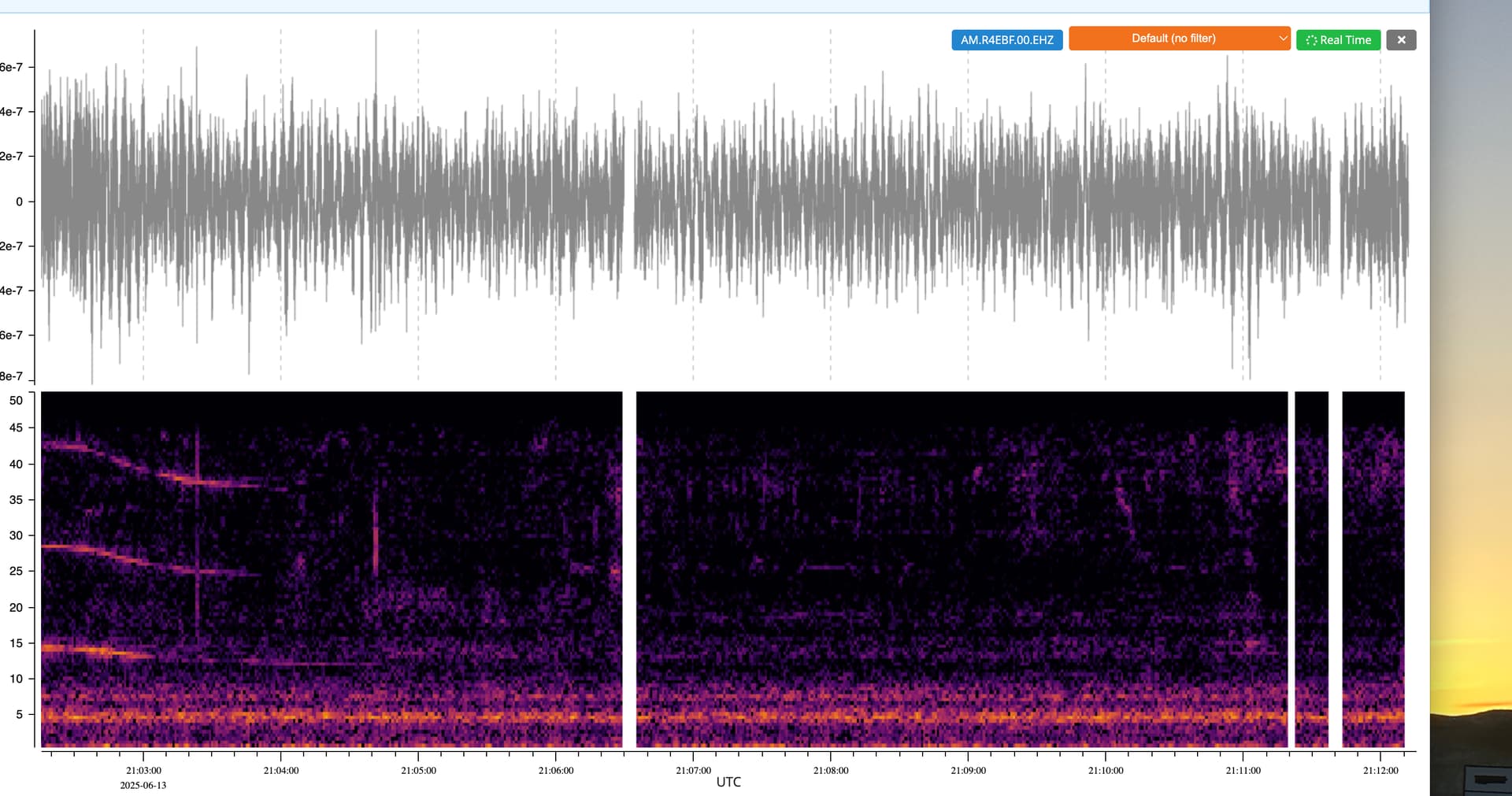

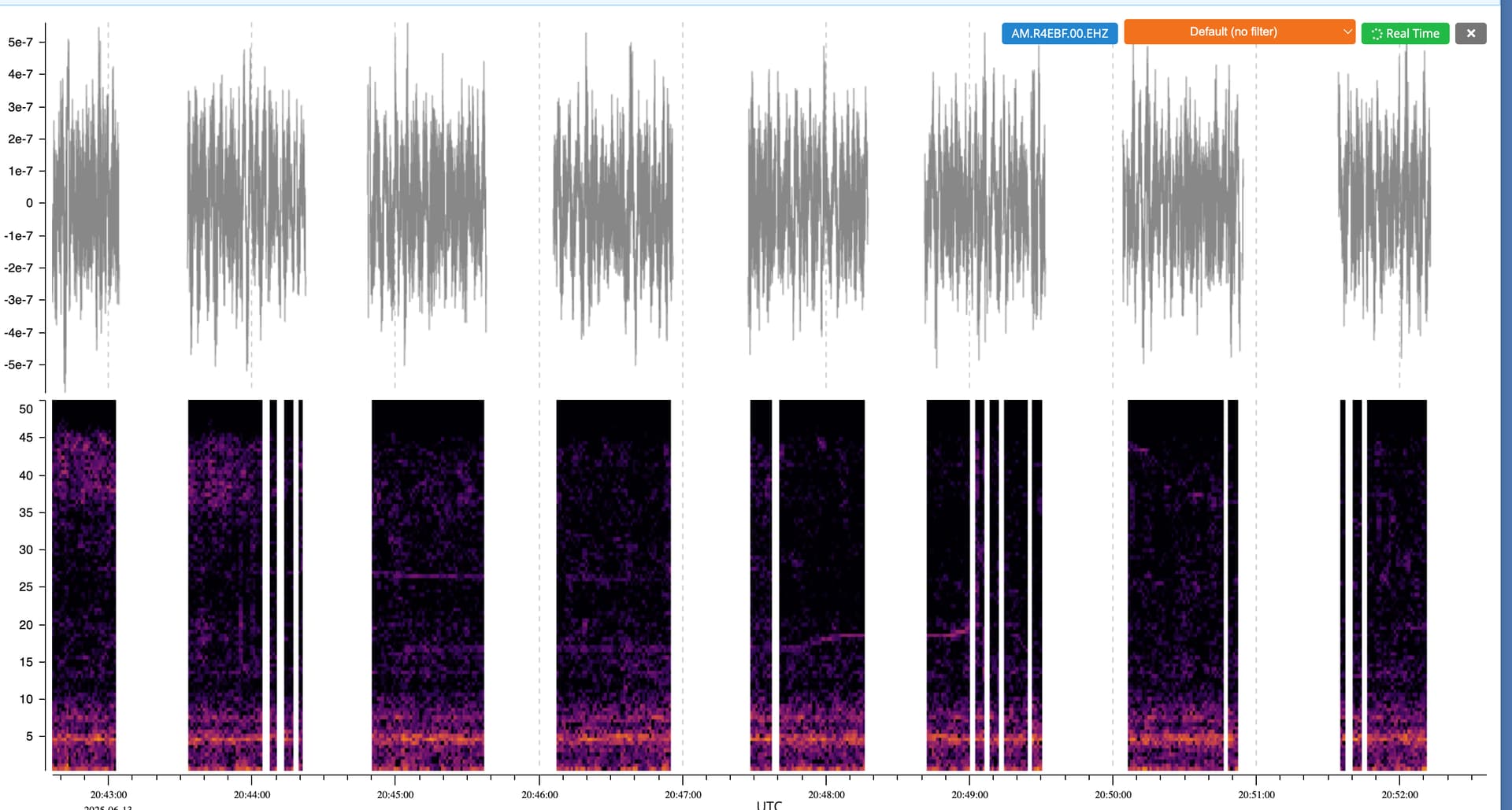

Hello, my 3D has been running great for a couple of years, it just started skipping in the feed today, could some out review the logs? I did replace the power supply on it a few months ago but have not done anything else since I first set it up. Network is solid to the device.

Shutdown the pi, reconnected everything, and started back up, feed is somewhat better now but still has drops.
Hello taylorad,
Yes, compared to before, the situation has greatly improved. As of this (UTC) morning, I can see that some gaps are still there, but much less frequent and not as regular as they were.

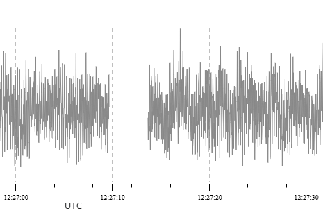

Yes, all those undervoltage events match the interruptions you can see on both StationView and DataView. For example, this is the 12:27 one:
