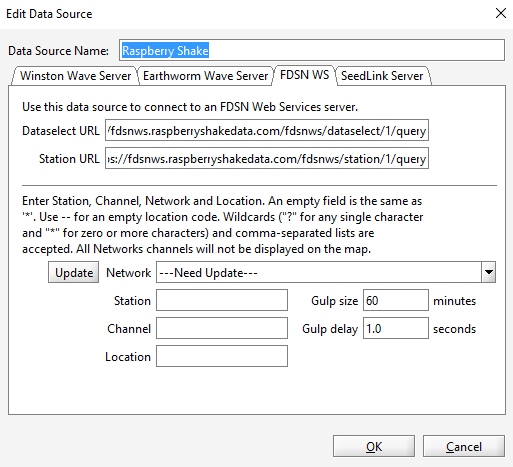

When I open SWARM I get my own data feeds but the RS Community feed does not seem to appear or connect?
Hello satredfern,
This is quite strange, but, nonetheless, I will give you my setup that is working fine as of now.
To access this panel you should click on the second button in the Data Chooser window (that you have already opened on the left), which says Edit Data Source.
Once in, you navitage to the FDSN WS tab and then insert the following in the two fields.
Dataselect URL: https://fdsnws.raspberryshakedata.com/fdsnws/dataselect/1/query
Station URL: https://fdsnws.raspberryshakedata.com/fdsnws/station/1/query
This should help you in displaying all the Shakes in the AM network.
that solved the problem, but only after I pressed the “update” button!
Thanks
