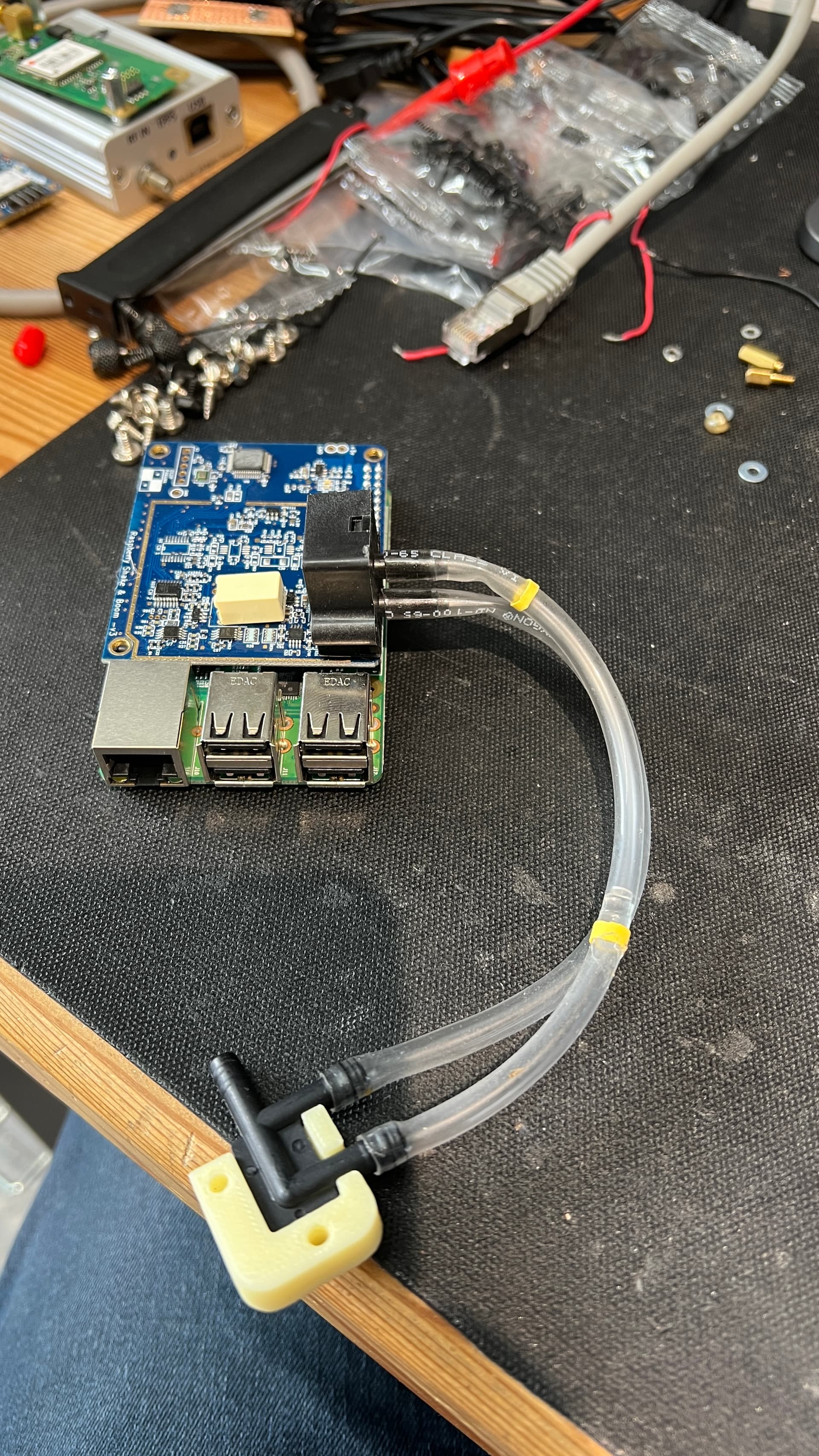

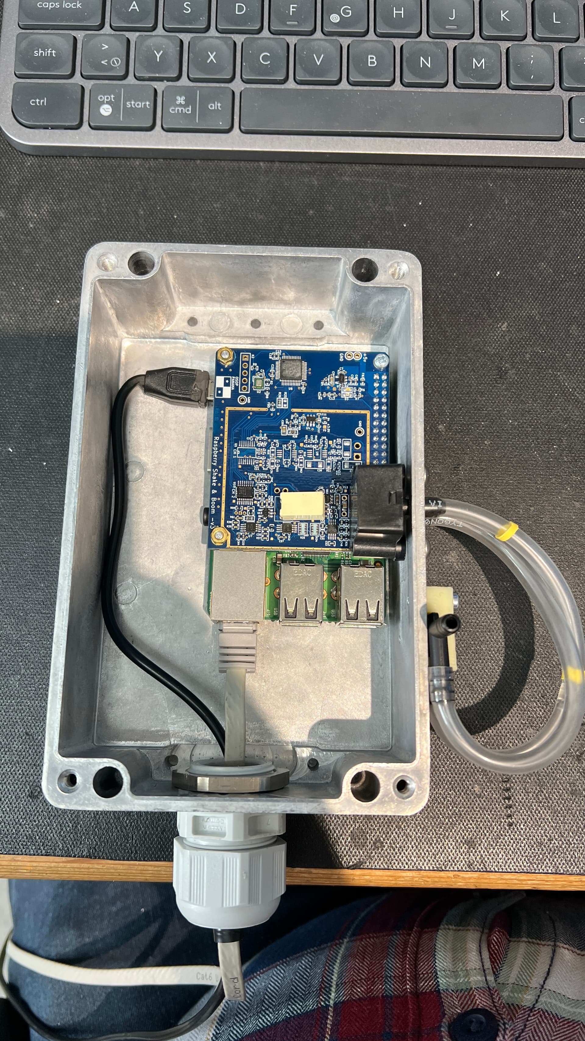

The SD card change process has been done, because the Shake did not responded anymore. So I decided to swap both cards, on the Shake and Boom.
The funny part, Shake was using a Kingston industrial grade and the Boom a “cheap” consumer grade HP card.
Now I use two brand new Kingston industrial grade cards and both devices are 1:1.
I configured the ntp.conf for my network and changed also the hostnames to shake and boom. This helps, if I am running more than two terminal sessions :wink:

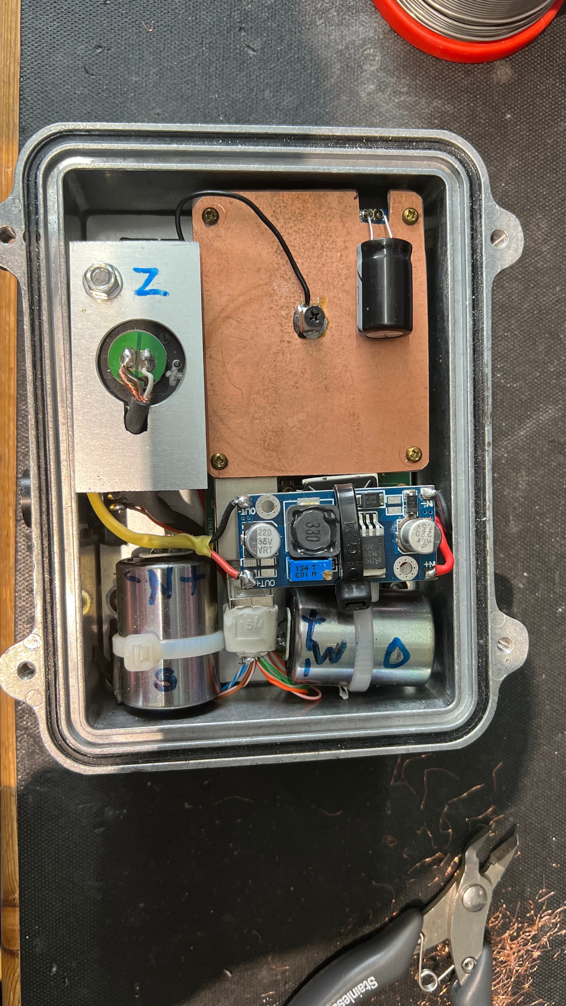

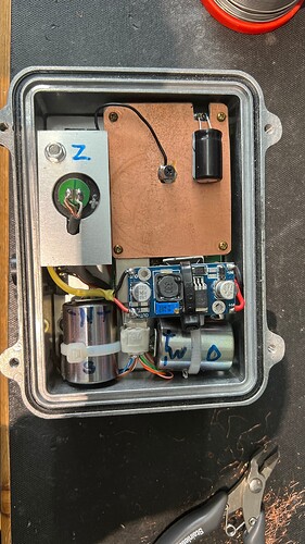

I also made two further modifications:
Shake:
Mounted a single-sided copper-clad laminate to protect the AD converter from RF of the DC/DC converter.
Boom:
Took it out of the Plexi housing and mounted it into a fully metal housing. This will keep all the small animals out and the tubes will hopefully no longer be bended.
