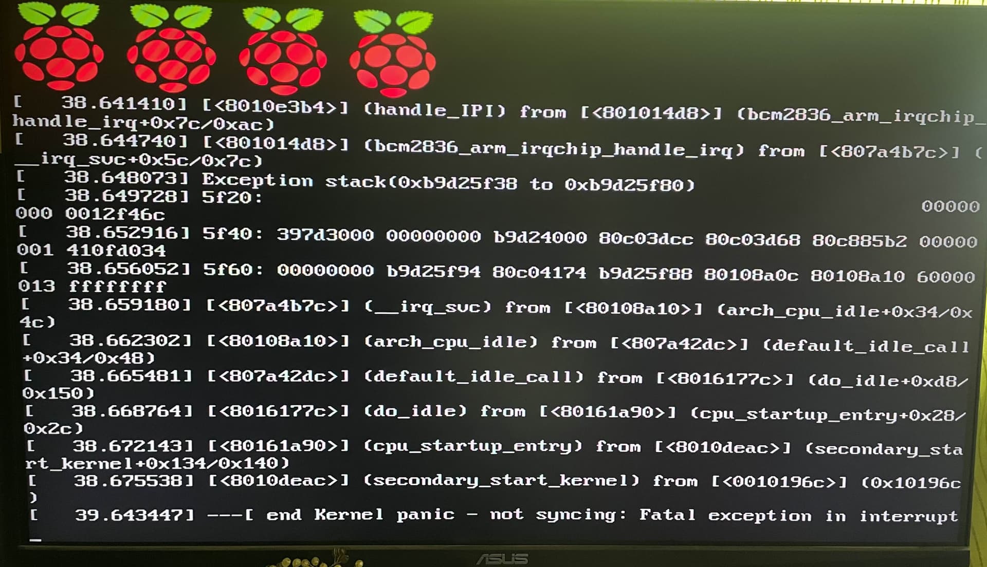

The second-to-last picture you posted gives insight into what could be a Pi CPU problem, particularly the last three lines:
cpu_startup_entry
secondary_start_kernel
end Kernel panic
This specific sequence shows that as soon as the CPU starts to “get to work”, something happens, and it rapidly degenerates into the Fatal exceptions you are seeing.
This is also (very likely) why the microSD cards keep getting corrupted, as higher-level processes are performing incorrectly.
I do not recall if we have tried this, but do you have a spare Raspberry Pi 3 or 4 board (even borrowing one) that you can try to swap? If you require instructions on how to disassemble/reassemble your Shake, you can find dedicated videos here.
If you can get your hands on one, and perform the swap, it would be interesting to see if the same exceptions persist with a new Pi board and a freshly burned microSD card, or if that was the root cause of what you are experiencing.
Let us know.
Hi Stormchaser! Thanks for reaching out again and taking my case. Yes. The “end kernel panic” occurred again with a new microSD card. It happens with all of them, so it’s most likely a Pi CPU problem. I don’t have a spare Raspberry Pi 3 or 4 board to replace it. Do you know where I can get one? If you know, I’d appreciate your help with that.
