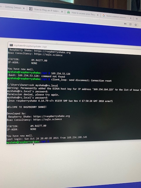

Hello all, I managed to ping it via command prompt line when it was attached to my computer via ethernet, I changed my SSH password and logged on, but don’t know what to do next ?

Hello grazhobart,
Thank you for the new logs and the screenshots. I can see that you successfully managed to connect on a local network with your computer, great work!
You can see if the Shake is now recording data by clicking on the current Helicorder display (the first icon in the bottom bar) and then clicking on the appropriate day/time link in the page that appears after that.
From what I can see, there should be any problem in this. Naturally, since you are connected directly to your computer, there is no outgoing general internet connection. For that, you will have to disconnect the Shake from the PC, and try again with your modem/router, to see that:
- the Shake is seen in your local network and is correctly assigned an IP address, and
- that you can access
rs.local/
from a PC connected to the same local network.
After that, all that remains is to manage other issues if the Shake still displays a “Not Connected” status. But we can get there one step at the time.
