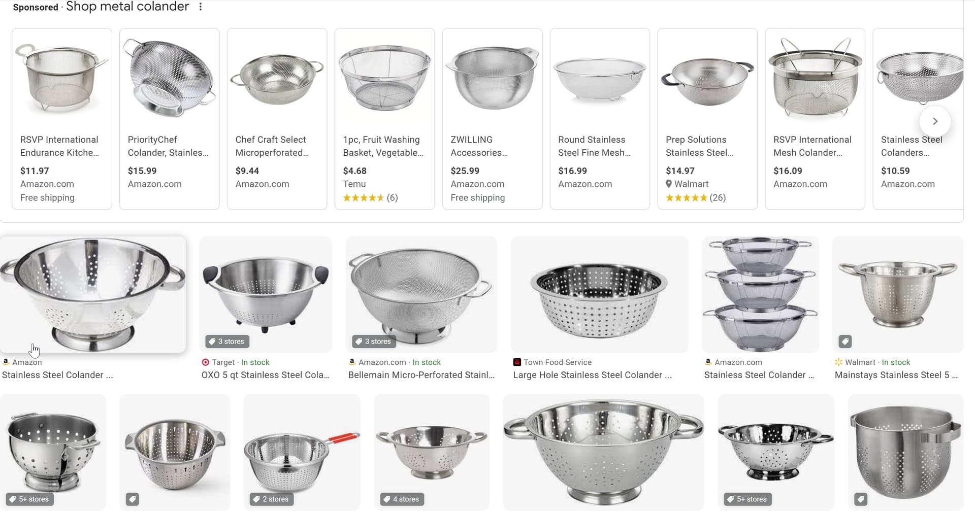

Adding on to Philip’s suggestion. I would fasten the RShake to the concrete and then add a metal colander/strainer over it. There are many sizes and styles that might work for your situation. You would get plenty of ventilation and not have to worry about any heat build-up.
Some examples are shown in the attached image. You can modify them for cabling. A weight on top might hold it in place. Hot glue or caulking might also work. Basically, strong enough to hold it in place, but not make it hard to remove for access to the RShake.
As both Philip and Steve have already shared, I also recommend ensuring good ventilation around the Shake to avoid overheating problems for your instrument.
Their solutions are very good and should provide good enough protection against the local rodent population. In any case, I would keep an eye on things as mice can be really resourceful.
If you have any other question(s), I remain available.
I think my money box is a little small so I’m going to use the collander idea once I relocate it. We’re in the Scottish countryside so there’s little escape from the field mice who chew whatever plastic is in their path.
