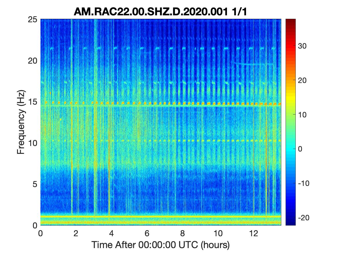

Does anyone have any experience with power line conditioners used with Raspberry Shakes? Attached is a spectrogram from my Shake and as you can see there is a lot of interference. These are at frequencies that are below those of any mechanical systems in the house. I can only assume that they are coming across the power line. I do have an inexpensive power strip conditioner in the system but I was looking for something better. Any specific recommendations considered.

Viewed in a close-in time frame, the higher frequency noises don’t look that unusual. Heat pump compressors (yours and your neighbors) often run in the 15-45 Hz range and vehicular noises show up there too.
One thing I see intermittently is a “ticking” right down to the baseline. This is possibly associated with your ethernet connection.
There are several ways your ethernet comm port can induce a signal into the geophone signal (discussed in other postings).
The really damaging one is the band of noise around 1 Hz.
It’s possible this is caused by a bad voltage regulator in your 5 volt power supply or the 3.3 volt regulator on the RPI itself - both easily checked by substitution with another unit.
Ken

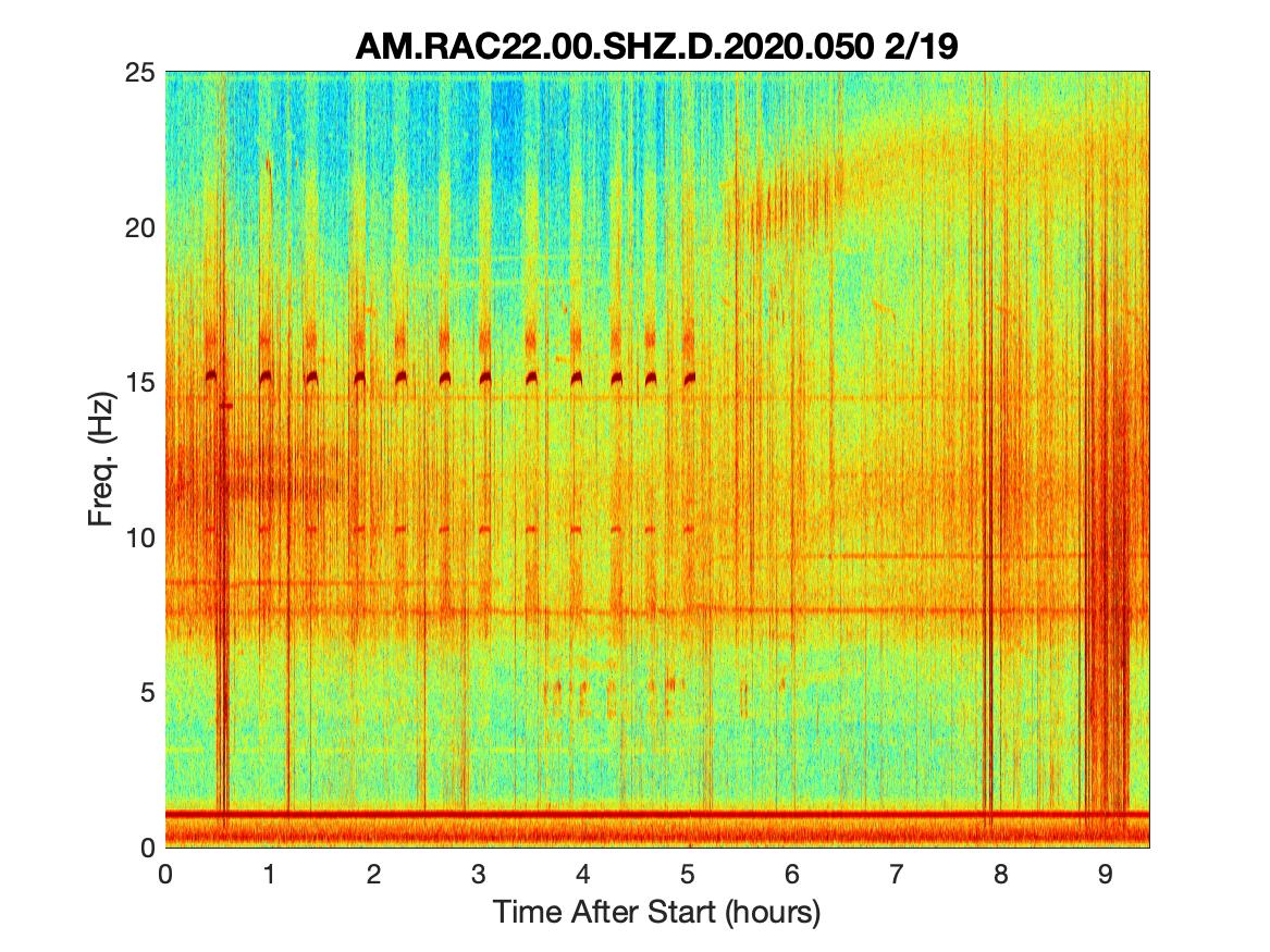

Tried a different wall plug, though not sure if the circuit is different. Still that sporadic transient noise from 0 to 5 hours. MY Shake is three years old and an old SHZ, probably time to upgrade to a 3C EHZ.
For me, that pattern from 0-5 hours is clearly the signature of a two-speed heat pump compressor. I would be more concerned with the lack of quiet in the 0.7-2.0 Hz range - that is where the majority of your teleseismic events will show up.
