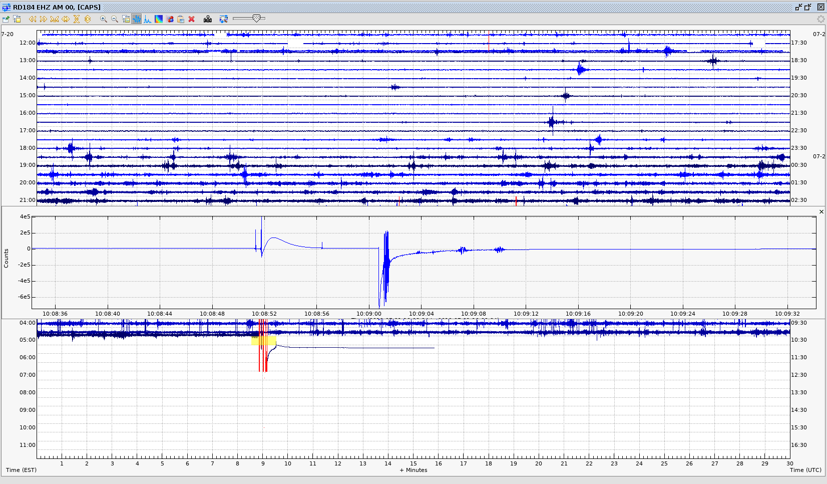

I’m facing new problem with RD184, where signals are continuously ringing. No earthquake recording and no signal even jumping nearby the station. I think there should be some problem with the sensor. Look at the waveform and it would be great if you suggest me to solve the problem.

Something happened to the Shake on July 21st at 10:08 UTC (looks like violent Shaking to me):
Immediately after (and for all days since), it appears there is no longer a sensor attached to the board (I can tell this from the low amplitudes and general unresponsiveness to cultural noise and real seismic signal):
Yours, branden & ian

In the end, if the problem is mechanical (like someone picked it up and threw it at the ground or dropped it), this will probably require visiting the station to investigate what is broken. Maybe you can have them send you photos? You might have to ship it back to us.
