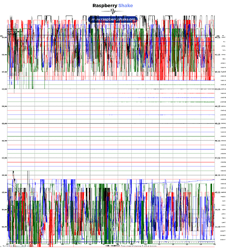

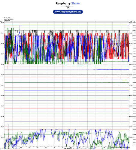

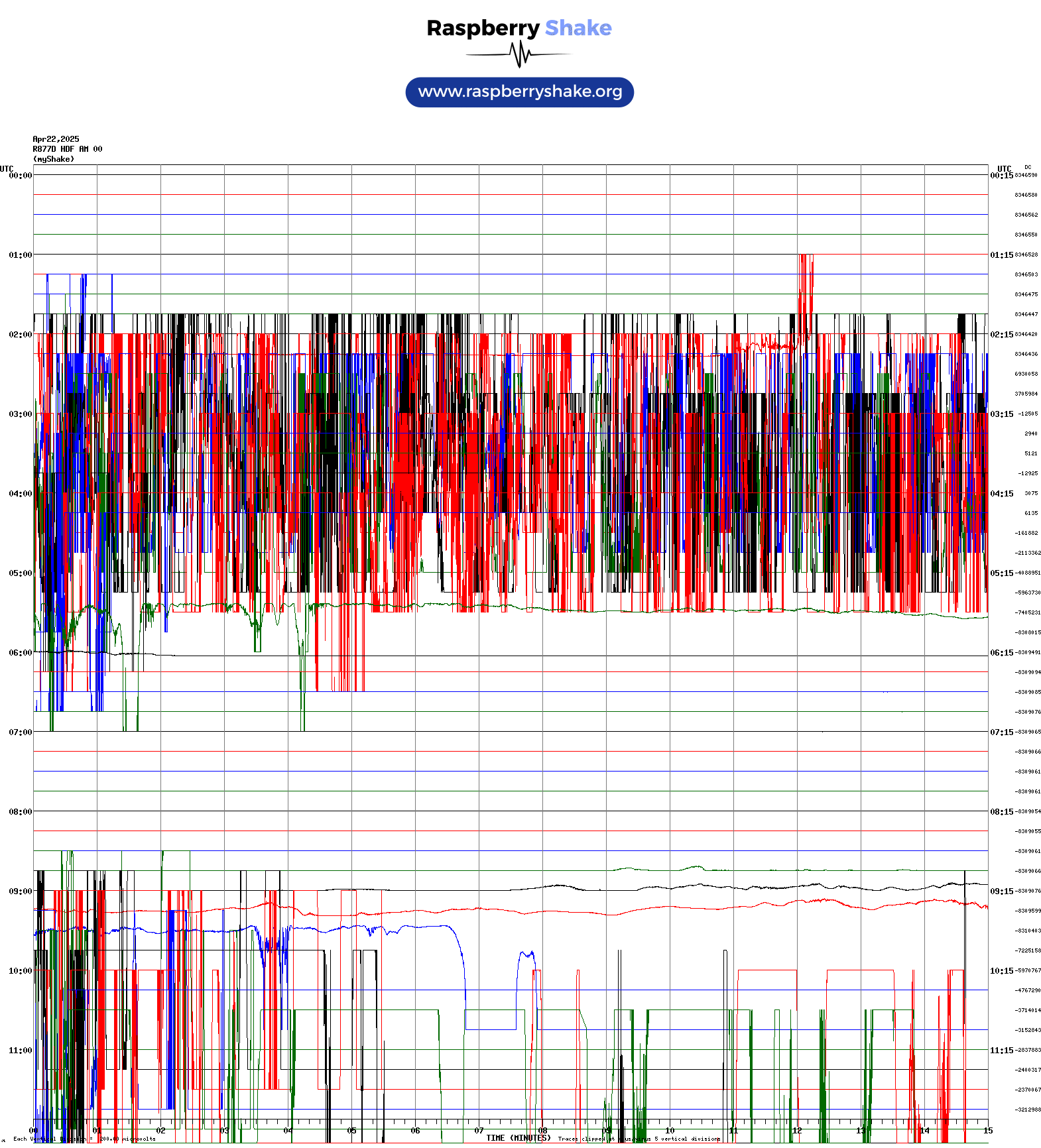

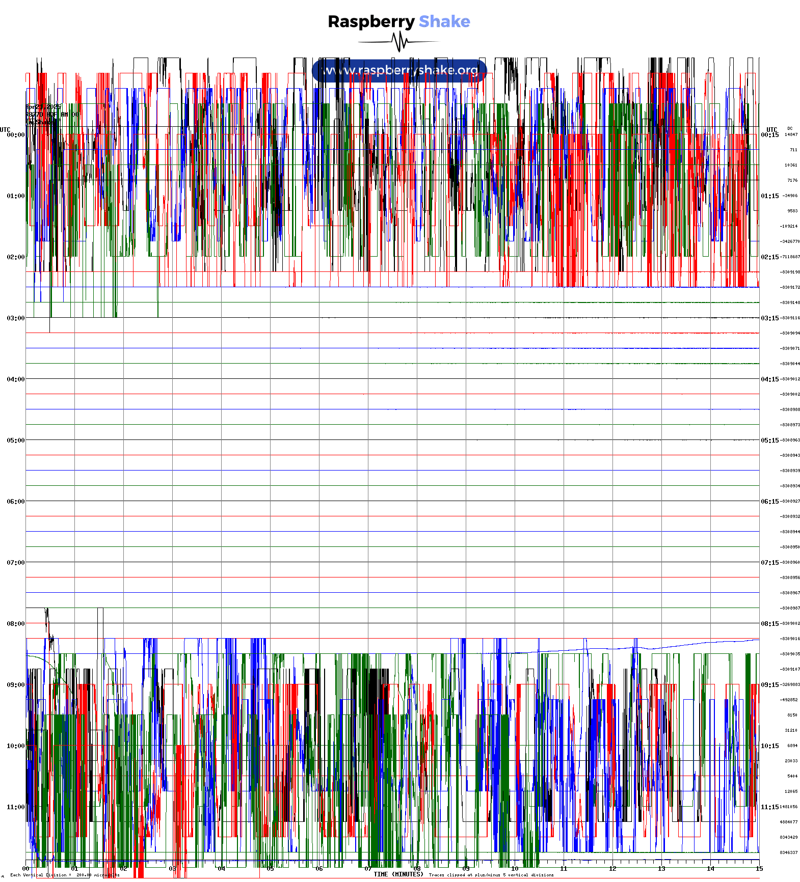

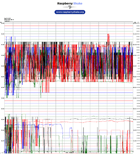

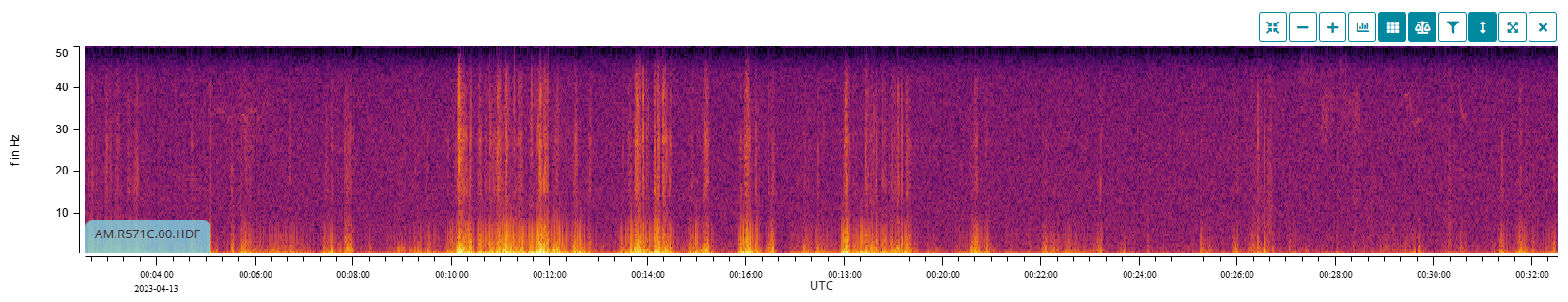

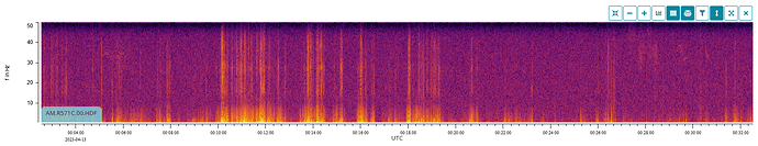

When I started using the BOOM in 2021, as R571C_HDF, the helicord just looked like noise 24/7. Most probably I didn’t report this as I assumed this was what it looked like (the Shake was good).

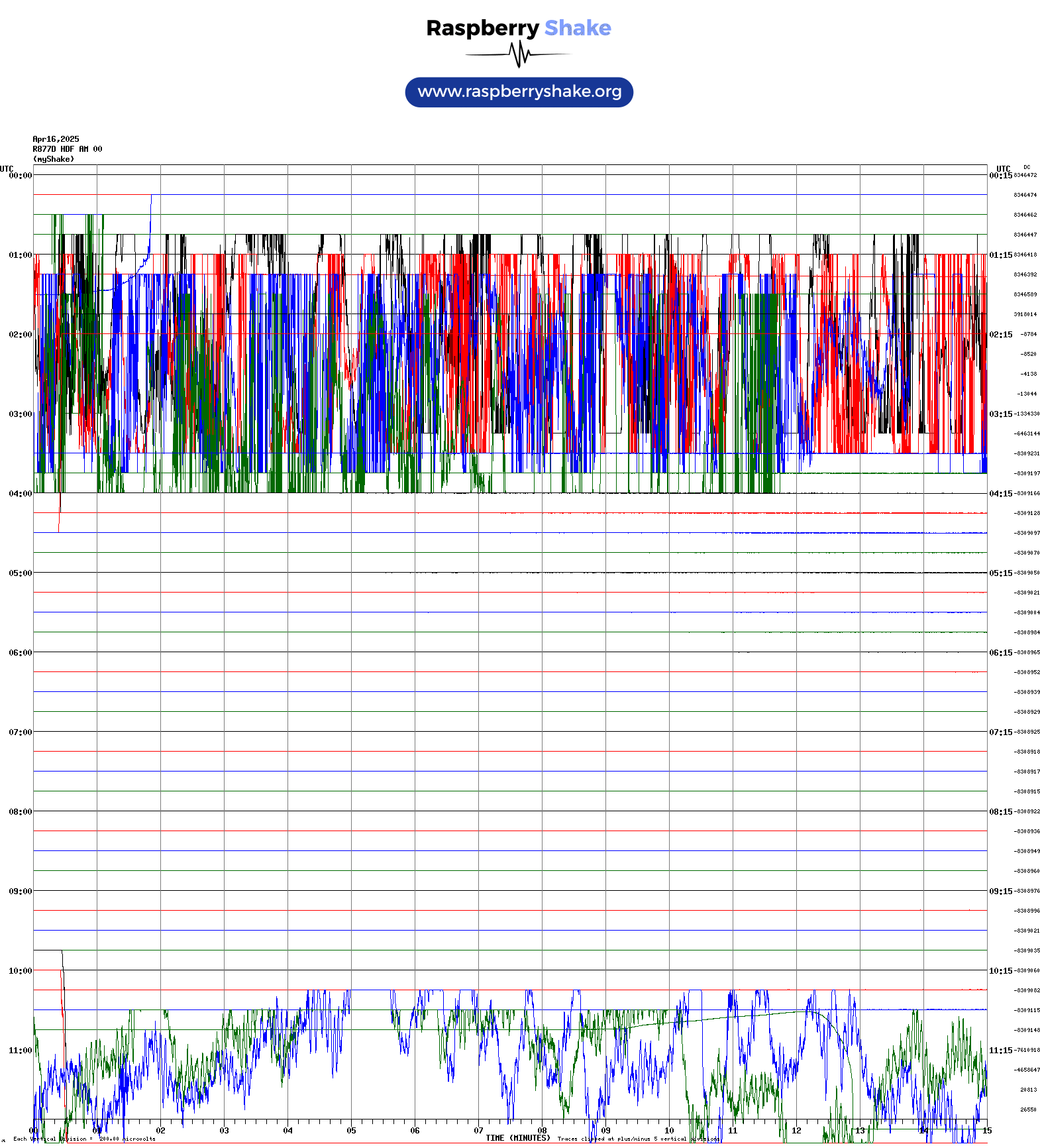

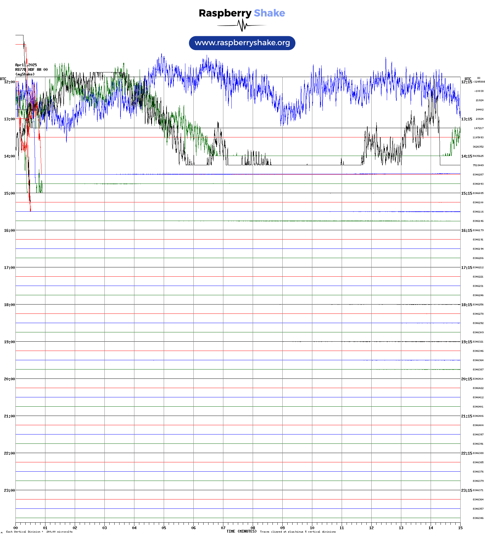

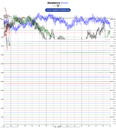

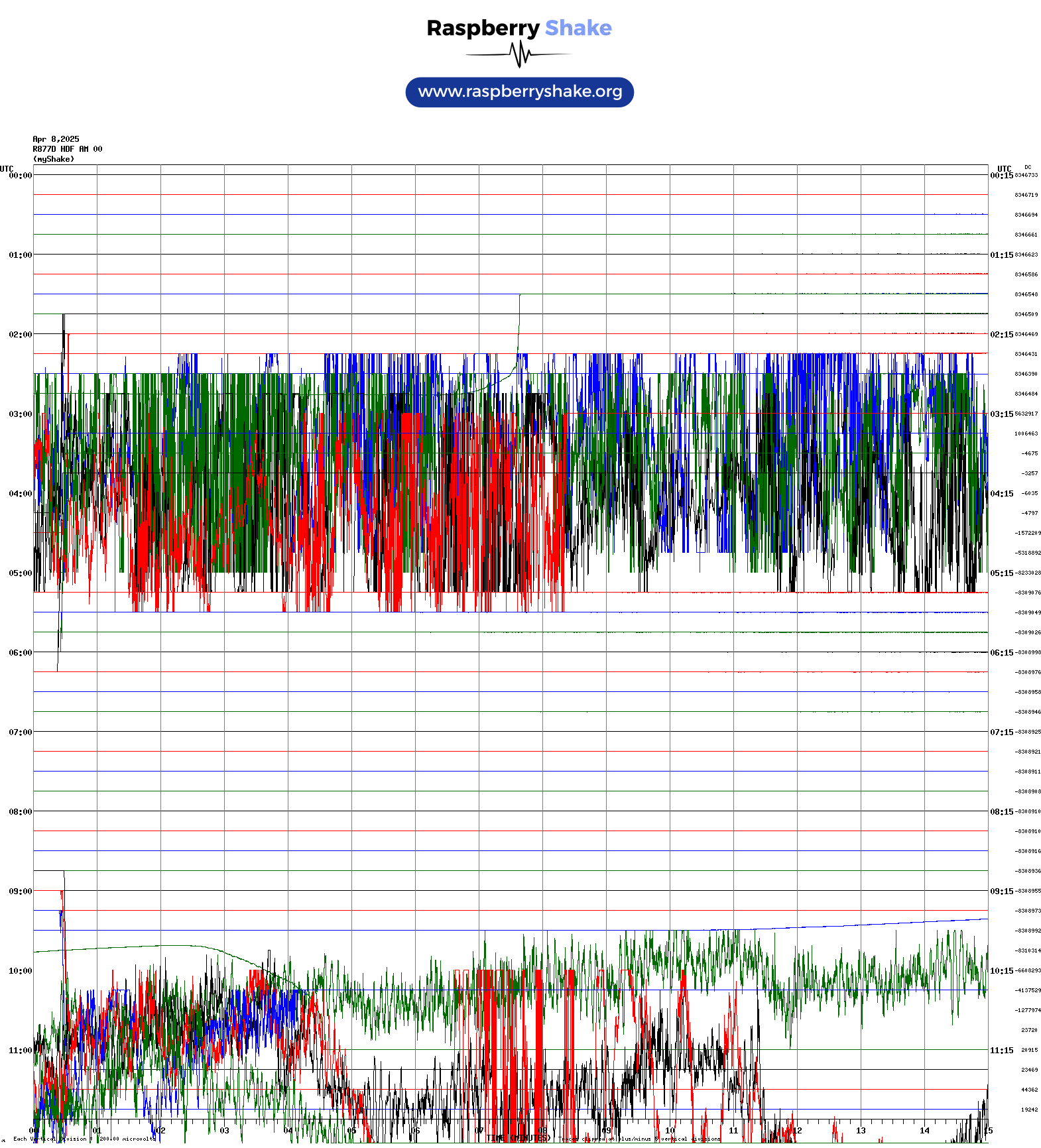

More recently, operating as R877D_HDF, the BOOM started to show long periods of low noise (flat lines on the helicord), but had periods of noise and random drifts on the helicord. These tended to occur in blocks of a few hours and typically at similar times.
A couple of days ago there was a fireball that was recorded on a couple of BOOMs at greater distance from the event than mine, but my trace was swamped by one of these periods of noise. By this time, the periods of flat lining on the helicord had shown me there was an issue, but I never got around to requesting any assistance as to the issue. If it is a source external to the unit, it is nothing associated with activity on my property.
Attached are the current logfiles, some old logfiles from a time when the helicord was all noise, and a few recent helicords.

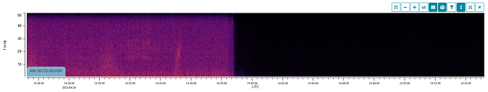

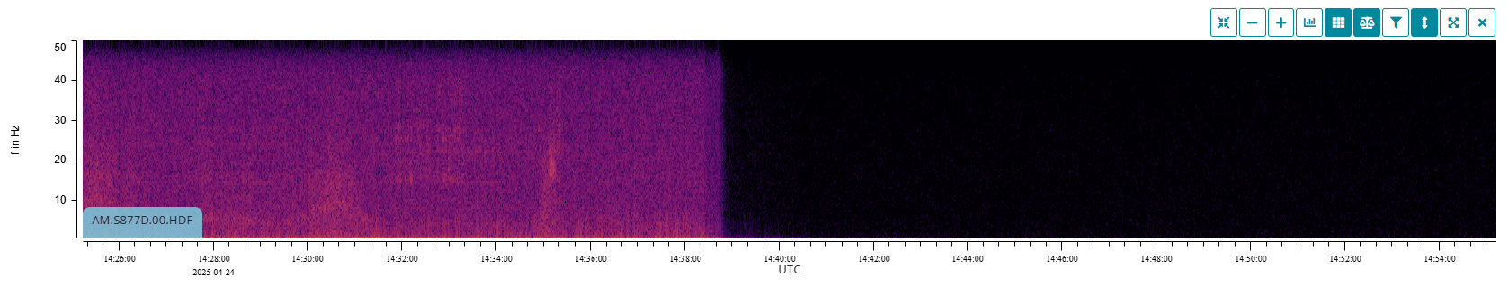

Thank you for providing the detailed feedback, the logs, and the screenshots from the infrasound sensor.
Indeed, there are some periods in which everything is working perfectly fine
And then the output translates to nothing, as shown below:
From your logs (in both sets), these lines indicate the possible cause of the issue:
2025 112 18:48:50>>	No Data has been received from the MCU in 12 read attempts.It appears the MCU is not transmitting data.  This is a fatal condition and should be investigated if this condition persists!
