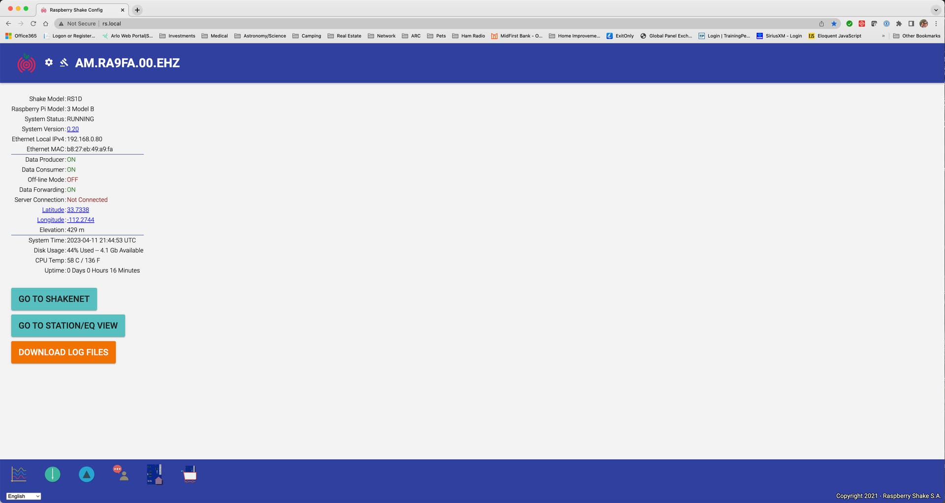

My Shake recently stopped connection to the network. I have attached a screenshot from the Dashboard and a copy of the downloaded log file.
Thanks…Doug

From them, there is a clear connectivity problem with the Shake, highlighted by these lines:
2023 101 21:29:22: No internet connection found
2023 101 21:29:36: Unable to resolve hostname 'raspberryshake.net', most likely no DNS server available
