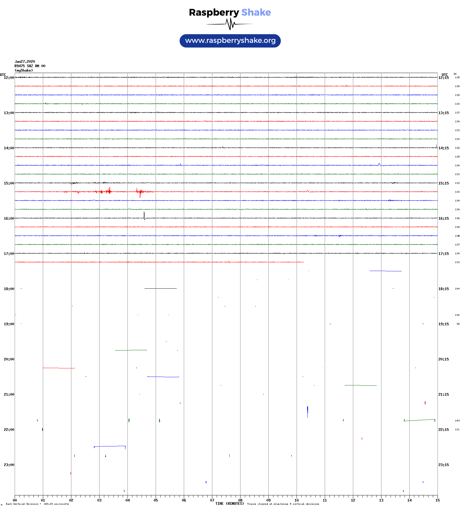

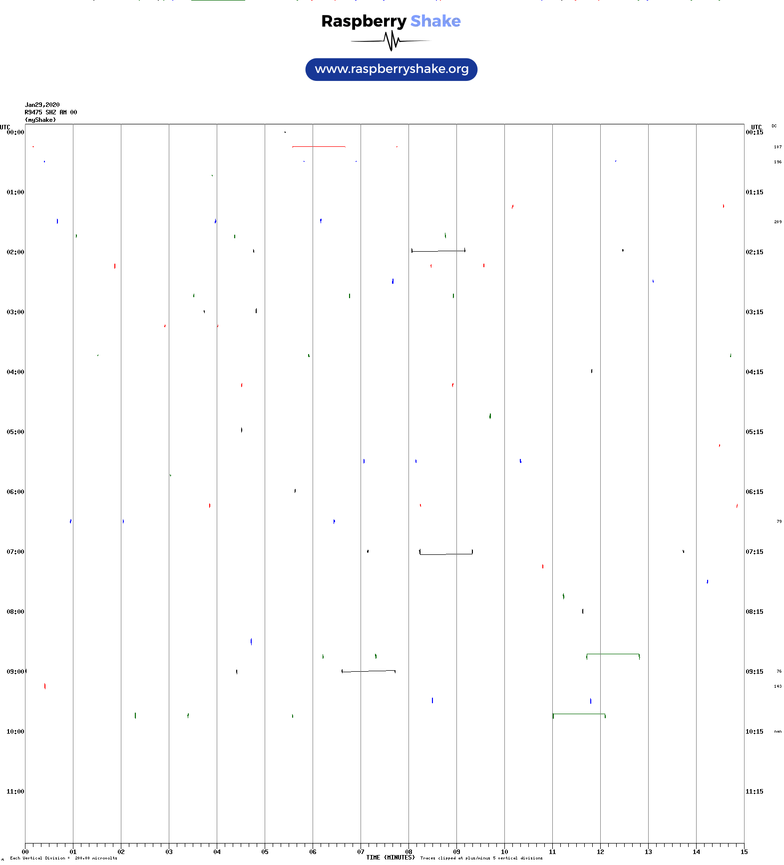

I have been operating a Shake 1D since the crowdfunding. It has stopped displaying data on the heliplots and has no connection to the SERVER.
Little activity on the shake board. Just one blue led.
Any recommendations on where to start troubleshooting would be appreciated.
