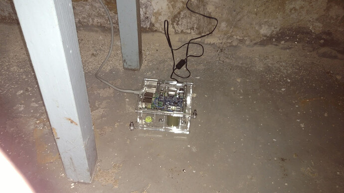

Here are a couple photos of the first unit I installed back in 2017 (RCB43):
If you have any further questions let us know!
