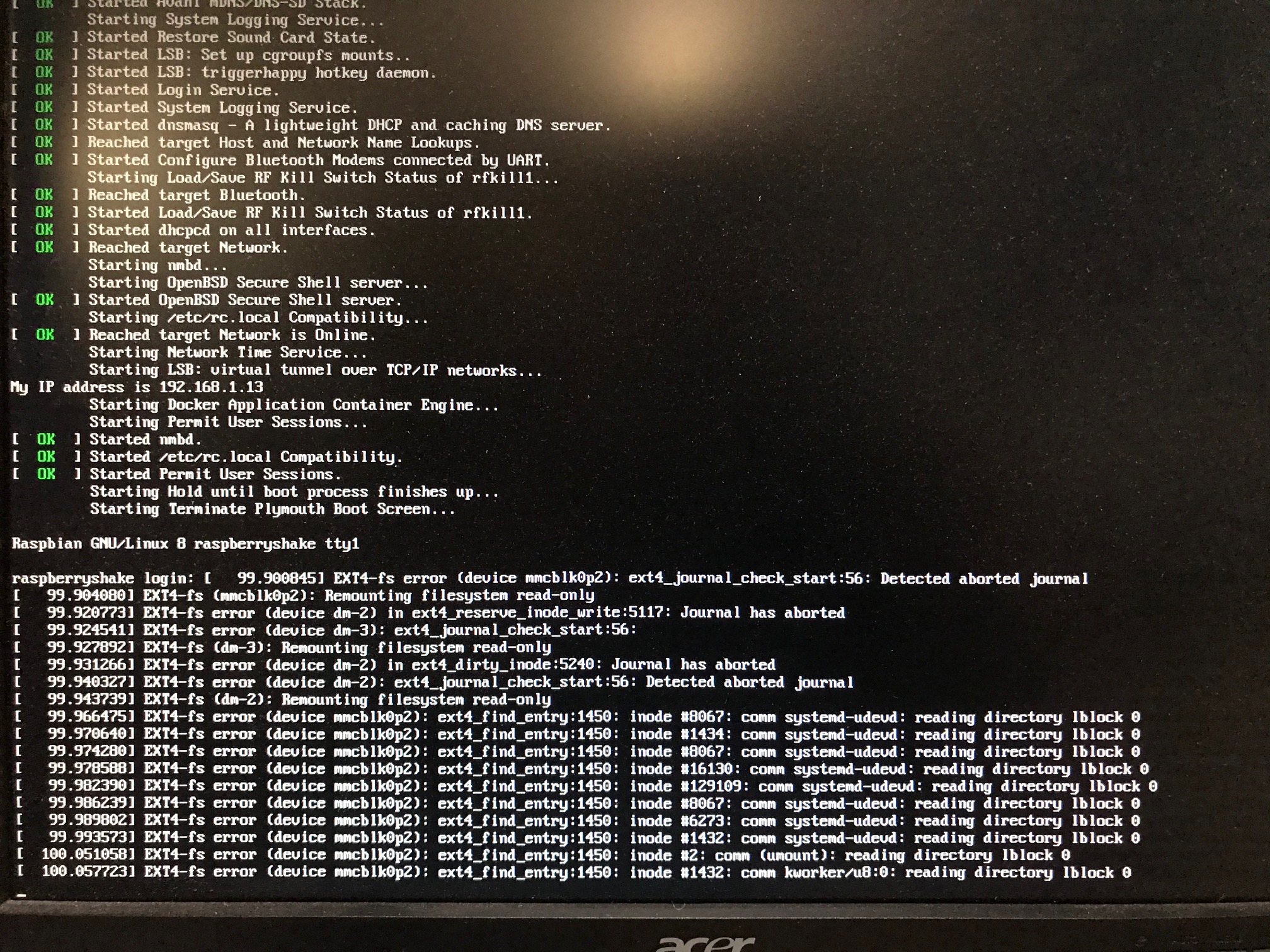

I unplug my Shake, put on a table and hook up monitor and mouse.
I watch it boot up., Seems to boot fine but after it gets to the Login and waits a few minutes I start seeing the attached errors start to accumulate.
I am presuming the original 8GB boot/memory card from the fully built 2016 Kickstarter unit has failed…

Hello Tom, welcome to the community!
Yes, from the situation you are describing (and thank you for the details), it seems that the microSD card has failed, or there are some corrupted files on it that are now preventing the Shake for working properly.
You can try to re-burn the old one, or if this still doesn’t work, you can acquire a new one (both 16GB, or 32GB are fine) and burn it with our Shake OS.

I had a monitor and mouse hooked up my Raspberry Shake which was on a work bench. I then inserted the SD card and watch the Shake boot. This time the Shake just stayed at the login prompt without producing errors.

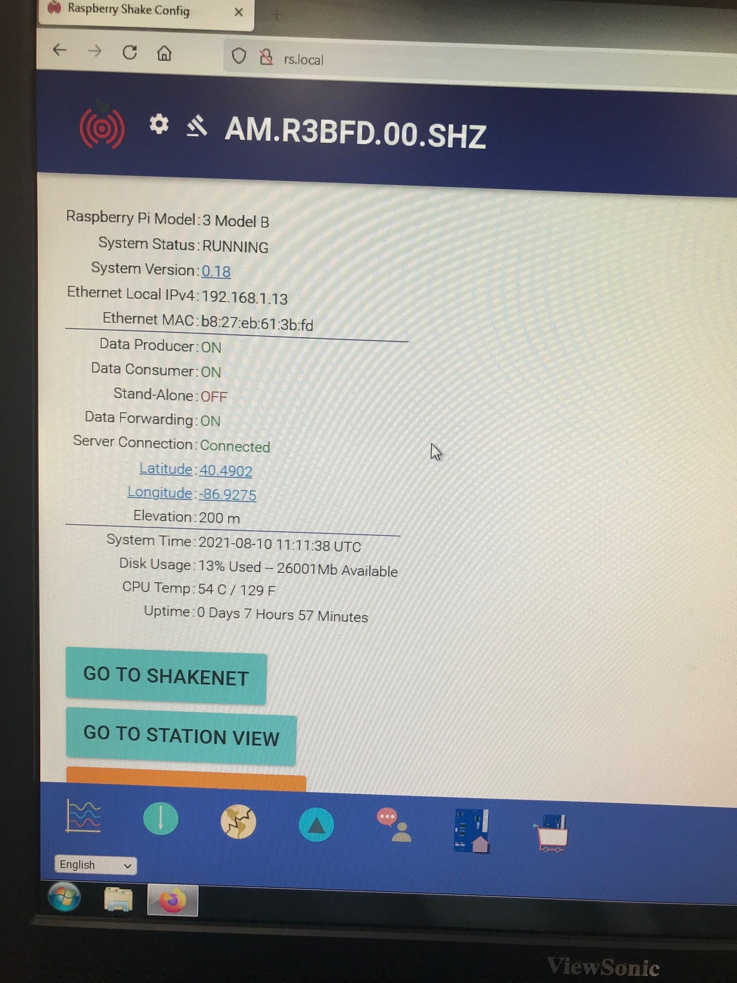

I then went to the PC, brought up FireFox and entered “http://rs.local” which brought up the Shake config screen. Finally progress.
I then changed the password on the Shake.
After reboot I went to network and changed to a static IP and used 192.168.1.13 with the DNS as 192.168.1.1

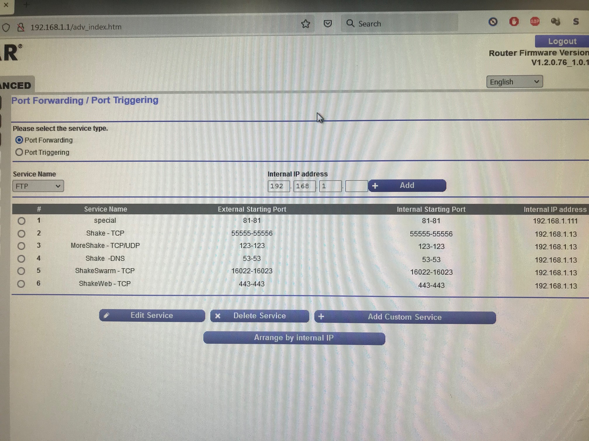

I changed my Netgear router settings for port forwarding to make sure but it had worked previously before…
I rebooted everything (cable modem, netgear router, Shake) and the Shake still would not connect.

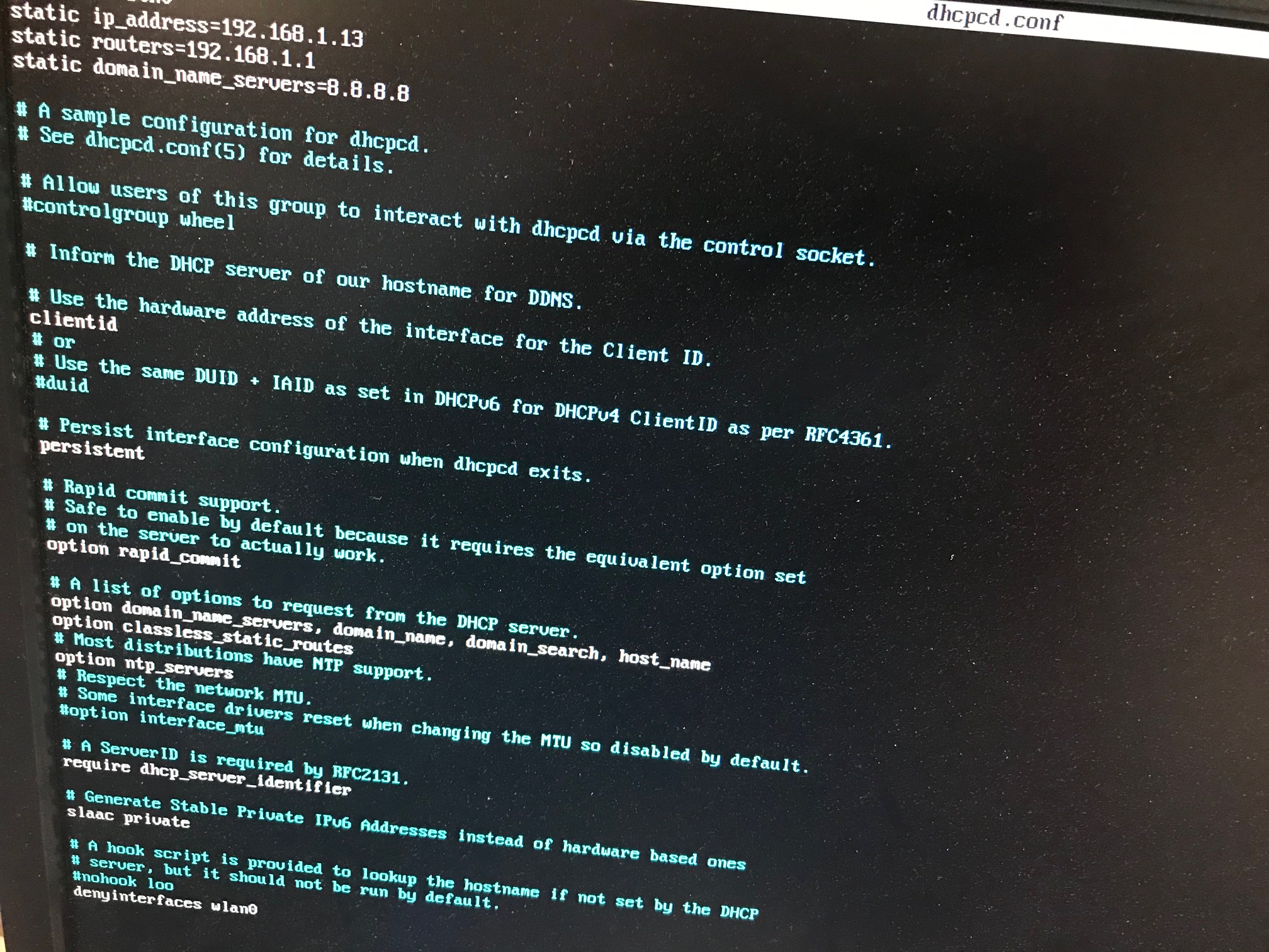

I had to dig around at work to find a USB Keyboard to bring home and attached to my Shake so I could look at config files directly
/etc/resolv.conf
/etc/dhcpcd.conf
What I had found by looking at “dhcpcd.conf” was that every time I used the “rs.local” to change the network it would make a new entry. I had around 15 entries with one right after another.
Static ip_address=192.168.1.13/
Static routers=
Static domain_name_servers=192.168.1.1
or various combinations.
What the key here is “192.168.1.13/” which appears to be caused by using the “Network” settings in “rs.local” seems to be adding a static address which adds a “/” to the conf file line.
I used “nano” from the Shake command line to edit the “dhcpcd.conf” file and change to …
I used “cntl-O” to save then “cntrl-X” exit.
I tried to reboot by command line but the user login of “myshake” does not appear to allow this. I instead pulled the power plug and plugged back in after 15 seconds. After reboot the “rs.local” shows…
So it appears to be successful however my Shake is not appearing on the Shaker net yet.

    it came with a 8gb Micro SD card. That card appears to have lasted 5 years before it basically ran out of memory space so it was generating write errors as it had no more room. I have replaced with a 32Gb card so it should last a little longer.
