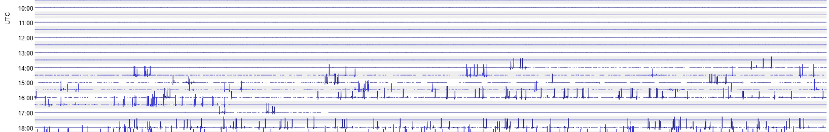

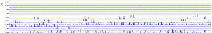

  • My observation site is no longer displayed on Station View
  • Since September 14, abnormal waveforms have been displayed in Data View on all channels, and there is no waveform displayed after September 18 (no data in /opt/data/archive/ after September 18).

Hello BuRi, thank you for the logs from your Shake.
I get what you mean; this transition on September 14th was definitely unusual:
In your logs, there are many timestamp-related errors, such as the following:
2024 261 08:40:53>>	Invalid timestamp for STN R9B32: ES: 1726567822.889
2024 261 08:40:53>>	R9B32: DP rejected due to detected errors, not forwarded.
2024 261 07:05:07>>	Time adjustment M0: HARD RESET.  This will result in a one-time time-tear.
2024 261 07:05:07>>	5.0: NTP Time (Init): NTP:	1726556706.900044441
As you have already done some troubleshooting (thanks for all the details!), I would directly recommend re-burning the microSD card again (or using a different microSD) after formatting and erasing all its data/partitions first (you can use DISKPART for this as it is very efficient), and see how the Shake behaves with the newly installed system, removing potential issues derived from corrupted files.
