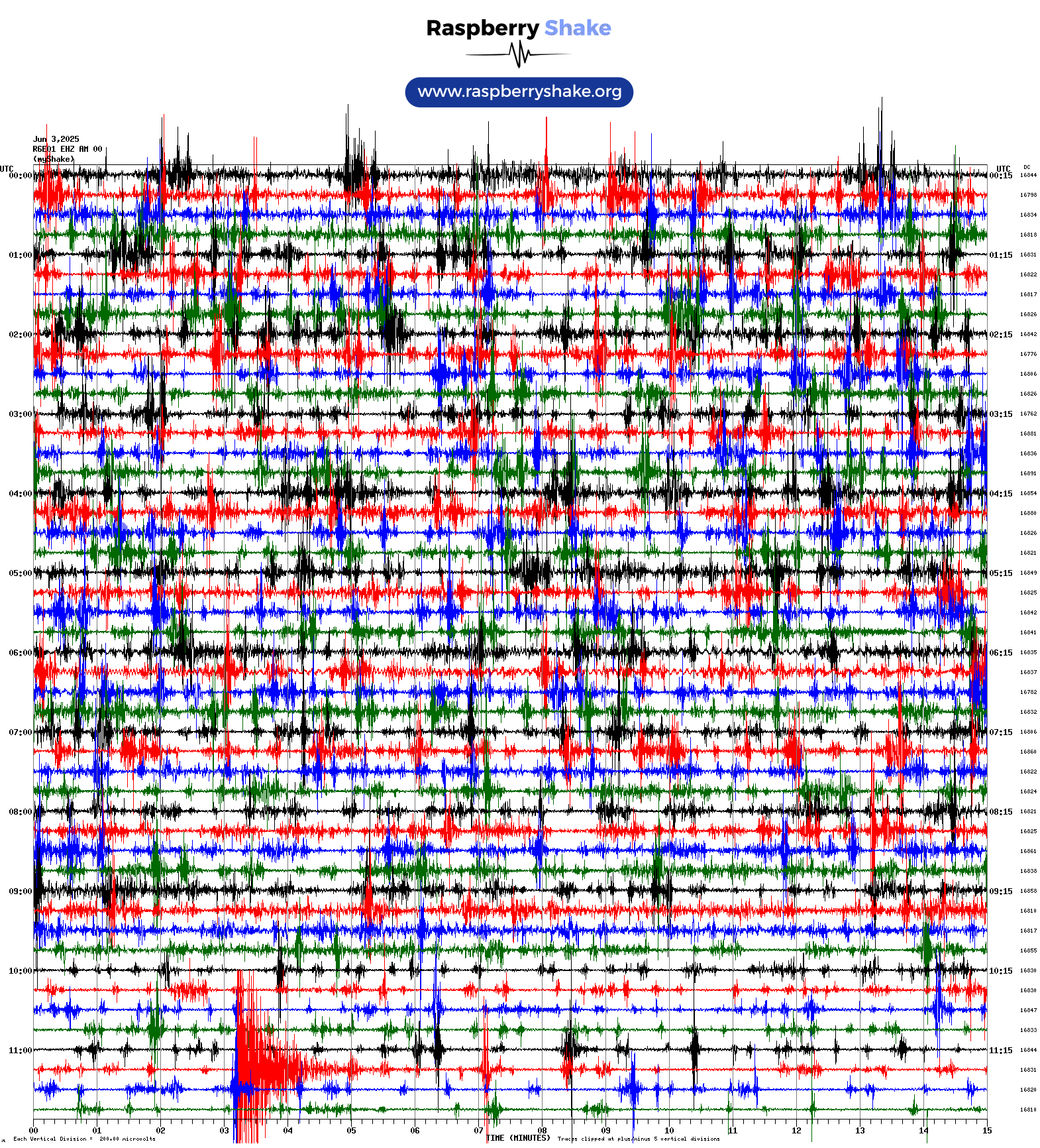

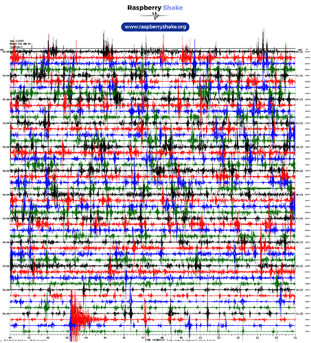

A Magnitude 4.5 earthquake recently occurred near my station (117 km away).

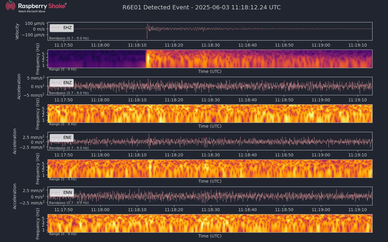

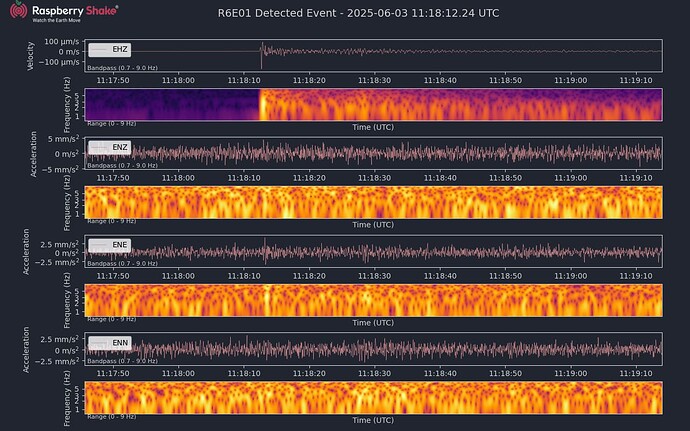

When I checked StationView, the waveform data for the moment of the earthquake appears to be missing. However, the data seems to be present in the Helicorder and in the RSUDP output. This leads me to believe the issue might be specific to StationView and EventView.
