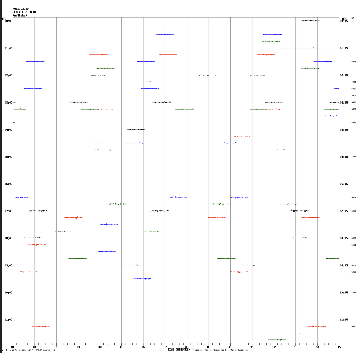

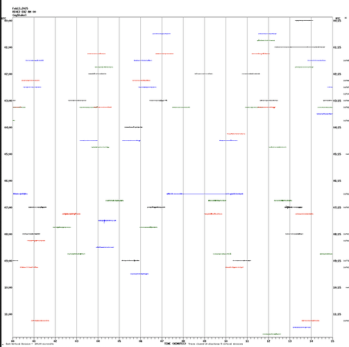

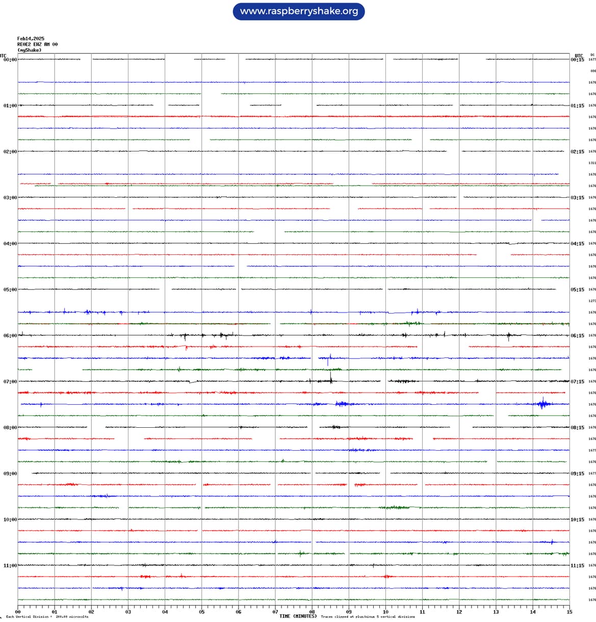

About the helicorder, they look like thatâŚ
Except today, that seems a little bit better but not totaly complete.
