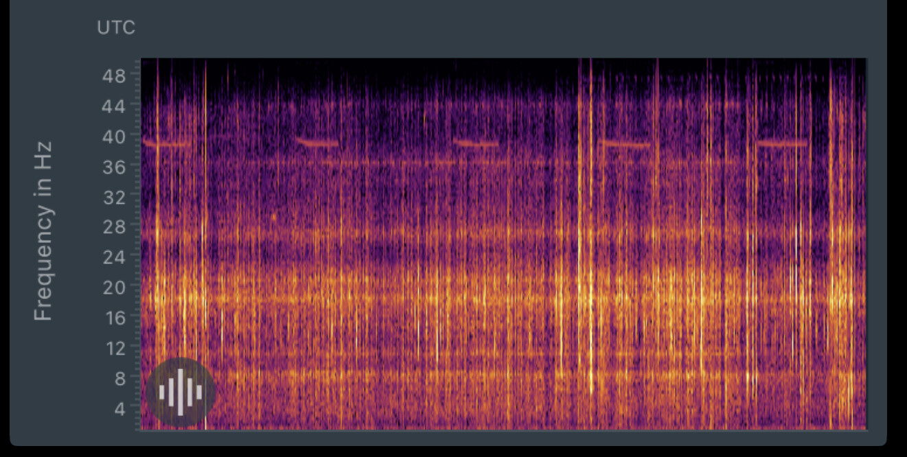

An excellent question. Here’s an example from mine but for HDF (infrasound) rather than EHZ (vertical geophone channel) - excuse the signal breakups**.
I guess the question becomes is it real or is the Shake generating it?
Given my 40Hz signal stops after a period of time and isn’t always there I’d say it probably is a genuine signal. Often though I see other different frequency straight line signals on the EHZ channel (or HDF channel) so wouldn’t go so far as to say there is anything special about 40Hz. As for what it could be my guess is it’s something human made for example a generator, extractor fan, compressor, etc. Is yours permanent, does it vary with the time of day, temperature, weather conditions for example wind, etc?
This page mentions “The pressure transducer used by the RBOOM and RS&BOOM is sensitive to RF at some frequencies” Raspberry Boom (RBOOM/ RS&BOOM) Infrasound Monitors and goes on to describe other sources though mainly for infrasound. I moved to an external WiFi dongle on a USB extension cable rather than use the built in WiFi in an attempt to eliminate any possible RF interference & improve WiFi signal until such time as I can plumb in Ethernet to prevent **signal dropout.
Please do keep us informed if you are able to determine the source as I have a number of signatures like this that equally pique my interest.

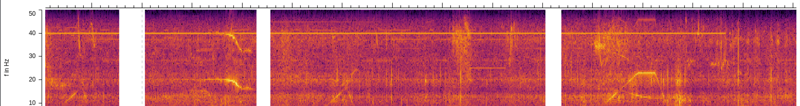

I’ve also recorded signals on my RS3D at around 40hz. You can see my posting a while ago. Mine are even more unusual, and consist of two frequencies, one around 41hz, the other about 43hz. They are co-incident and last exactly 5 minutes. They don’t occur at regular intervals but are frequent. They are stronger in the Horizontal axis than in the Z Axis. This is in Southern Ohio, and I’ve never been able to link them to any local activity.
This is interesting. I’ve just figured out how to display greater than the default time window in the app and here’s how the spectrogram looks over nine hours. It’s actually at 39Hz and seems to appear at regular intervals.
Gregor

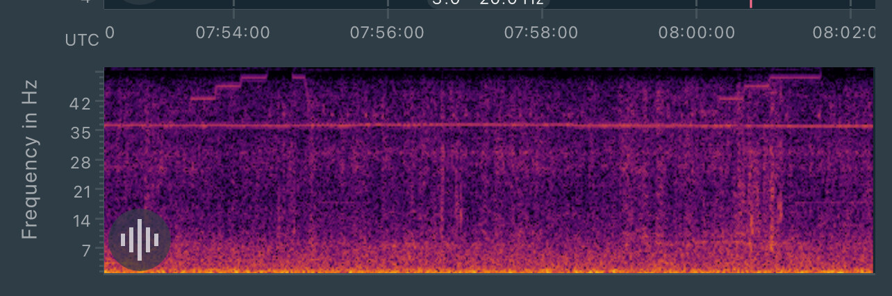

I also have a mysterious line at approx 36Hz that shows on my wired 4D but not the wired Boom directly adjacent to it. I think it’s related to my spa’s mains power. I’m wondering if it’s RF/induction from the spa’s power supply, heater or power cabling rather than vibration from the PSU transformer. Even when it’s asleep and not heating or pumping it still emits it. The staircase pattern is the spa doing it’s pumped cleaning cycle. My next step in the process of elimination is to kill the power to the spa and see if the line disappears.
