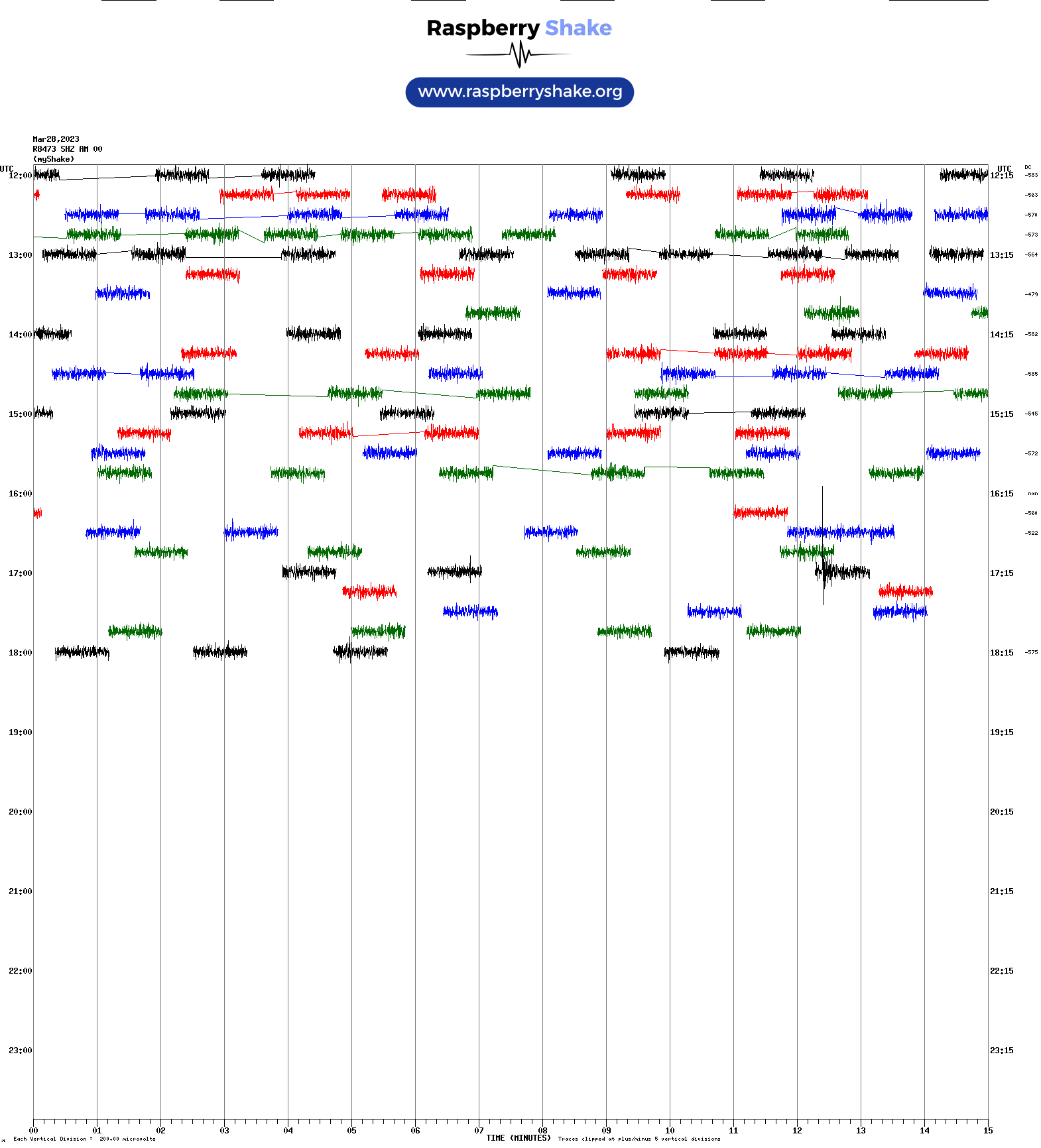

Hi whats the reason for the shake to record intermittently?
I change the sd-card … but still same issue every one in a while.
herewith a gif image and log file … i have no clue for the issue
RSH.R8473.2023-03-28T19 04 42.logs.tar (3.0 MB)

As you have already checked your microSD card for issues, and re-burned it, we can look for the cause somewhere else. From your logs, these lines can tell us more on the Shake’s situation:
2023 087 18:42:57>>	internal error: buffer overflow!  cannot process read data...
2023 087 18:42:57>>	buf: {'MA': 'RS-1.12','DF': '1.0','CN': 'SH3','TS': 0,'TSM': 0,'TQ': 45,'SI': 20000,'DS': ['FFFFFF32','FFFFFCF3','FFFFFC12','FFFFFC5B','FFFFFÄQE
2023 087 18:42:57>>	Yˆ”	[ ÁËQ†œFI ÉËQšBe”ÙšP
As you can see, there are errors mixed with some ‘gibberish’ that cannot be successfully interpreted. My first thought would be to check and see if the power supply is delivering a stable voltage between 5.0 and 5.2V and a current of at least 2.5A at all times, as a decrease in power could lead to data services interruption. If you have another Pi power supply that you know is in working condition, please try to exchange the current one with that, and see if the Shake now properly boots.
