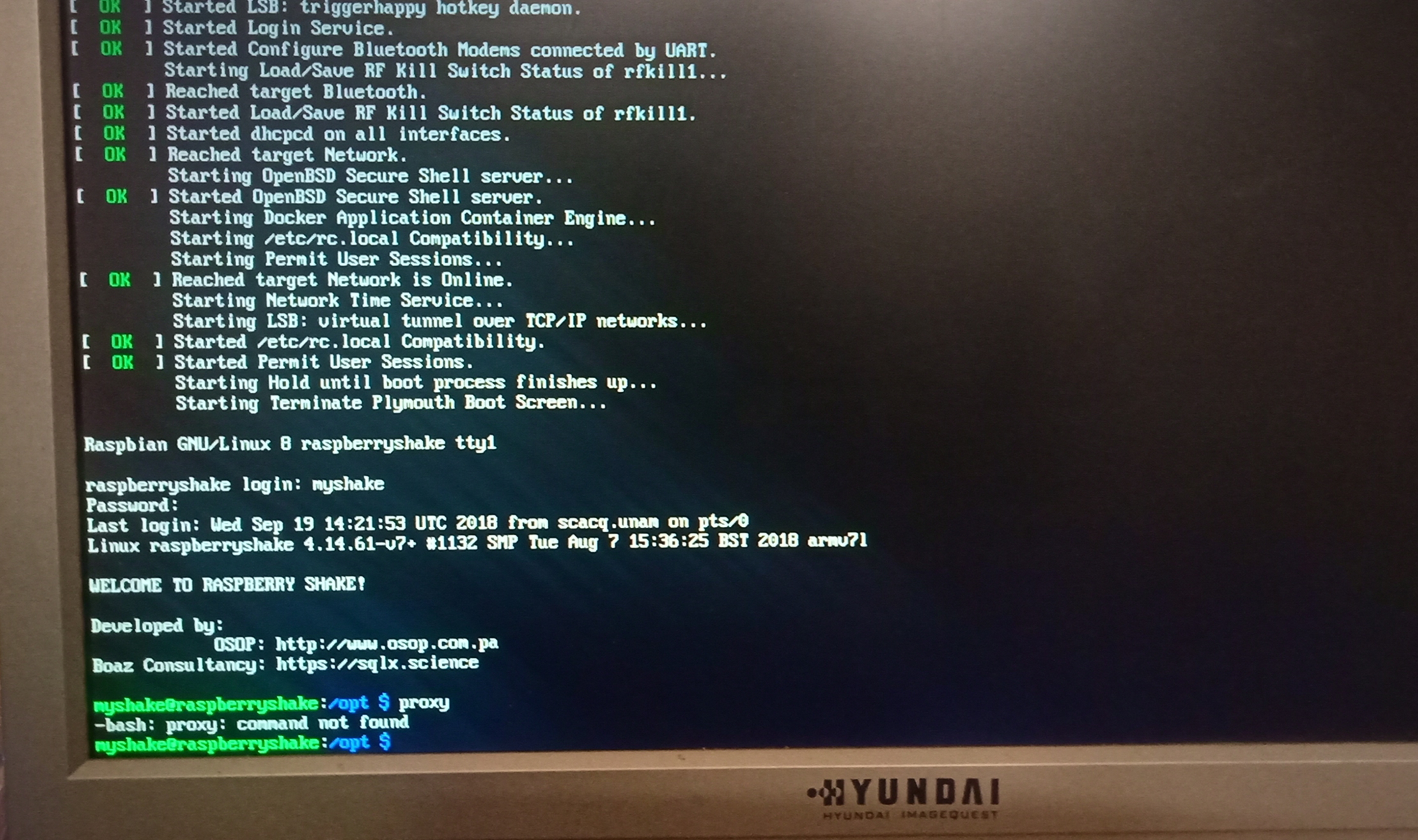

How can I add proxy in shake…I tried to make connection between Shake and desktop Monitor through HDMI but didn’t get any signal on Monitor.

This may be due to the fact that the Pi only starts its graphics suite if it senses an HDMI connection is present at startup. You may have better luck removing power from the Shake, plugging the HDMI in, then reapplying power.

Now I can access HDMI.
As I earlier told you I am using Proxy LAN so not able to connect it with “rs.local:5000”.
Is there any WI-FI system available to connect it with internet to access data?
And also please let me know…for reading siesmic or accelerometer data from shake is it necessary to connect it with internet? Or can be I read it directly on local server?
If not, Please let me know how can I set proxy in shake(because it is not GUI based)?

The following page might help in setting up a proxy, although I have not tried because I have no way to test it: https://www.raspberrypi.org/documentation/configuration/use-a-proxy.md

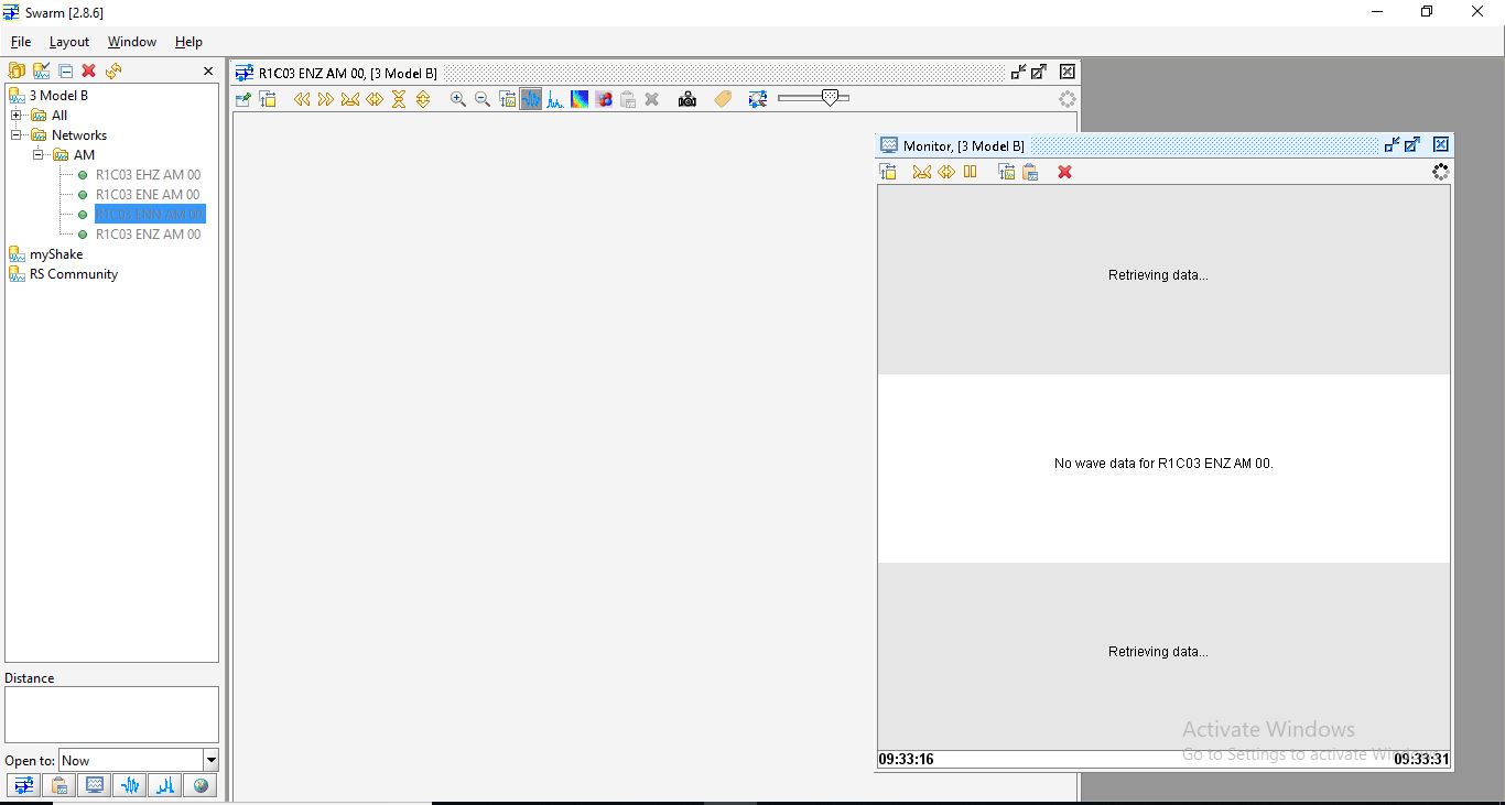

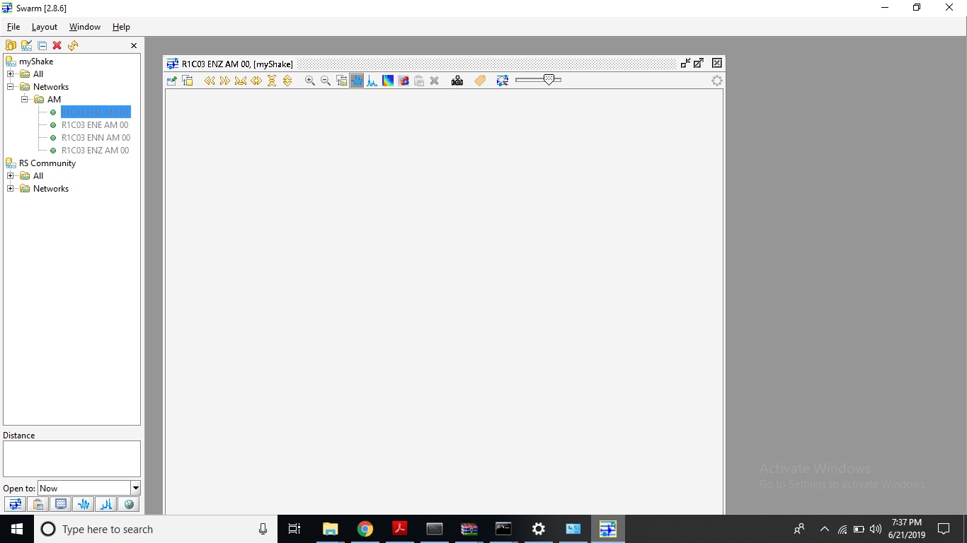

But in swarm[2.8.6] It is not showing any data/waveform. Why?
and I need real time values of accelerometer(all axis) and jeophone…how can I get them as my shake is not connected to internet?
Hi @UmeshPant, can you send a screenshot of the connection settings for the device myShake?
Sometimes SWARM prefers using the device’s IP rather than rs.local, so try that first.

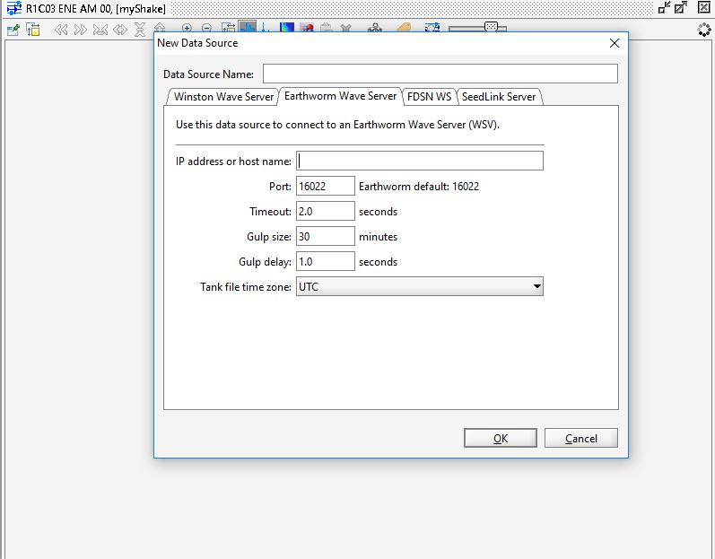

I didn’t find any option in swarm where I can put my static IP.
Attaching screenshot of swarm here.How can I proceed further…
Please help
On the Winston Wave Server tab:
For “IP Address or Host Name”, put the IP you find on the web interface (highlighted below).
For “Port,” use 16032 (not 16022)
“Timeout” and “Use Compression” remain the same
Then click OK.

Hi @UmeshPant, you aren’t seeing data because your Pi’s date is set back in 2018 (startup was at 2018-09-21 03:19:04 UTC in the logs). If you connect the Shake to the internet and let it contact its NTP servers, this problem should go away. Alternatively, if you don’t care about timing things accurately, you may be able to get away with running the following command which should at least make your data show up today in SWARM (from thread here):
sudo date -s "Mon Jun 24 00:00:00 UTC 2019"
(modify this to roughly reflect the UTC time when you run the command)
The Pi relies on an internet connection to periodically update its time, since it has no onboard timing chip. This means the clock may drift seconds per day without a connection. Read more about Shake-specific timing in the manual: https://manual.raspberryshake.org/ntp.html
And about the Pi’s clock drift here: https://www.raspberrypi.org/forums/viewtopic.php?t=211140

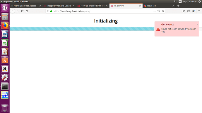

@iannesbitt
I have connected shake to internet but It is still show me this.
I am attaching log files also.
RSH.R1C03.2019-06-24T15_30_01.logs.tar (1.3 MB)
hello,
your log files indicate your unit is not successfully starting NTP, which means the timing will be incorrect, and until NTP is successfully running, the unit will not connect to the server.
re: eqview, this is working just fine for me. and, eqview really has nothing to do with your unit being connected to the data server or not.
please reboot your unit and confirm that your router is allowing traffic to pass through port 123, the port needed by NTP to do its job successfully.
cheers,
