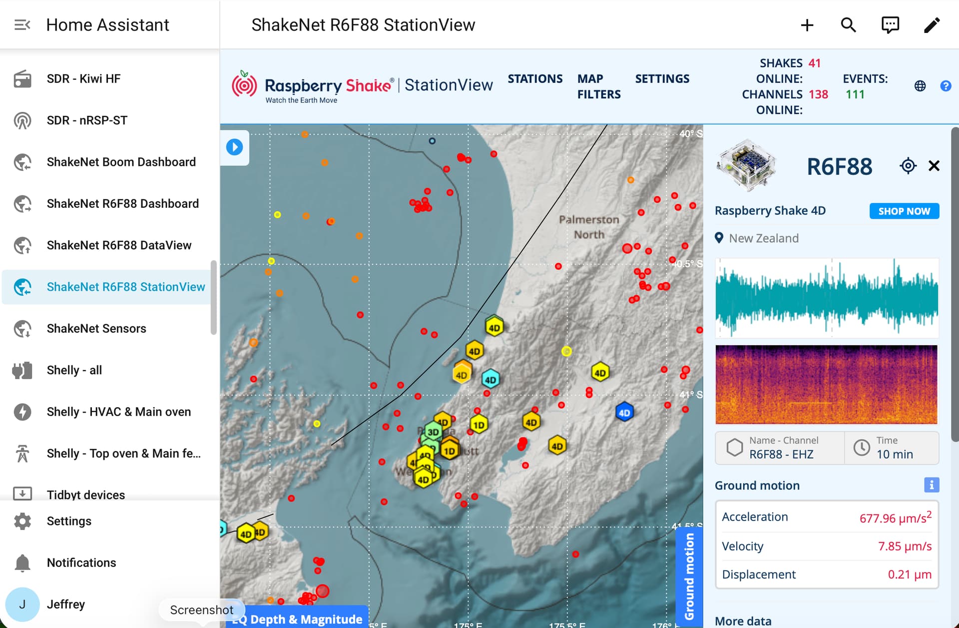

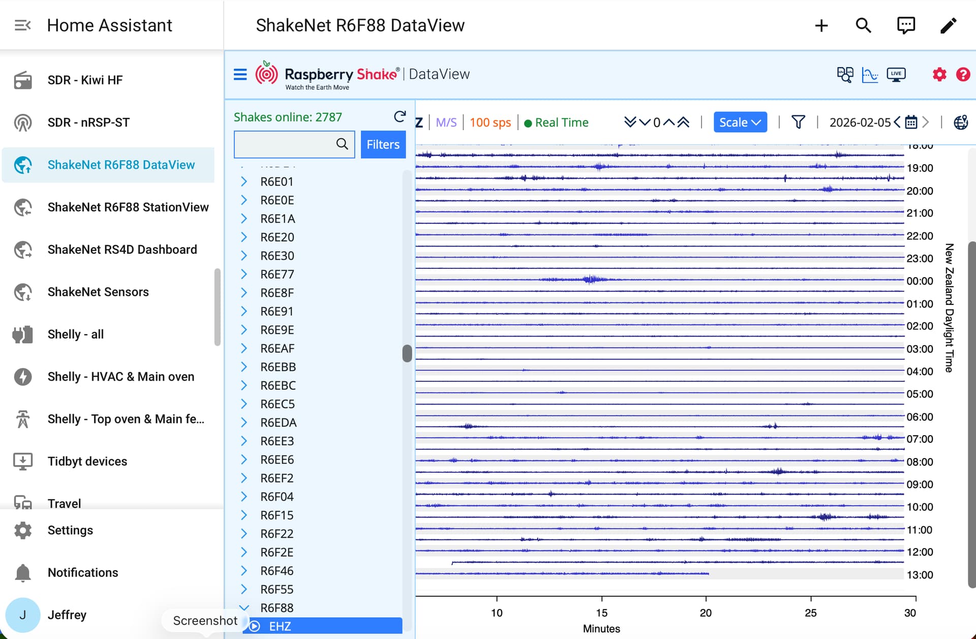

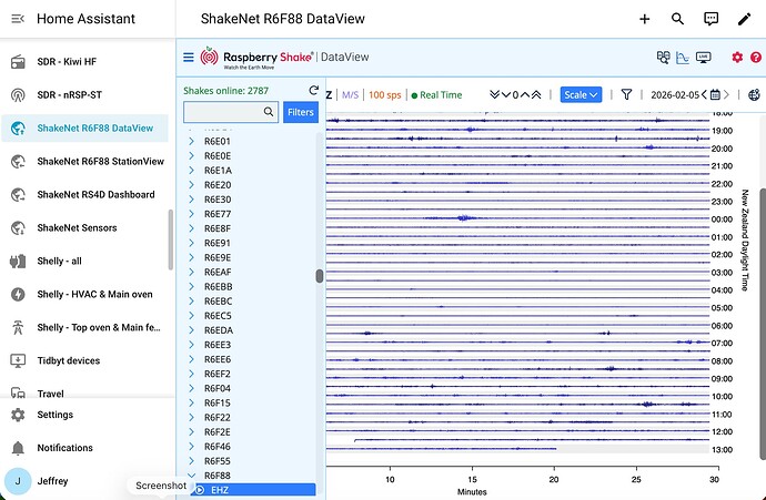

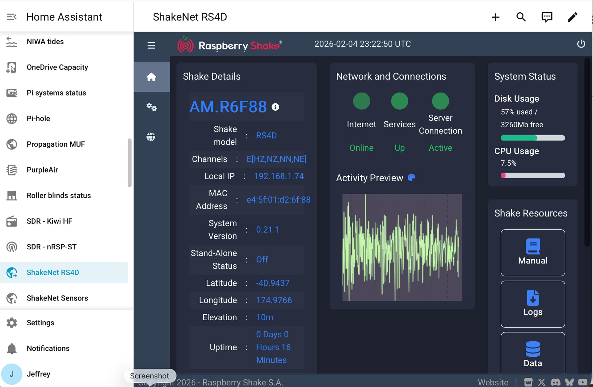

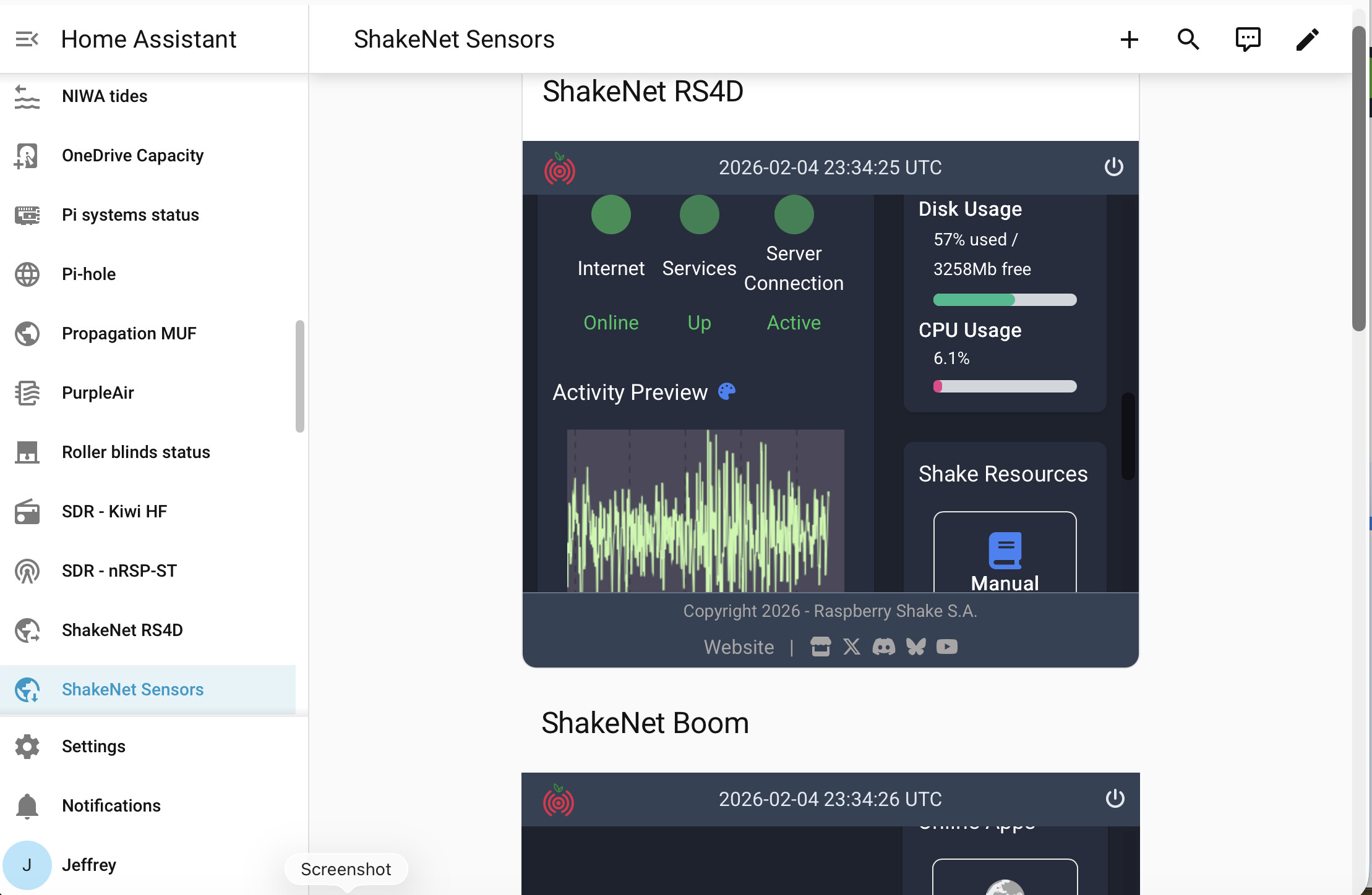

If you just want basic visibility from HA then a web card pointing to the shakenet will give this.
Here’s a few dashboards I’ve been playing with using local IP and DataView/StationView public URLs, noting that some URLs/web cards will only work when accessing HA locally. Their only utility of having them in HA is having a central view for quickly seeing if the sensors are up after a major network update. I’ve not looked into using the API and actually doing anything smarter and questionably useful like send a notification to my phone, flash the lights when a specific magnitude quake occurs.

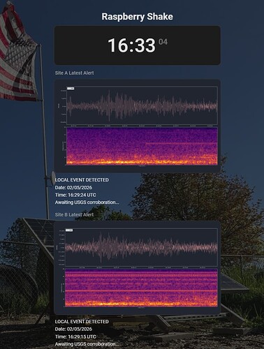

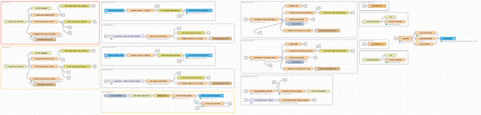

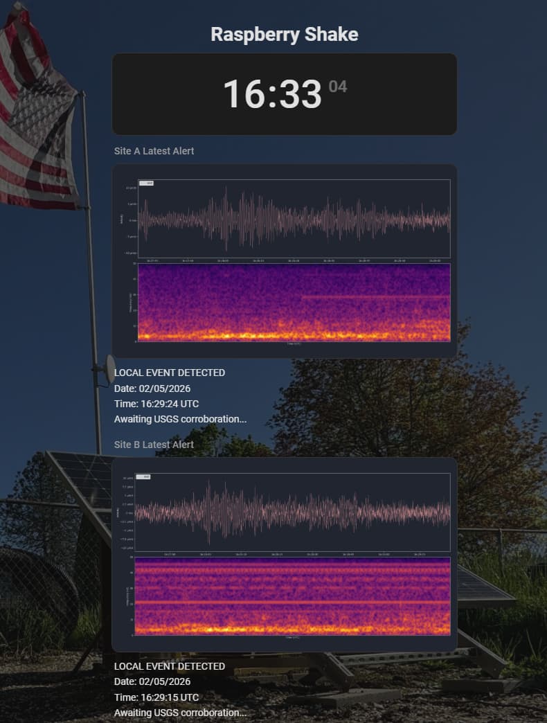

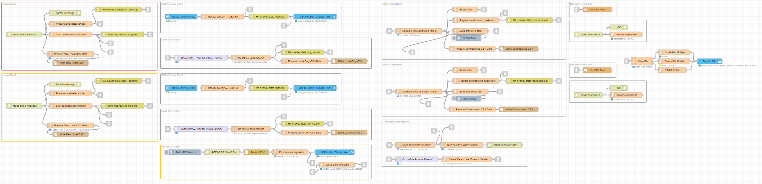

I’m using Home Assistant (with the Node-RED add-on) to take alerts generated by rsudp (from two shakes about a mile apart) and send mobile notifications, along with attempting to corroborate local alerts with USGS alerts.
I have a dashboard that shows the latest alerts (and other related stuff)
It’ll all eventually be fully documented on my site (adamslab.io)
