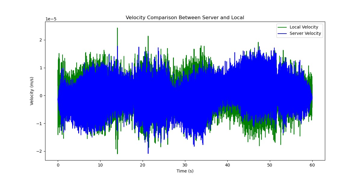

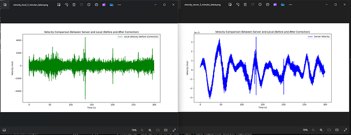

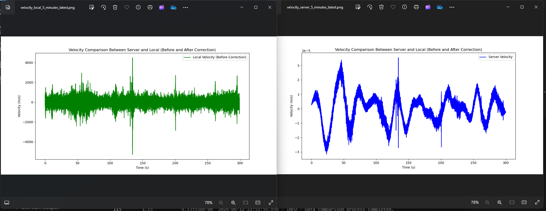

I generated two graphics with both the local and server data at the same period of time, so you can see it’s actually quite different.

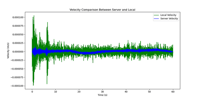

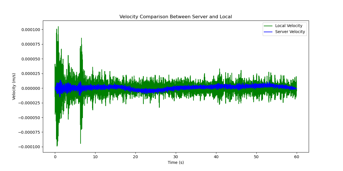

I attach here the new velocity results and code:

Thank you for sharing the code you are using. There are two things that may be behind what you are seeing:
  1. The first is that you are not removing the instrument response (as far as I can see) before operating on the recorded trace/stream. This can help you: Metadata - Instrument Response Files
  2. I think double detrending is not necessary, unless you require the second detrend operation for the study you are doing. The first one (st.detrend("demean")) should provide you with the correctly adjusted dataset.
Also, in the local trace, I see you are integrating to obtain velocity. When you remove the response, this operation will become redundant as ObsPy’s remove_response function will take care of that: obspy.core.trace.Trace.remove_response — ObsPy 1.4.1 documentation
These are some points you can focus on and see where to go after you check them.

Thanks a lot for your comments. In the second file I was actually removing the instrument response, but I did have the duplicated detrending so I removed it. I also removed the second integration.
With that, a few changes on the filtering and by adding a correction factor I obtained very similar results now, which is functional for me.
