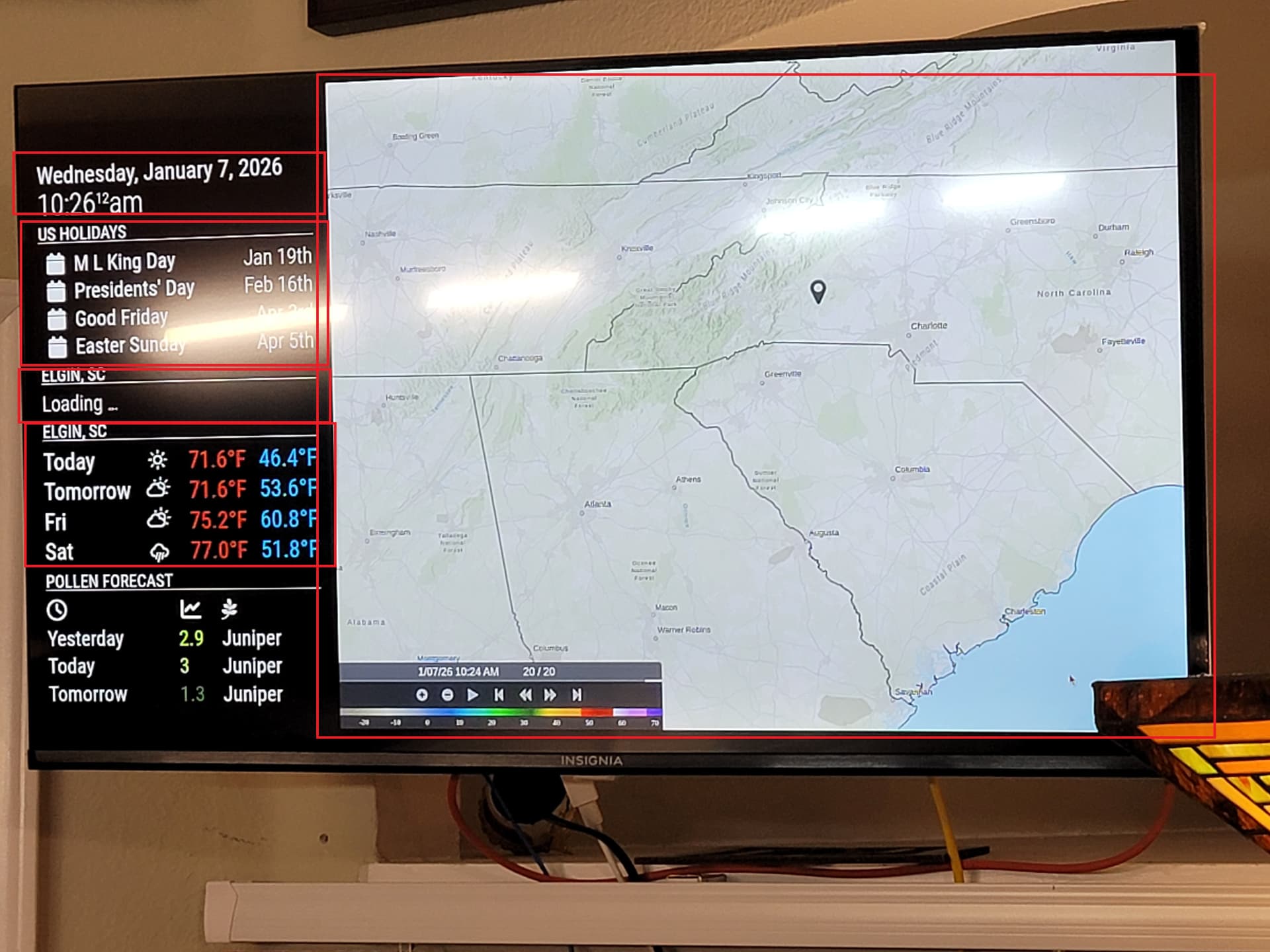

One of the modules is an an iFrame module which I have used in the previous magic mirrors to display a US National Weather Service live regional radar overlay. Here is a picture of that particular magic mirror. Each of the red boxes represents a discrete module. There are two weather modules, one configured for current the other is Forecast. The large module on the right side of display is the iframe with the radar image being displayed.
Behind that monitor is a Raspberry Pi 4 running the MM code (javascript) and there is a config.js file the individual builder like myself uses to customize the modules. I am building another MM right now and would like to have maybe Station View where the radar image is located.
