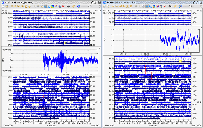

The network data for shake AM.R1D10 was showing periodic gaps and noise spikes. I wanted to check the data on the device but am having trouble with the terminal command to download it. Since then we have found a number of other shakes have the same problem, so the issue may not be local to the device.

Your station R1D10 has occasional impulsive spikes like these:
These are due to RF - there is a local source that produces a big RF signal at random times. Could be a cell phone receiving an SMS, for example.
By the way, does your Raspberry Shake have a lid on it?
Most of the data gaps in the examples you sent a screen shot of are problems server-side which have since been fixed (look at the data from the last 24 hours). But, this is cool:
The spikes on R167F are from the turning on and then off of a mechanical process (e.g., an air conditioner). This is best seen in spectrogram view (make sure it is configured with NyQuist at 50 Hz):

@ivor told me today that these were caused by a bug in the server that has been fixed as of last Thursday. Your local data is unlikely to have them, as we isolated the issue specifically to the server’s ingestion of data. If you notice any of these that occur after five days ago (the 26th of July) please let us know.
Ian
