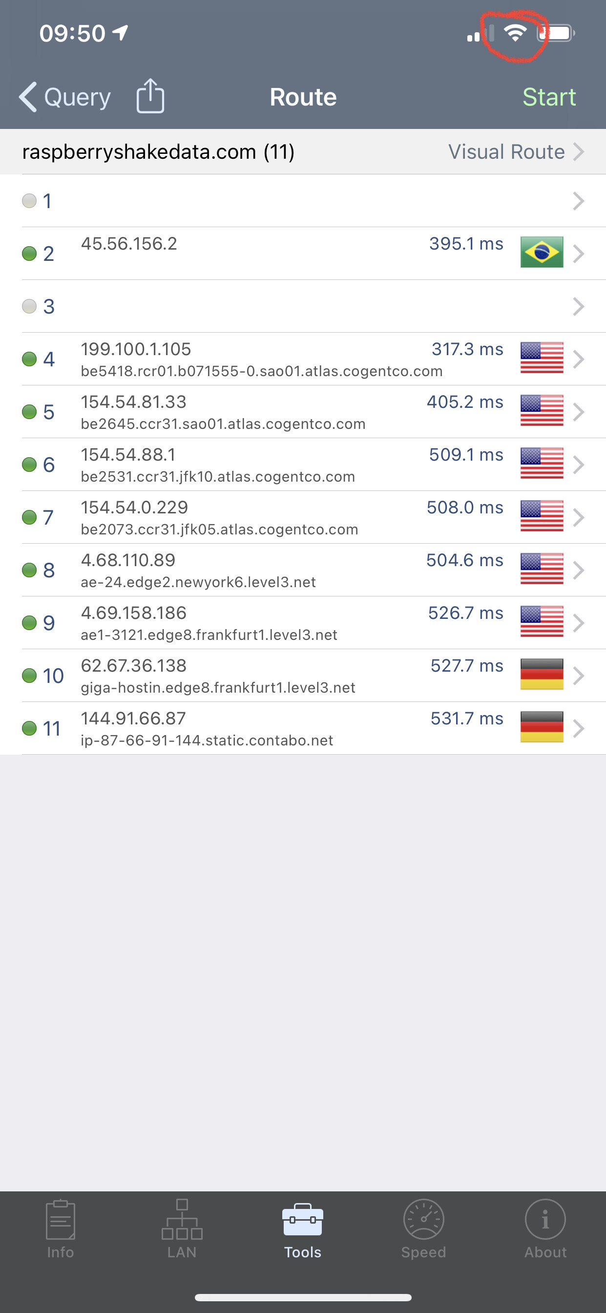

In that regard, I used the app “Net Analyser” on my iPhone to ping and trace route raspberryshakedata.com when connected to mobile data, and also my home Wi-Fi. Screen captures below, where it’s 4G for mobile and I’ve circled the wifi symbol when I was connected to Wi-Fi.
